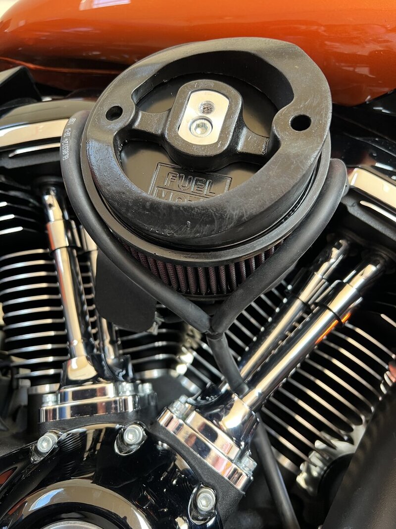

May not be your issue, but I had a similar squeal/galling noise I thought when letting off the throttle and also sitting idling on occasion. I had just put a cam, exhaust, and open style air cleaner with a factory cover adapter on and thought it was something related to the cam, lifters, new bearing, or chain guide. If I opened the throttle a bit, the noise would always go away though.
Decided to take the air cleaner off and noticed the throttle body was a bit oily and dirty with a hard black coked oil film. Sprayed it with some carb cleaner, pushed open the butterfly valve and sprayed some more inside, then used an old toothbrush to dissolve the black film. Sprayed some more carb cleaner, then wiped the body and edges of the butterfly valve off. Started it and the noise was gone.
So I read several comments on the problem and guys using catch cans and different ways to vent it so it wasn’t coating the throttle body with oil again.
Didn’t want to screw with a catch can, so decided to keep it simple and just ran a simple vent line with a “Y” and routed it down with the radiator overflow vent hose. If it drips a drop or two of oil on the garage floor, oh well…I’m honoring heritage!
