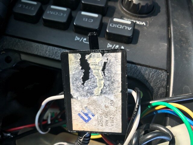

As I've posted on here recently that I've had an issue with my driver intercom so I decided to go looking. I thought the most obvious place was beneath the left hand storage box on the shelter. When I pulled the box out the first thing I say was this! Now I'm already stumped. Any help here, the label was damaged by tape when I removed it. This black box is connected inline with the bikes red terminal in that area. It also has a knob like piece on one end that rotates. You can see that knob pointing toward the CB button in the picture. I assume this is some sort of adjustment. The little insignia on the box meant nothing to me as I didn't recognize it. Thanks in Advance
Sorry ... I can't say I recognize it. Other then a couple of wires going to the accessory connector, where do the other wires go ???
Could it be some sort of speedo-healer ??? However, usually speedo-healers are found under the right pocket closer to the speed sensor wire.

Sorry Greg, I was hoping it was a pretty commonly used part and a general description would suffice.
I did trace a wire down that comes out of the end of the black box. It appears it goes to the small plug in on my GPS. The GPS on this bike does transmit through the Intercom system.
Interesting ... I've never knew there was such a thing. Chances are you found the aftermarket part that is probably causing your problem.
