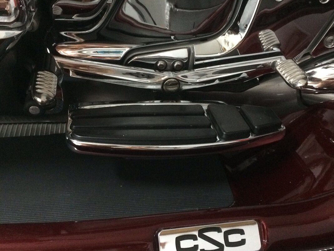

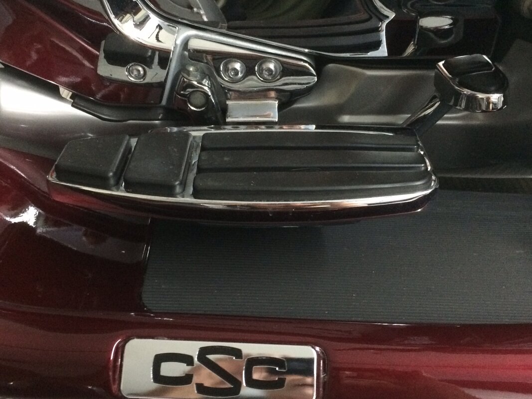

Here are a couple of pics of my current setup with Kury floorboards and heel/toe shifter.
This setup is on a 2009 Goldwing with a 2016 CSC conversion.
There is no interference from any of the parts. The rear brake pedal had to be adjusted a little higher to compensate for the increased pedal range needed for the rear brake conversation. This was a personal comfort issue only.
Hope this helps:)
