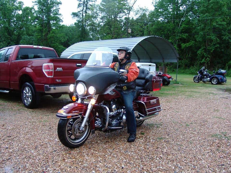

I have a 2003 Ultra Classic, now I'm almost 70, I find it harder to ride with the wife on board. I don't want to give up 2 wheels for solo now and then. So Outrigger Style Trikes is what I'm looking at. I'm leaning to Tow Pac InstaTrike. I only have 5K I want to spend on this. I'm redoing a 1957 Chevy truck and I'm getting a new four post car rack. So 5K or so is all I want to spend on the bike!
I will do all the work myself on the trike except for pin striping and paint. Is Tow Pac InstaTrike a good kit for me? I don't plan on long trips with the kit on maybe 100 miles at a time.
Are there any Tow Pac Insta Trike builds on a Harley Ultra here to look at?
Are there any body parts that make it look less "Training Wheel" from the back view?
