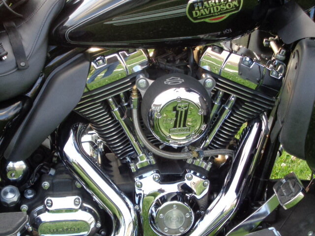

Here are a couple of photos of my Tri Glide with the 587-

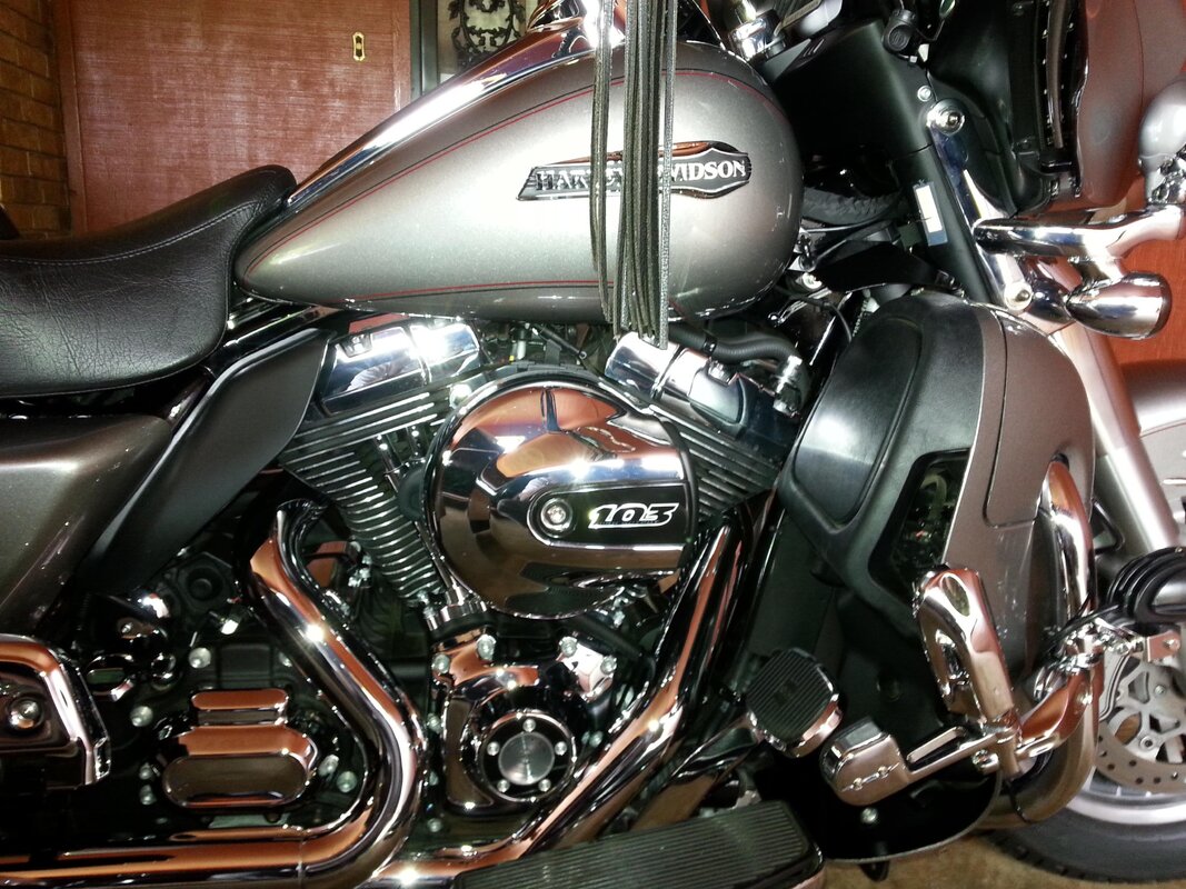

Here are a couple of photos of my TG's with the 606-

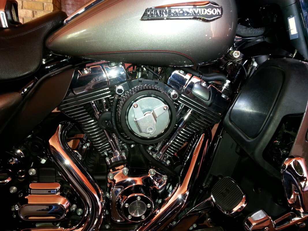

Here is a photo of an M8 with our Outlaw 606 air cleaner system with the stock cover.
Here is a photo of a Twin Cam with our Outlaw 606 air cleaner system with the stock cover.

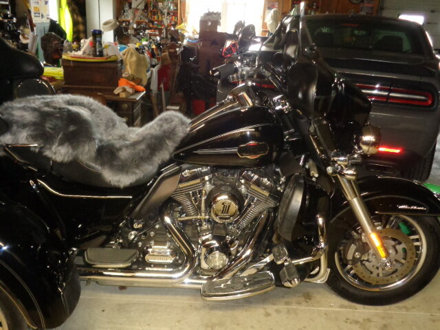

That is exactly what I did to my Boyesen X force intake made me nervous but I purchased the kit off Kevin. At first I ran the line out front not a good result it put junk all over the underside of the trike. I next ran it back with hose to hard line and down and out. :good: Stay Safe Stay Home. FredDSC00273.JPGDSC01480.JPG
Late but here's my 606 HiFlow Outlaw Setup
I have DK's 606 Air Cleaner and their Premium Catch Can with EBS Breather installed on my Twin Cam Engine. These are working well for me and maintenance of the Air Cleaner and Catch Can is extremely easy.
HiFlow 606 Air Cleaner w/Premium Catch Can EBS Breather System
K&N Rain Sock (minimize water reaching filter)
Stock Twin Cam Cover

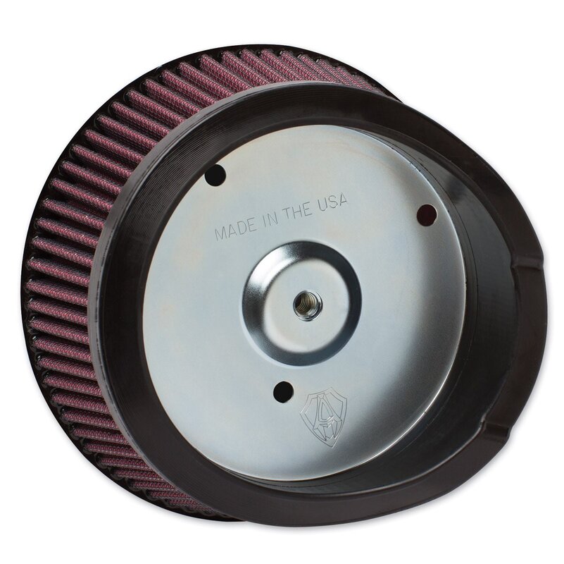

Upon more research, I found out it is the Arlen Ness Big Sucker air filter upgrade. It reuses half of the stock cover. Because of its design, I would have to purchase a new air filter to use a different custom cover.
Ok, you have the AN BS air cleaner...that is more than just a filter upgrade, that is an entirely new air cleaner set-up. You can run the stock cover, like you are, or you can run a whole bunch of different covers.
Check out this LINK. Any cover at that link that says it will fit a 606 or an 0800, will also fit your AN BS. I believe there are 10 or 11 choices there.
You may want to look at adding an External Breather System, it will make it perform better, and your engine will thank you. The EBS's at this LINK will fit the AN BS.
