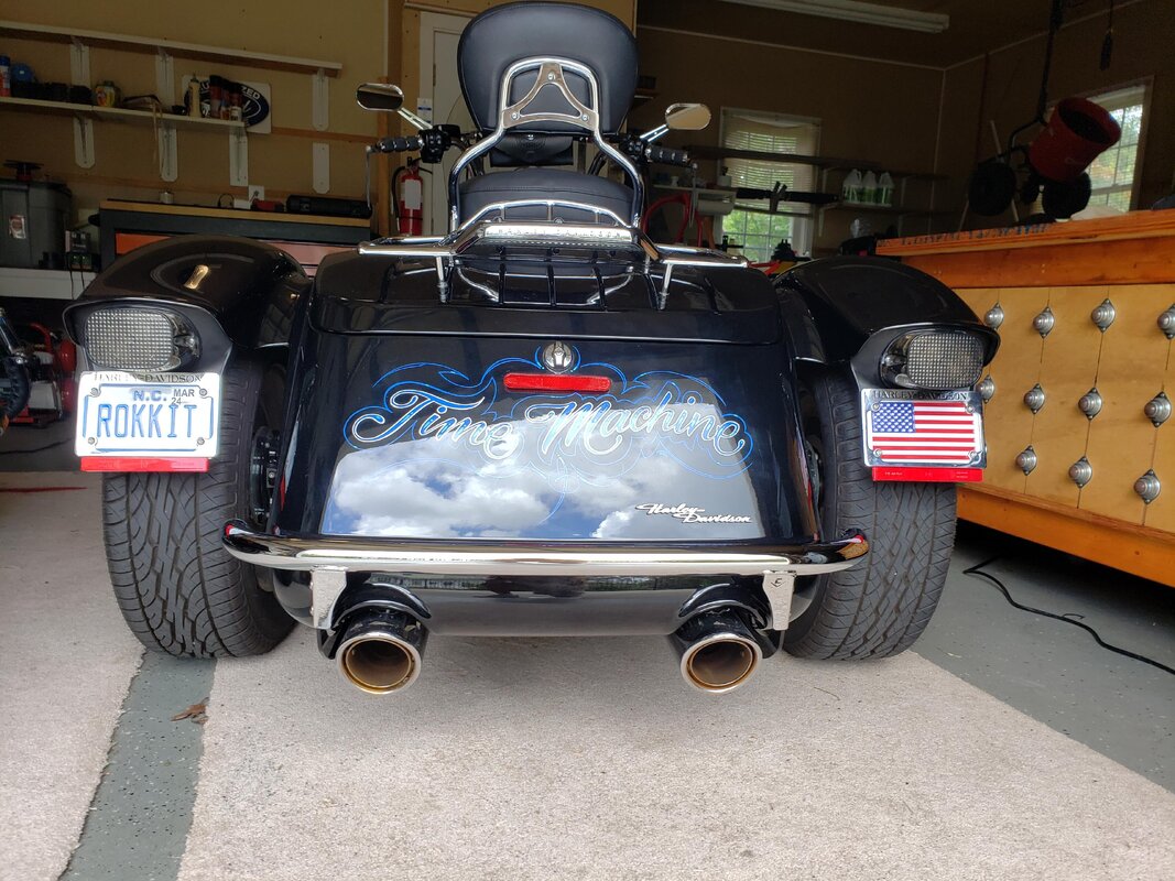

Ordered and received from a H.D. Dealer out of Massachesetts an additional Brake/Turn Signal/License Plate bracket for my 2019 Freewheeler..."Time Machine". I also found on Ebay the exact same H.D. License Plate Frame that was initially on my 2008 Anniversary Softail Custom, then on my 2015 SGS. Purchased an American Flag Motorcycle License Plate, again from Ebay plus 2 H.D. Reflectors from Beach House H.D. in Shallotte NC. Attached the reflectors using 3M Extreme Tape to a couple of flat aluminum pieces that are bolted via the License Plate bolts.
My desire was to balance out the rear appearance plus possibly adding an additional level of safety when the headlights of another vehicle approaches from behind. Already added Eagle Lights LED Strobe Brake/Turn/Running lights plus a Custom Dynamics Luggage Rack Run/Brake light. Maybe, just maybe, the combination of license plates and reflectors act as potential mudguards but certainly not a primary reason for the addition. Certain that there are those that disdain any and all reflectors....I am simply not one of those. But everyone is entitled to their own opinion.

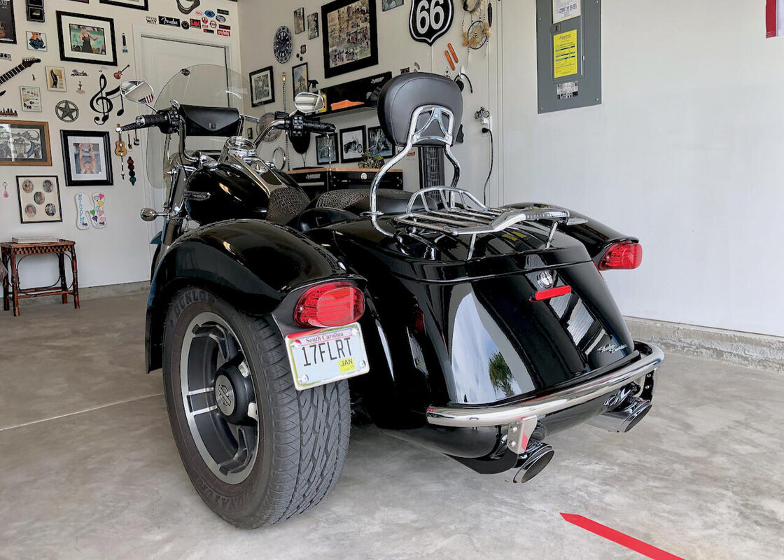

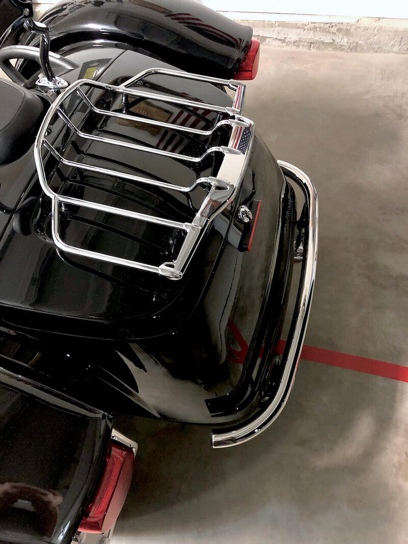

Hey SPFLRT … I see that you have the Cobra Rear Bumper on your FW. I’m wanting to order one this weekend for my 17 and was hoping that the install was doable at the house. Can’t find any vids … any input is always appreciated. Thanks
Cobra bumper
It is a very easy install. Torque wrench required for safety. Otherwise the instructions are extremely clear and easy to understand. Purchased mine through www.PartsGiant.com. My experience was that they are a very reliable supplier and have the best price I could find. Other than getting on the ground, arthritis is a bitch...getting up more difficult....takes maybe 30 minute to accomplish. I truly like the appearance and believe it provides great protection.

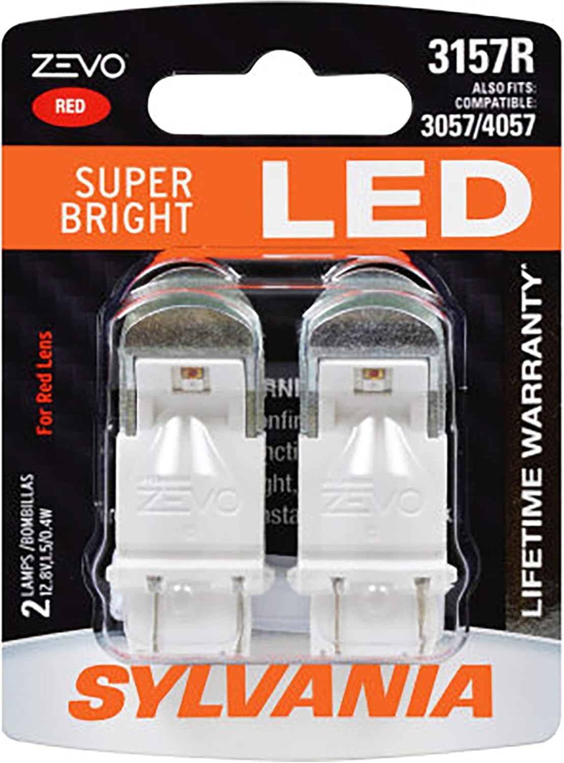

I Used an Amazon card I had to get 3157R Zevo Super bright rear bulbs for the rear of my Freewheeler
They are brighter than the older models and you don't have to worry about polarity with installing them
You will still have to run the 4 ways to sinc them to the BCM so they don't hyper flash
It did not set any codes on this 21 model, like it did on my 17 model
They carry a lifetime warrant also

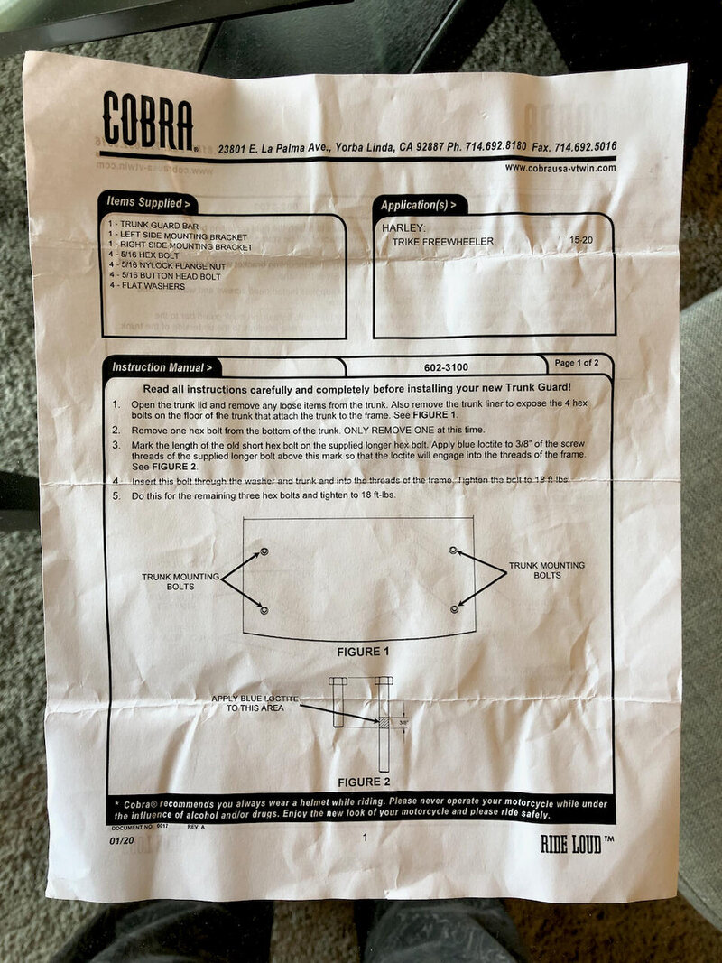

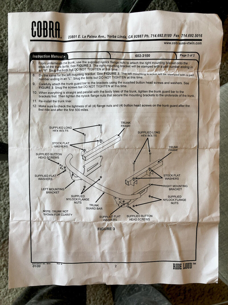

Jeff, are the instructions good? I am a big fan of lock washers and double nutting
I hate surprises on the road;)
The directions are good. Easy to follow and understand. I followed every step with OCD to insure that I didn't get ahead of myself. By far, the hardest part was getting on to the floor ... or maybe it was getting back up from the floor :) I did use all of the supplied hardware and everything fit correctly. Cobra recommends checking all fasteners after the 1st "new" ride and again at 500 miles.
