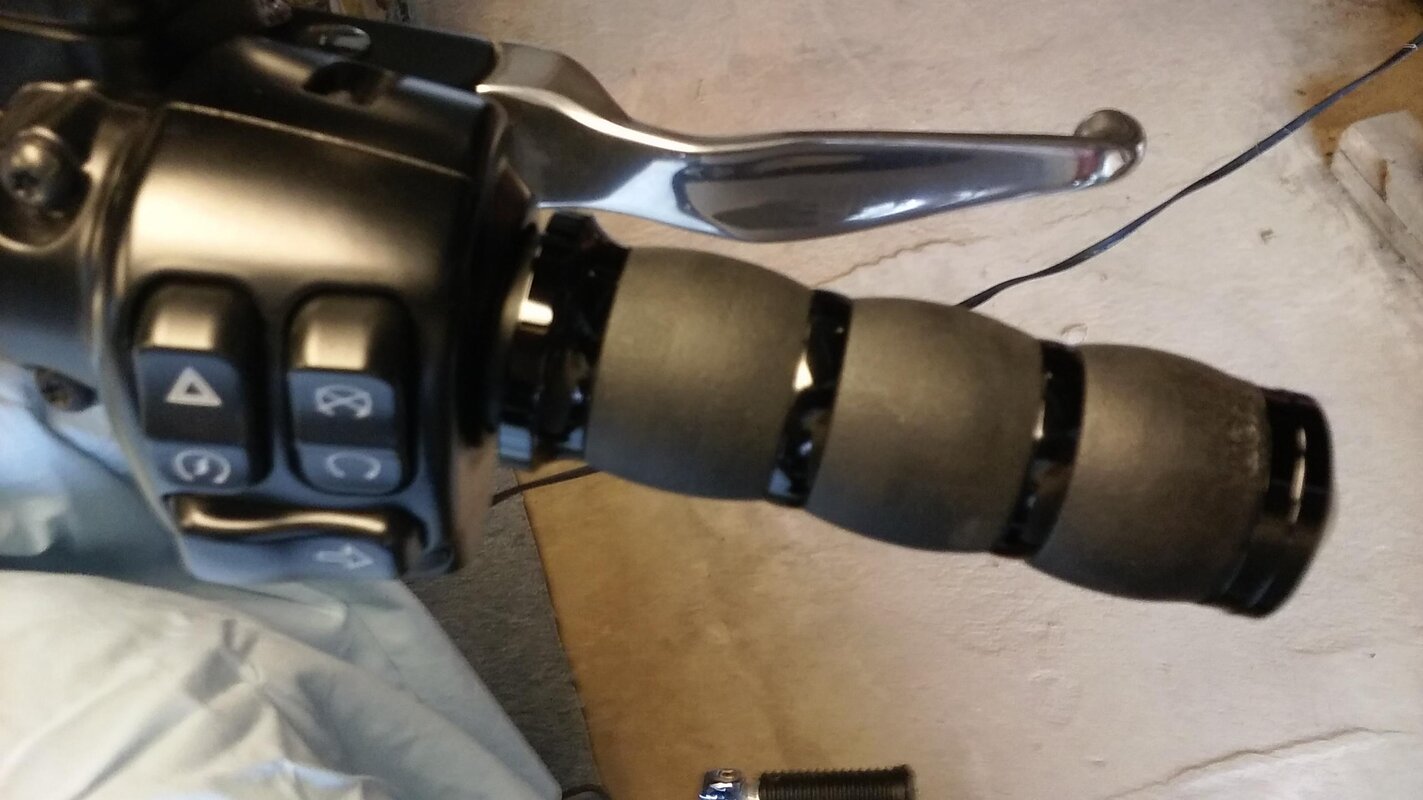

I installed the H-D Get-A-Grip hand grips on my wife's Freewheeler today. These babys are beautiful on her trike. Feel good in the hands too and definitely grippy.
The left side took a little work to get on though. The flange was too wide to fit inside the switch housing. My son did some dremel work to thin it out to the thickness of the original grip and it all went together.

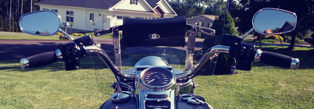

Factory 47 Malo bars. 14" Perfect height and I knew the width was right. Had them on my last bike.
I give up on loading pics. Some will. Some wont.

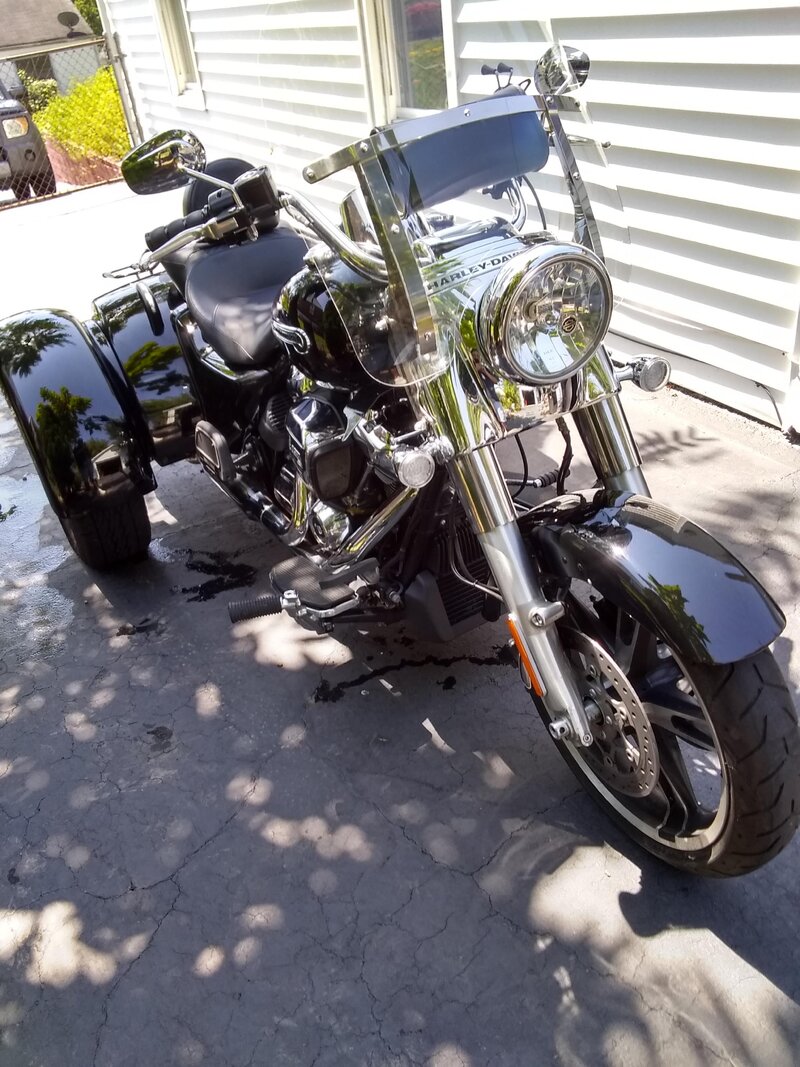

I need to start this by saying I hate to wash my trike/bike with soap/hose. I just don't like spraying it down, I always think I'm going to get something wet that shouldn't be.
I have had a quart bottle of S100 Cleaner for a while & could not bring myself to try it, but I decided to give it a go on my bug covered FW. Shake it and spray it everywhere on a cool, dry trike, and then, hose the hell out of it. I tested it well, spraying the wheels, in-between the engine & the oil cooler fins.
You then do a top to bottom final easy rinse. I must say it removed 99% of the bugs/grime & it says it protects the metal. I just did not think they would come off without scrubbing with the wash mitt.
Some of those bugs had ridden with me most of the 2,500 mile trip. After using my leaf blower to remove the excess water, I gave the paint a quick wipe down with Lucas Speed Wax. I will hit the paint again with HD can spray polish, but I'm pretty impressed with the S100.

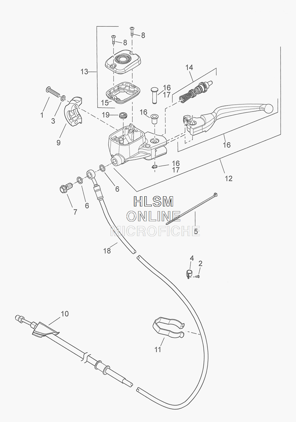

Very good read Michael,
I would add, I have taken the pin out of my clutch lever, cleaned the lever and inside the perch. After cleaning I lube the clevis pin with some light grease and reinstall it. Use care not to lose the snap ring, they can be a bugger:p
See # 17 in this pic
