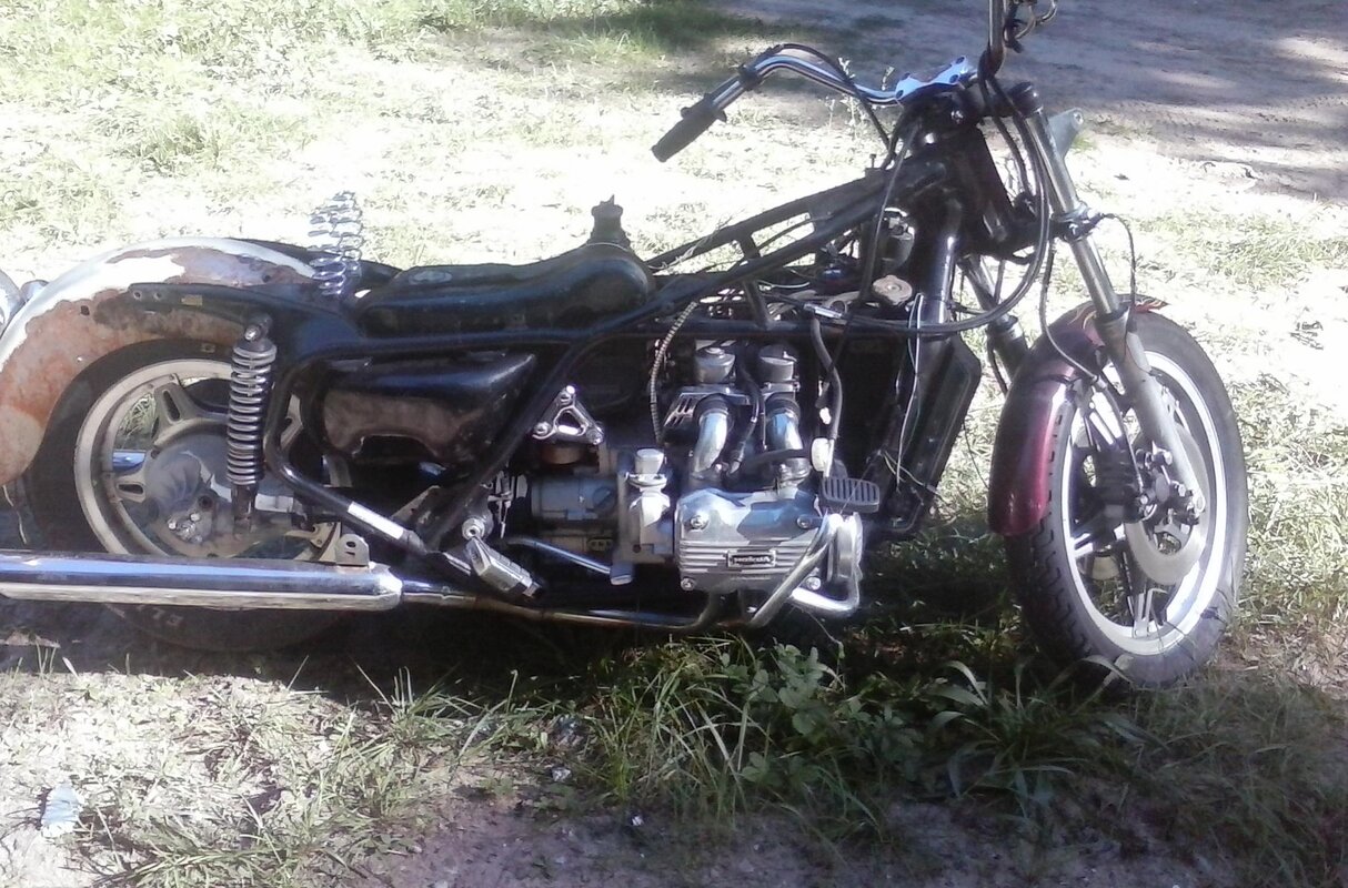

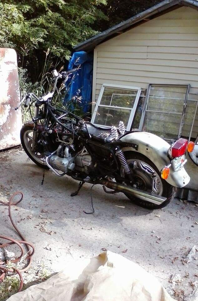

At the end of the month I will take possession of a 1977 Honda GL1000 that is going to (eventually) become my trike. I know the road is long and that there may or may not be a light at the end of the tunnel....
As I am a complete noob to building bikes (not a complete noob to working with tools and repairing machines/clutches/transmissions/etc...the "toys" I worked on professionally were typically much, much larger), I'm going to ask for EVERYONE'S input - good, bad or indifferent. Show me the fallacy in my logic and/or approach, show me the right way, and let's discuss it.
Here's a couple of pics of the basket case, I mean bike, that is to become my trike:

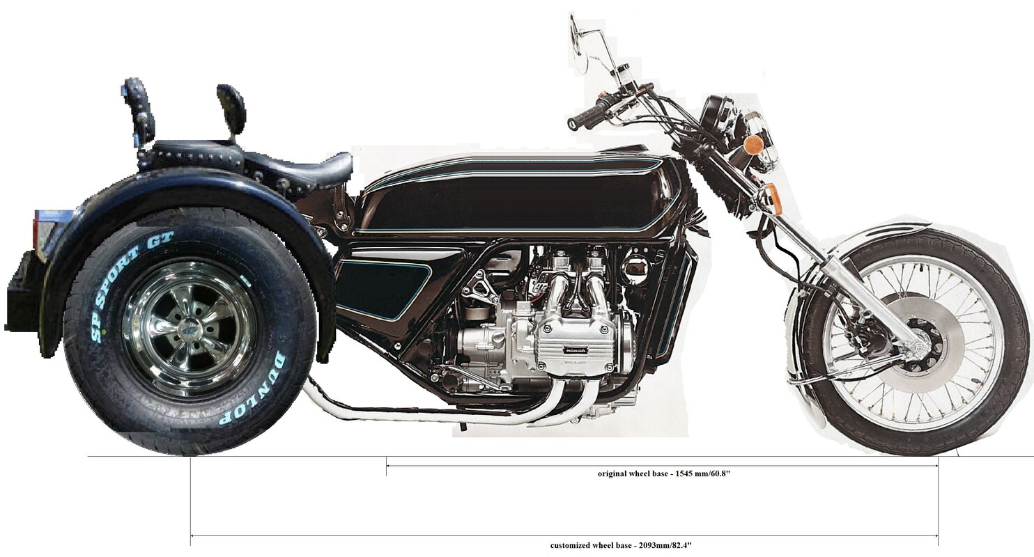

My plan is to put a Chevy GU6 rear end under it, modify the prop shaft, and add more suspension.
Best of luck to you, Thom, on your build. I'm sure you will like the results. Welcome to Trike Talk. If you run into problems there are many helpful people at your service.
That is my intention, FWH. The bike won't be delivered until the end of the month, and I've already been warned it's a complete basket case......looking at the pictures it sort of reminds me of an assembly line I had to rebuild after a tornado had played in the factory for a few minutes....it took a while to get everything up and running, but I still managed it.
Your arms are a lot longer than mine to reach the handlebars. Will be interesting to watch your build. Have fun.
Yeah, I didn't mock up the bars. They're going to be stretched back. I may be 6'4" and have 78" wing span, but even I couldn't reach those....guess it's back to the drawing board.

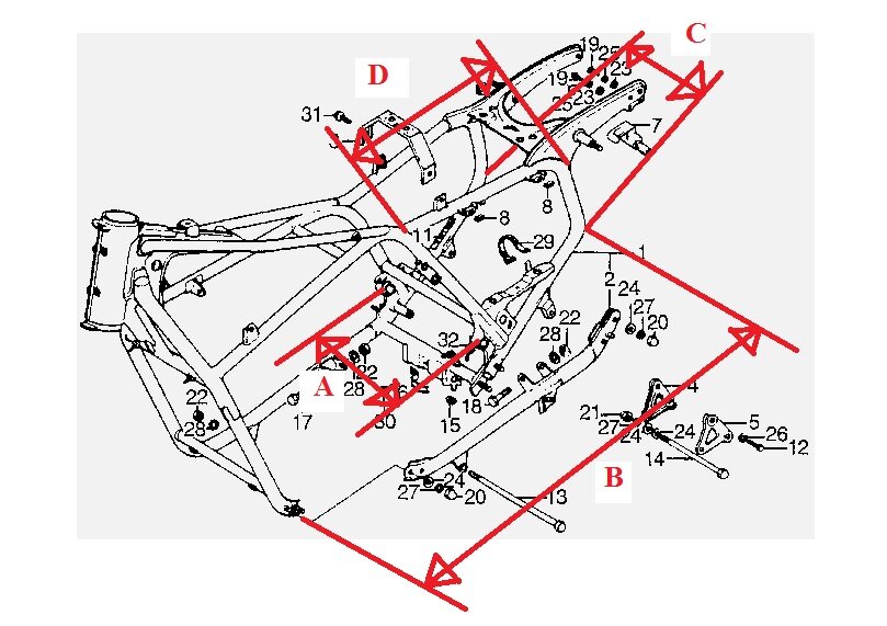

Need Some Help
Since I have to wait until the end of the month before I can get my hands on my donor bike, I've been trying to do some design work instead...problem is, I can't find any measurements anywhere!
Does anyone know these measurements (outside to outside) or would anyone be willing to take these measurements for me and let me know what they are? (also need to know tube diameter at the point of measure, please)
oh...I need them for a '77 GL1000
