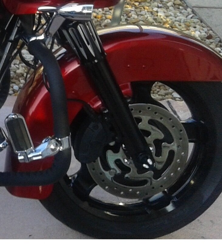

This is starting to get difficult. Any idea where I can get a aluminum wheel like the one I'm looking for??
attachment.php
attachment.php
I bet we can find one you like,Dave. Just keep in mind that the wheel you need will be a high positive offset piece so it will not have a lot of "dish". The hardest part will be deciding which wheel you like the best as there are literally hundreds of wheels available in a 4x100mm.
