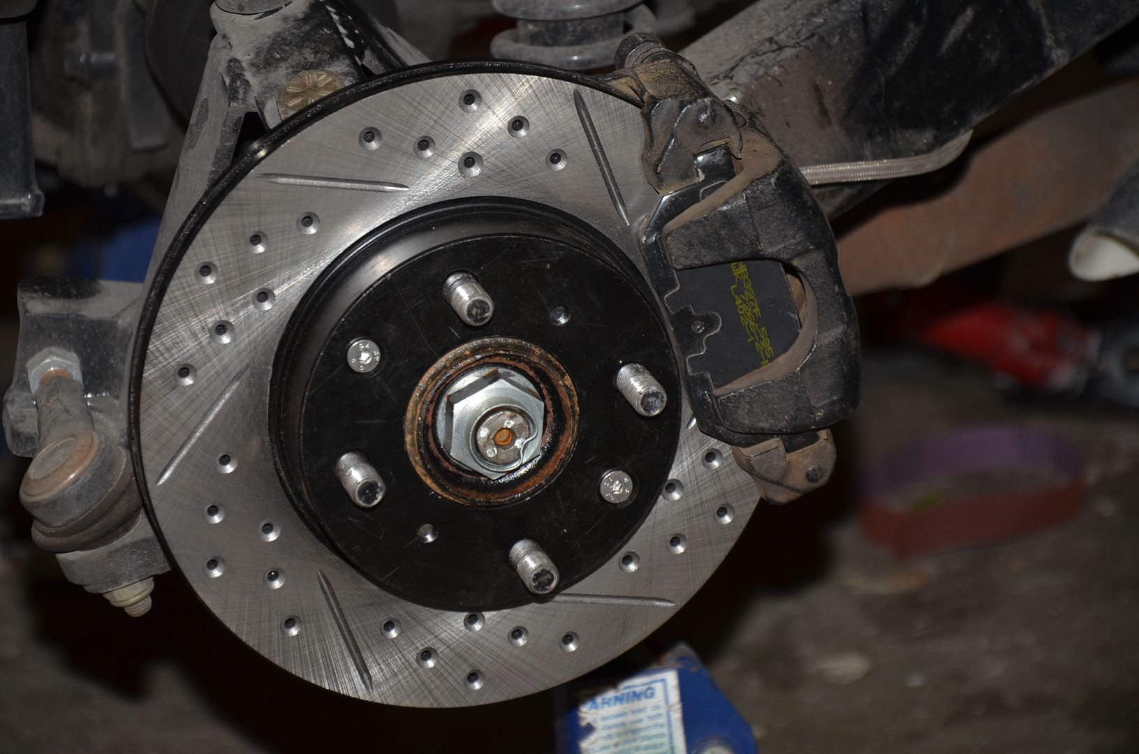

My Hannagen gl1500 trike rear brake performance is not as good as I expected it should be. So I thought I would try to improve the rear brake performance by replacing the rotor and pads with performance style components. These are Rotors from R1 (drilled and slotted) and Pads from Hawk (HPS series). The drilling and slots will not give better braking performance on the street but the rotors are made from 3500 series casting whitch my give better friction performance for the HPS hawk pads. We will see as soon as I get it back on the road.

re; the rotors,,, dont forget -- holes and slots ,,,, less contact area,, i would not use both,, in fact im surprised you need them
You are right I do not need them at all I just did it for fun and the looks. But After looking hard at this brake system I think I may have air in the system so I will remove the possible air and see if the peddle feels better. The hauk HPS pads are suppose to create up to 40% better friction.

<div class="message">My Hannagen gl1500 trike rear brake performance is not as good as I expected it should be. So I thought I would try to improve the rear brake performance by replacing the rotor and pads with performance style components. These are Rotors from R1 (drilled and slotted) and Pads from Hawk (HPS series). The drilling and slots will not give better braking performance on the street but the rotors are made from 3500 series casting whitch my give better friction performance for the HPS hawk pads. We will see as soon as I get it back on the road.<br />
<br />
<img src="http://img.photobucket.com/albums/v141/onevw/bike/DSC_1785.jpg" border="0" alt="" /></div>

P.S. The totally insignficant loss of any rotor surface that the addition of the slots make, will more than be made up for in wet weather by providing an additional means to shed water and keep the <span class="highlight">brake</span> pads from hydroplaning on the surface of the wet rotors.<br /><br />

OK We just got back from a day trip to Denver on the trike. The brakes are now performing much better. The brake stopping power provided by the new rotors and pads is getting beter all the time now I can easily bring the loaded trike to proper stop from hwy speeds with average peddle pressure and I do not need to add any front braking to do so. I am happy with this upgrade and can recommend these to anyone.
