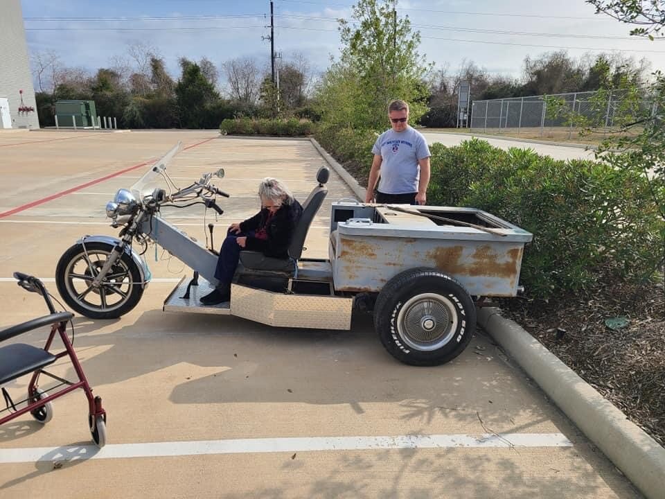

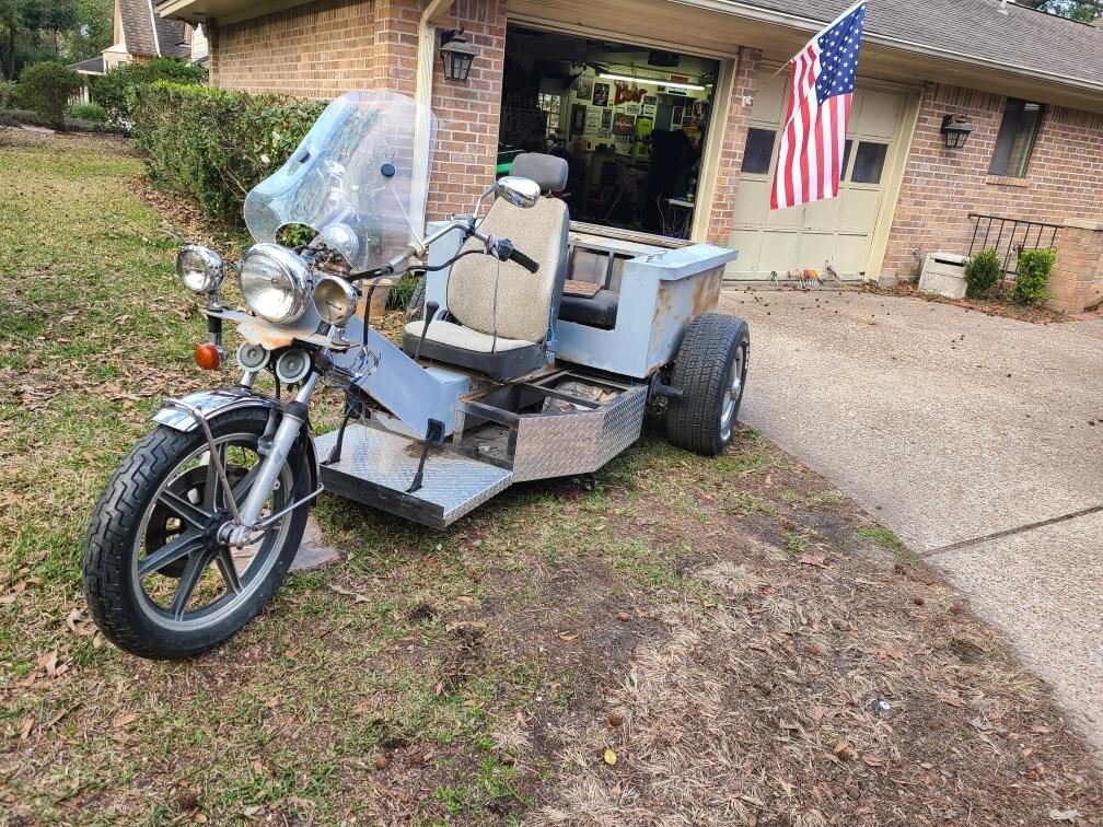

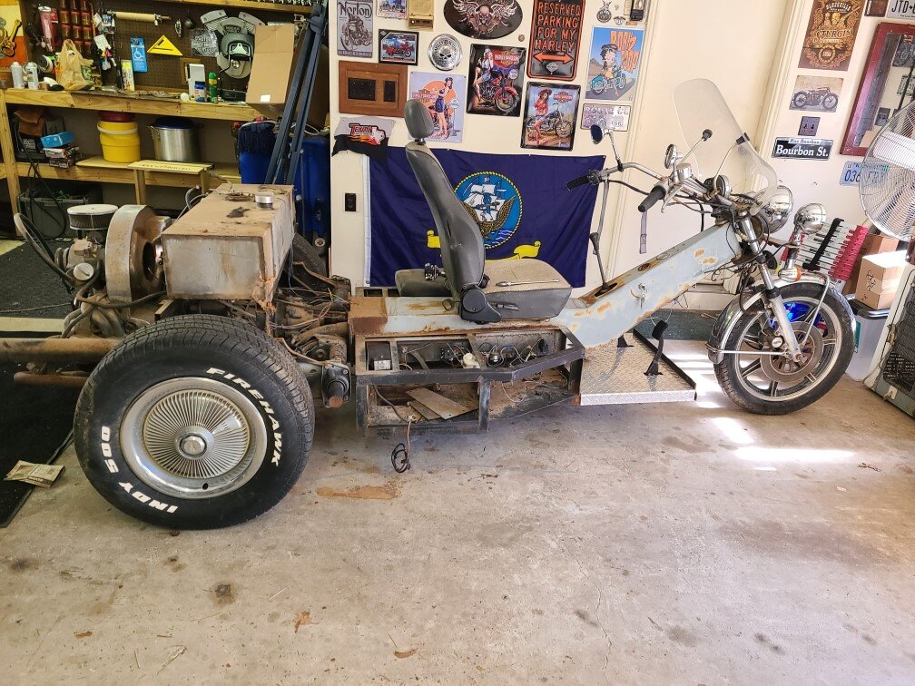

My husband has inherited a VW Trike that was built from the ground up by his late father. So now we have a project that neither of us have much knowledge on and can use a ton of help.

So far we have found out that we have a 1971-72 1600cc DP Super Beetle. The trike has sat for at least a year so now the work begins on replacing/upgrading parts. While we are obviously always going to find the best deals possible I also want to ensure that this rebuild is done to the highest standards as it will never leave the family and will be passed down.

pictures before you start and during disassembly take lots of pictures for yourself to reassemble by. I can tell from the garage that you are not rookies but if this is new to you pictures will be helpful and you like to share or include a picture when asking a question. looks like a fun project my Dad would love to help out if yawl were closer, he use to be big into VW.
