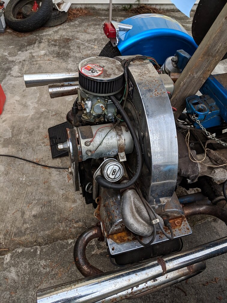

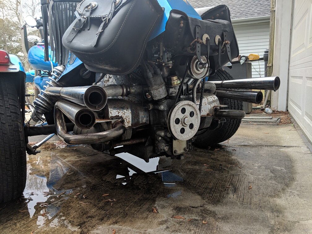

I just received a 2002 Nova trike that has been sitting for a while. Looking for some assistance.
1. It was a crate motor and trans in 2002. Need to find the information for an oil change.
2. Its an all medal body and the gas struts are gone to hold it open. Need a lead on these.
3. I need an electrical diagram for the motor. Never worked on the VW before. I do know its 12V.

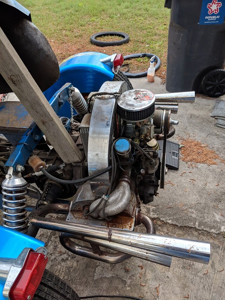

The pitted chrome stuff, either go as rechrome $$$ , or scotchbrite them clean as possible and rattle can them with Rustoleum primer/paint. Just recommendations depending how much you want to get involved with the restoration. Good luck 👍
That is a nice looking Trike, not sure of the engine, but one would do a lot of general tune up and replacement of worn parts first.
The dog house oil cooler on the front side of the fan shroud, if I am right it was later in the 70's, 74 I think it came out, an idea of the year for now, but I would keep that fan shroud and cooler on the engine, just make sure everything else is working to keep the engine cool.
I sprayed the rusted area with WD40, let it set a bit, and used steel wool and worked it off, but it is almost impossible to get back that original chrome shine, but it looks better.

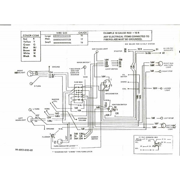

There is a vw wiring diagram over in tech tech.
If the specific year for generator and regulator combination was known we could narrow it down a bit.

The trike looks like it has great potential, after a good & thorough steam clean/pressure washing and good old fashioned elbow grease. It appears to be intact and not missing anything that might keep it from running, which is a major bonus in your favor.
If the trike was built new in 02, the mileage was probably started at 0 on the odometer to correspond with the fresh "crate" engine & trans. That it only shows under 5,200 miles now is good in that its barely broken in!
As far as the engine chrome goes, most is hidden by the bodywork, so scuffing it and repainting it as Frank suggested might be the easiest most cost effective "fix" over replacing all of it depending on what your long term plans are for it.

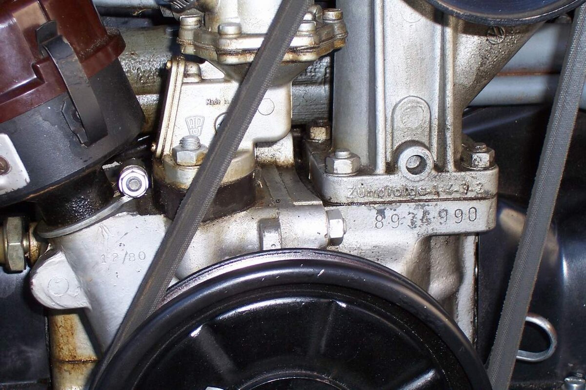

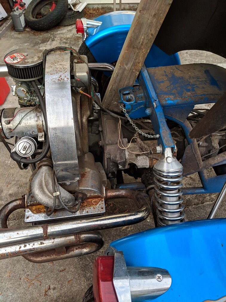

From this number under the generator stand you can look up what the engine case was originally.
That don't mean that is what it is anymore unless you have documented proof it has not been repaired or rebuilt in the last 50 years.

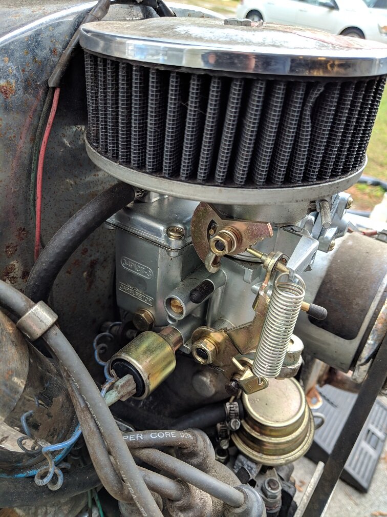

It looks like the carb and fuel pump have been replaced recently. They are not as corroded and aged looking as the rest.
All the chrome tin is aftermarket.
The distributor is a Bosch 009 or a copy of one.
Make sure the fuel pump diaphragm is ok. It could easily be what is putting gas into the oil.
The trans is a swing axle...that put it pre 1968.
Unless it was rebuilt/combined with other year parts.
The engine is a dual port....that puts it after 1971.
Alternators came out mid 73....yours is a generator.
That puts it between 71 and mid 73.
At least the original base engine.....probably rebuilt using a mix of parts.

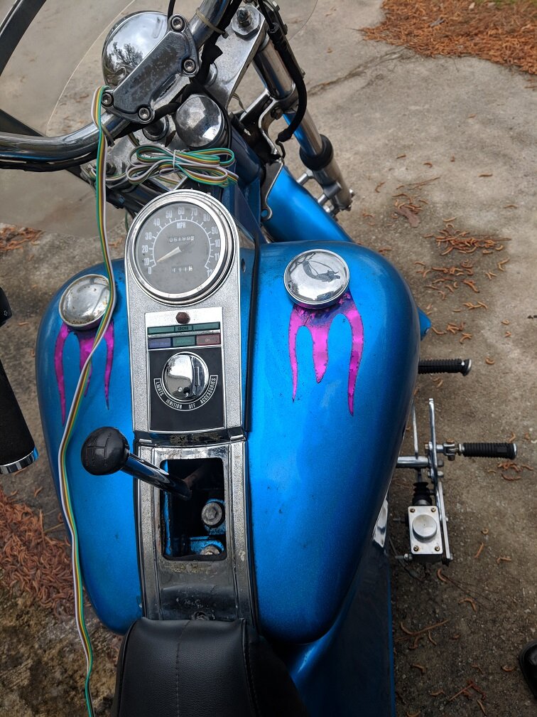

Got the oil changed and put a small amount of gas in it from a spare tank. She started right up. Now on to making it easier for whoever buys it. The fuses are fuse-able links under the tank going to change that to a fuse box in the battery compartment. The turn signals don't work yet but i do have power to the running lights. Someone did a 5 to 4 wire converter to power the lights. Now i just have to figure out how to wire the turn signal switches to the relay. I did find that the front brake switch and kill switch wires were cut and non operational.

No real wiring diagram for most Trikes, but some did get put together with one, but very few.
If you are taking it on, means you have some knowledgeable experience with it, with time it can be figured out.
Light bulbs not working are sometimes just the simple ground connection not being good, also could be a dirty socket, or like mine where lose, a squeeze with the fingers made it right.

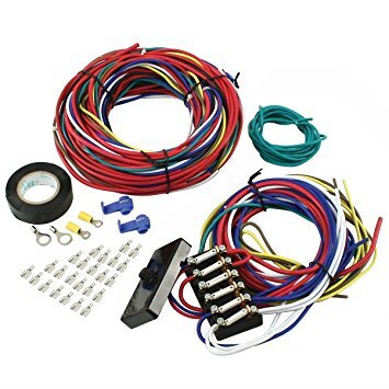

If you are handy with electrical it won't make much difference.......but......a lot of folks start with a dune buggy harness. Buggies are typically shorter and have the basics like a trike. It would put the fuse panel near the front and if you use the motorcycle handlebar switches it would be up to you to figure out.
It is still a large chore either way. In my opinion it dont help a huge amount other than......having that long front to back bundle of different colors of wire. That part is much better to work with than everything being one color off the big spool of wire.
DeathBySnuSnu, lucky for me i'm good with electrical. I found the main wire from the starter to the ign switch was a 20ga wire. I have decided to go with a 10ga from the battery to a circuit breaker into a relay that will be triggered by the ign switch. I'm also laying out a wiring diagram for the new owner. It amazes me the shortcuts some people will take.

Wiring is complete. Headlight, running lights, turn signals, and brake lights all work. Dash indicators are all working. She fires up with little effort. Now to bleed the brakes and put the fenders back on.
