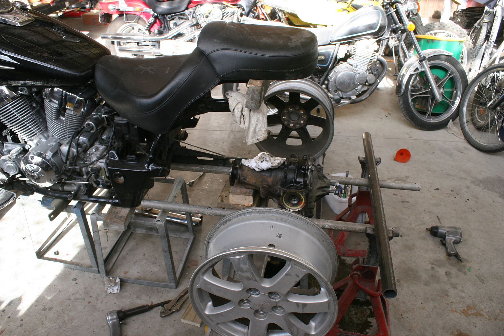

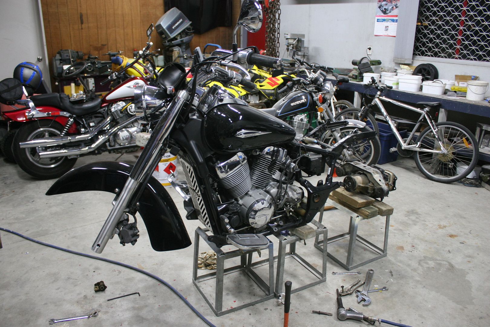

I have finally made a start to this, I have had bike issues with my main ride and the dirt bikes so this has been put on hold a few times
I am building it on the 750 for my wife to learn the art of riding a trike, She has not used a hand clutch before so this could be interesting.... Better to start with less power I guess? It also gave me the perfect excuse to upgrade my bike :p
I have a Mortons rake kit (only one I could find for the Aero that had good reviews) for the front end, I am going to build my own rear suspension (IRS) and have Toyota Caldina 4x4 hubs, diffs brakes and bits as a base, thinking I might use and electric clutch and light winch motor for a slower reverse and a starter reverse on drive shaft cog will likely be too fast for the wife to handle?

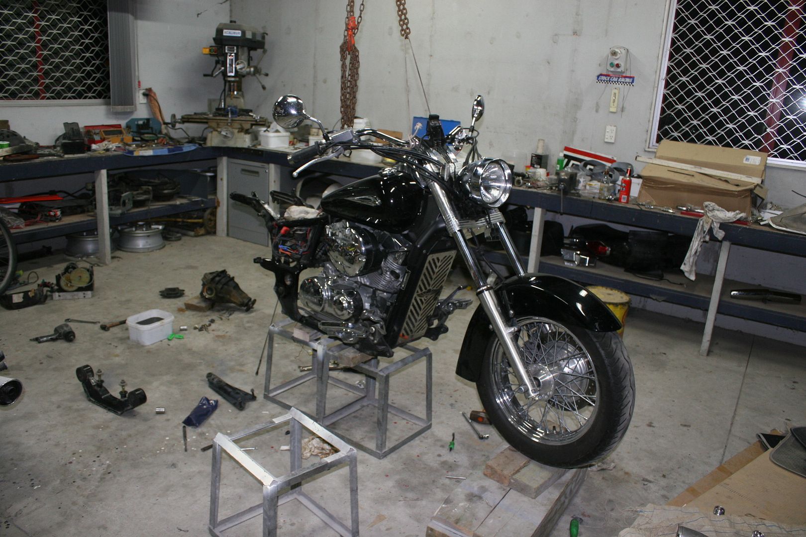

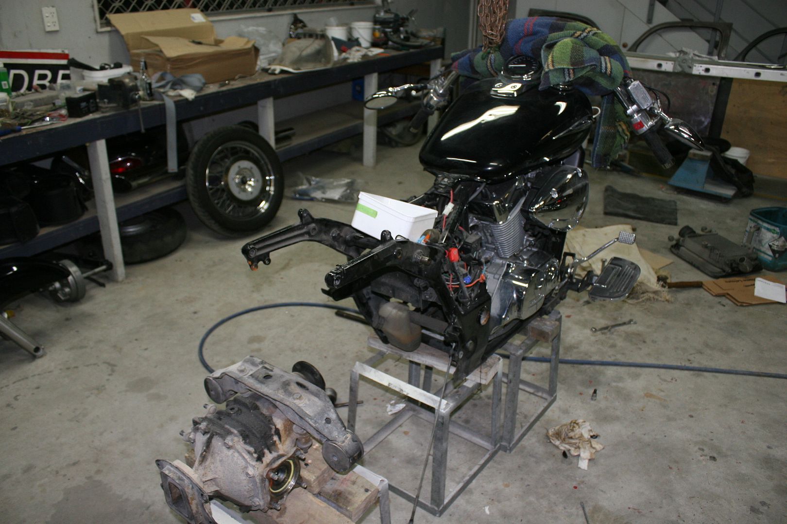

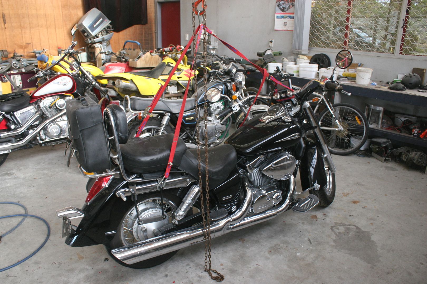

I started the strip down tonight and will take pics as I go and probably ask a few questions on the way.
Tonight's progress
the easy bit is the strip down :)

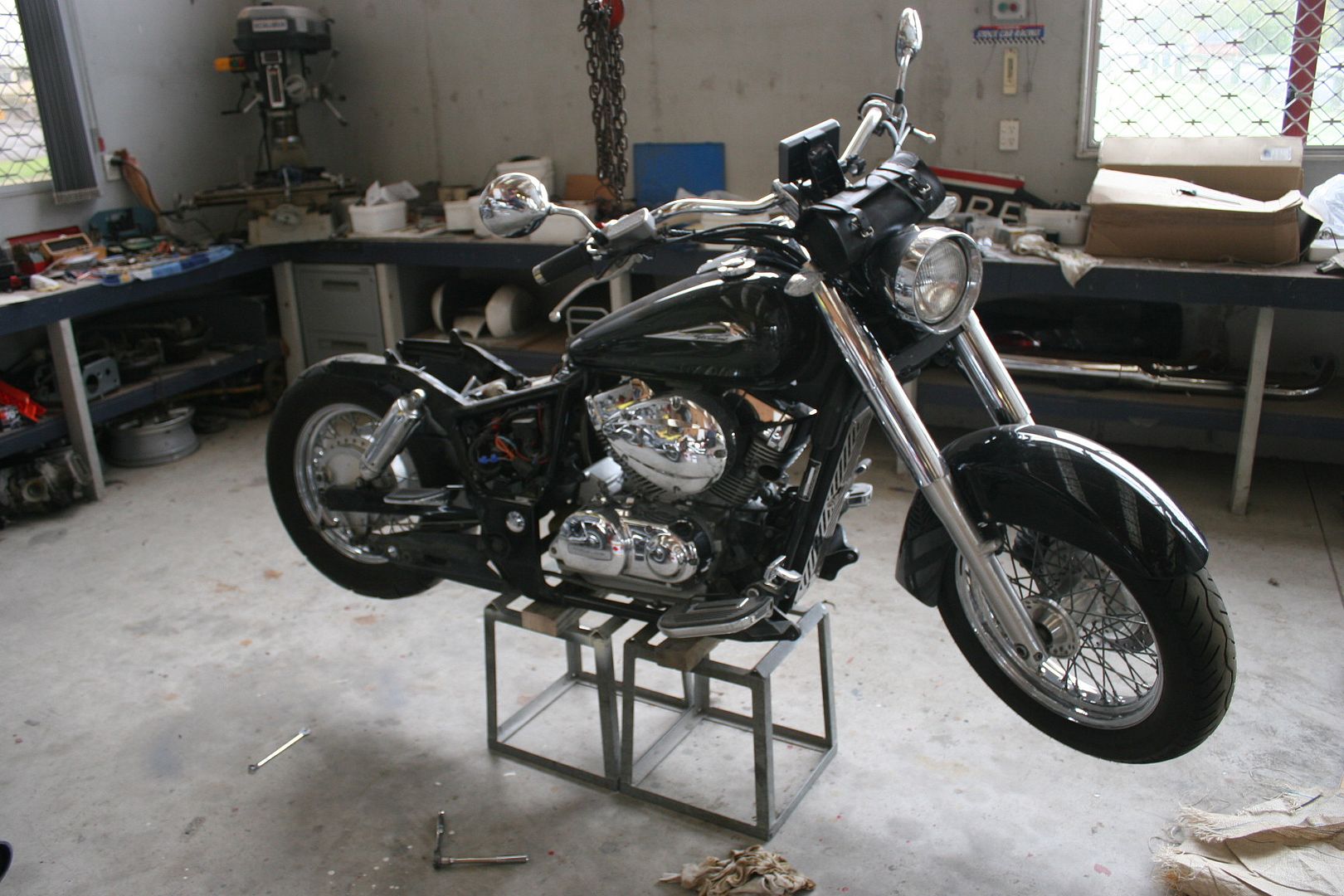

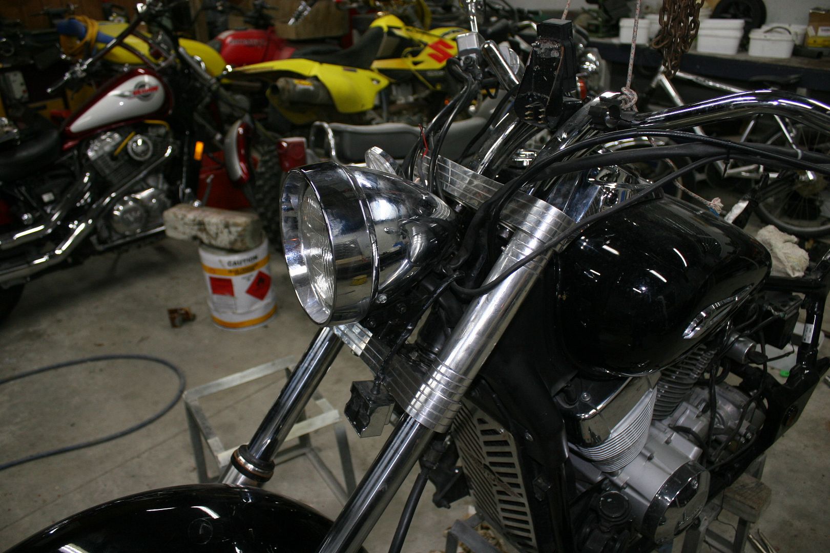

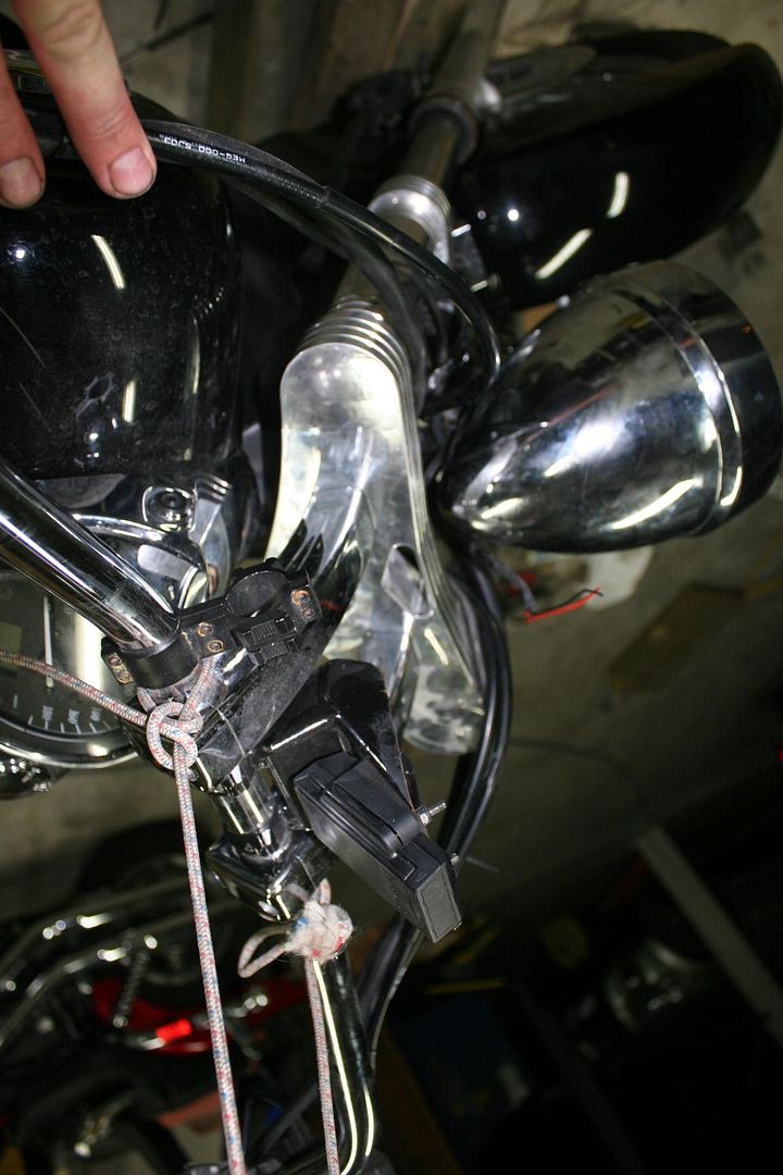

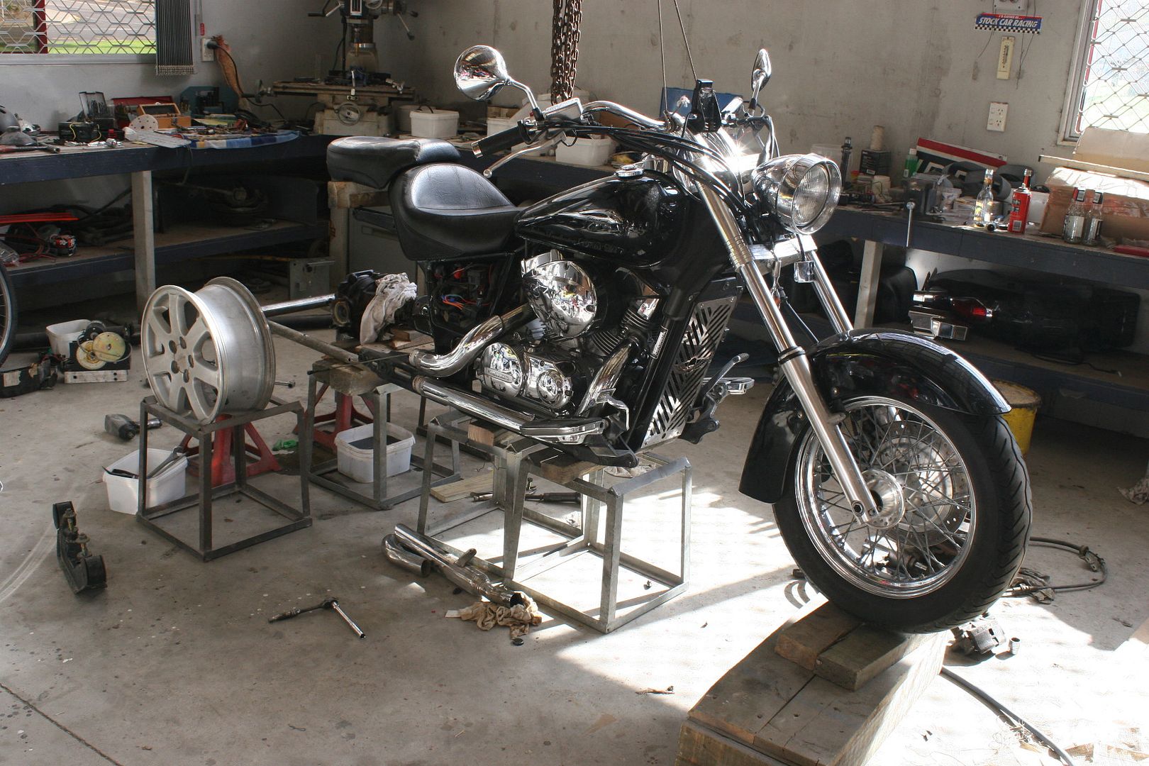

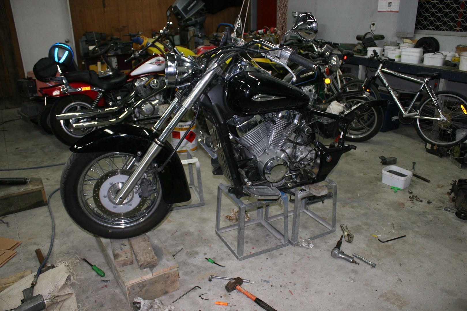

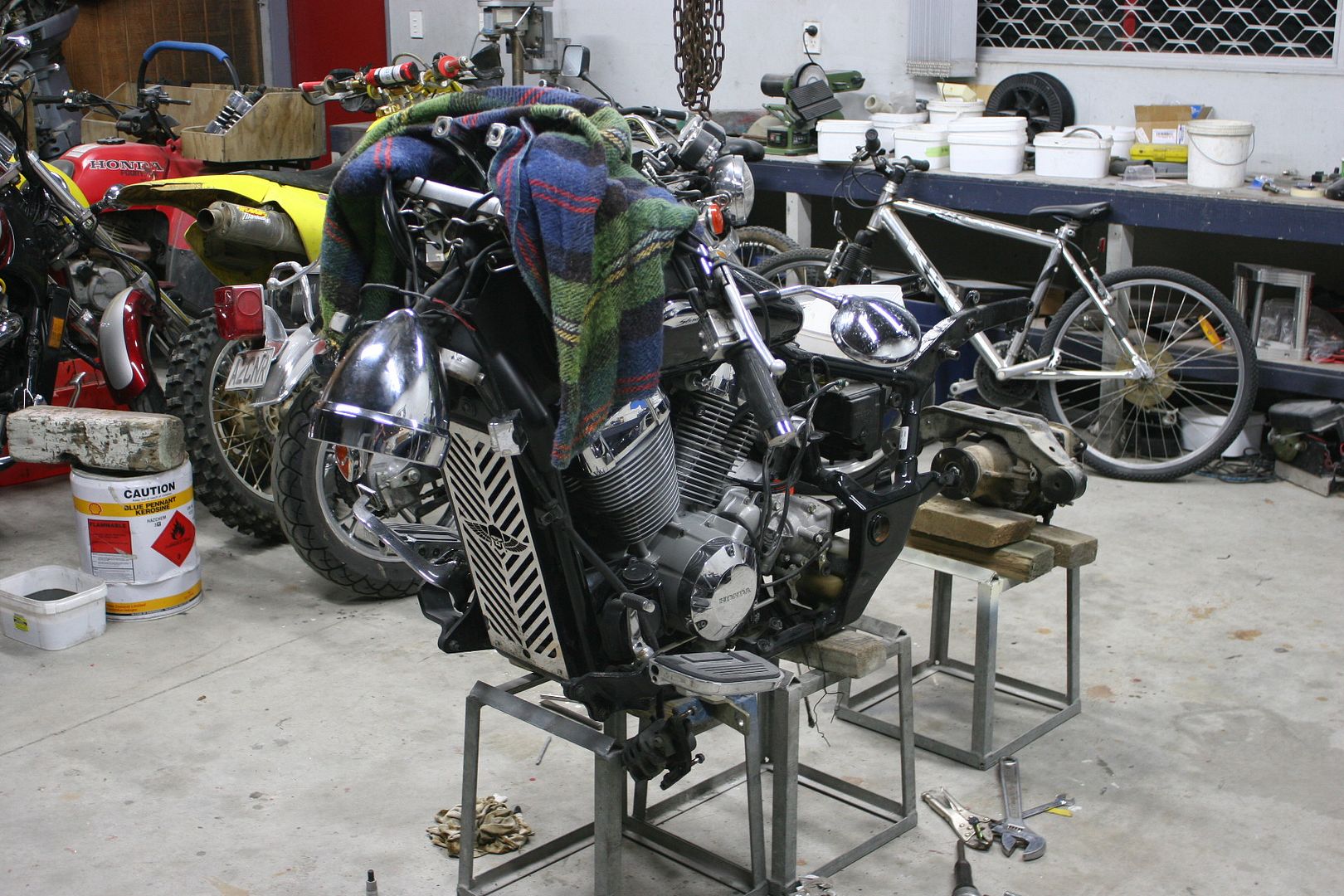

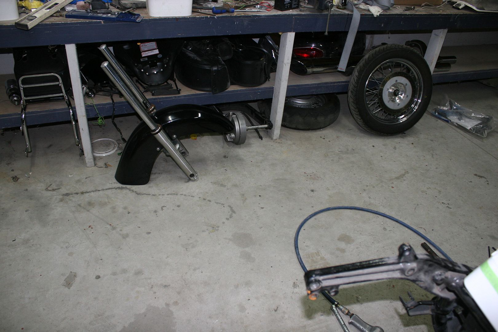

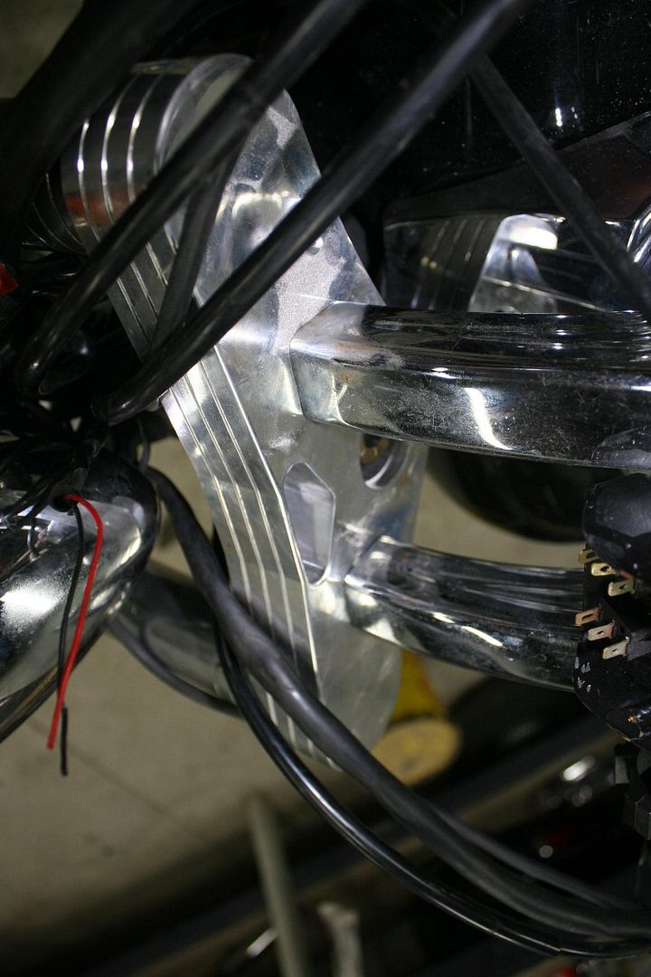

I popped the Mortons triple clamps on and fitted the new "ALL BALLS" Race bearings to the steering head to see how much difference it made to the wheel position... Answer is lots!
I am thinking I will trim the front guard back to nearer the shape of my VT1100C as the the wheel is further forward I think the guard looks wrong, That can wait until I have a lot more done..
for reference with the old setup (not a good reference due to the wheel on an angle making the gap look bigger)
I will mod the exhaust front pipes next as their position will dictate where some of the framing will go :)

Looks like a 5 degree triple tree...to me. Nice looking piece of work!!! Got an address on that thing???????

I think the Morton's triple was 7 deg from memory, it was a good fit with the bearing kit that I got from them as well, quick search and yup 7 but the pictures I took don't really show it well.
http://www.mortonscustom.com/hondatrees.html
http://www.mortonscustom.com/index.html
Being I am in New Zealand picking up the used rear might be a bit far to go ;)

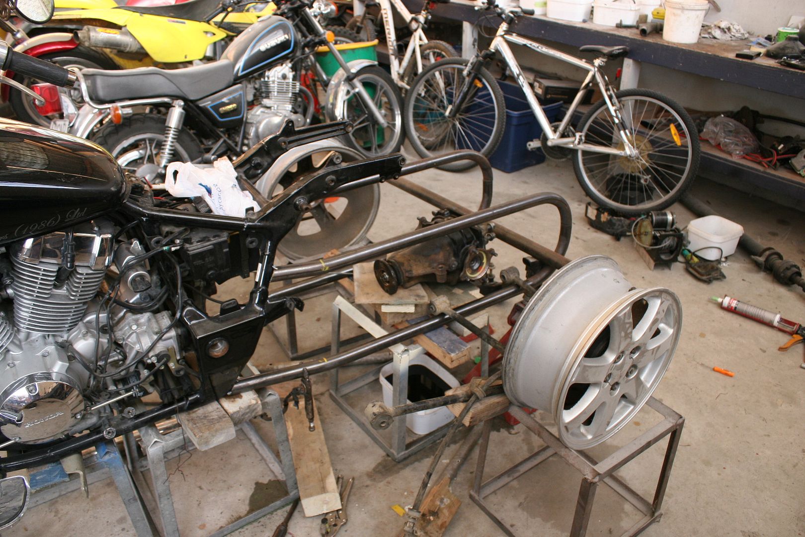

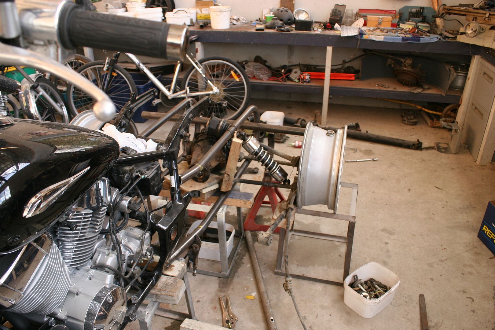

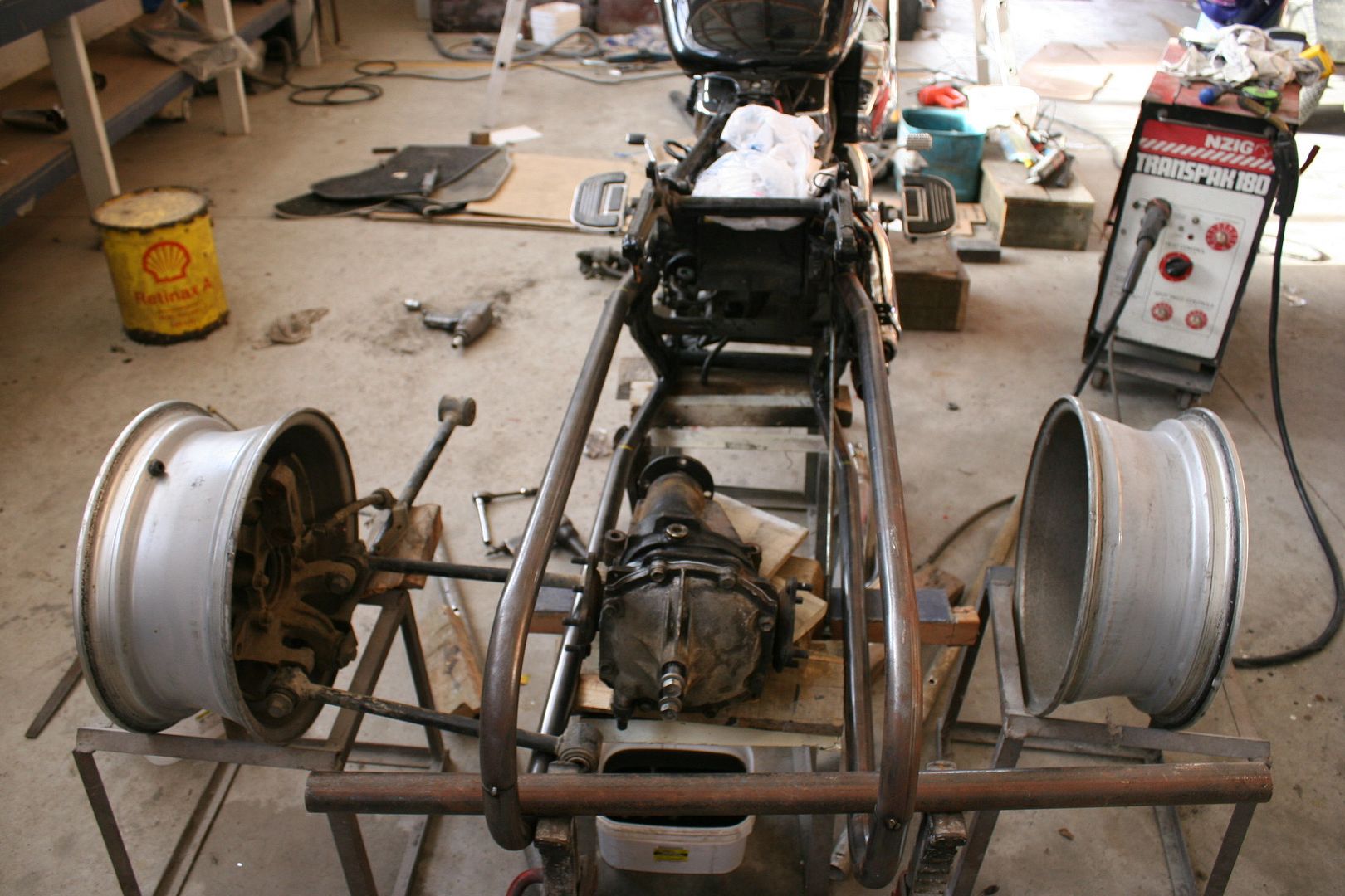

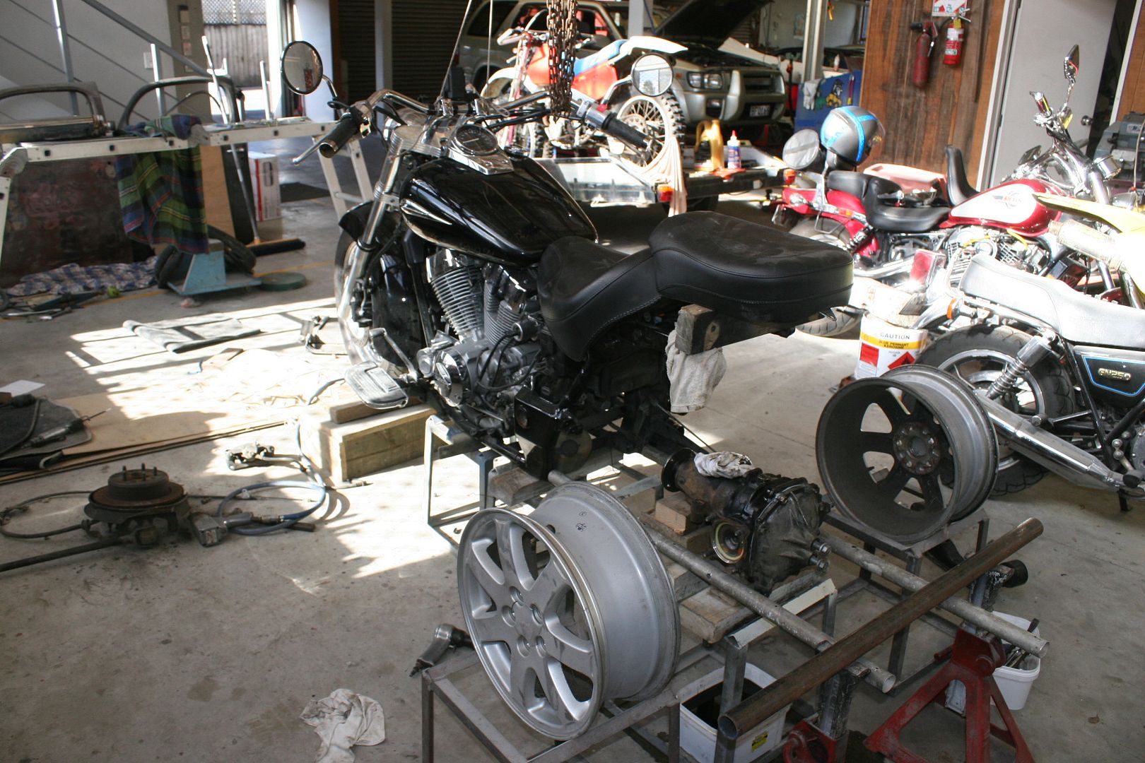

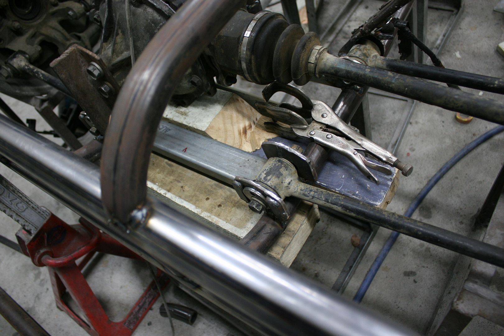

I managed to put a little time in this afternoon, Got base for the frame tacked in place, started to look at the suspension links to see if I use the old arm I got from the car or fabricate a new setup.... leaning to using the current arms as its less work but time will tell :)
I have been looking at luggage storage options so I can set the rear width to suit, I dont want the wheels poking way out the sides.... Both the top box and hard bags are now ordered, Bags are less paint and brackets but that suits me as I will make my own brackets to suit the new frame and I have a spray booth at work so paint is not a problem... Much much cheaper too :D
http://www.partzilla.com/parts/detail/aftermarket/XP-4794510.html
the top box was the one the wife chose and I am not positive it was the best one, almost a bit of a gimmick but it may look great
http://www.ebay.com.au/itm/Black-Mo...rcycles_Parts_Accessories&hash=item5d4bb1f1ed
With the wider saddle bag it allows me to have the wheel at a width the RH axle can stay std... less work to do than expected. I will fit things when they arrive before doing the final fit up/ setup of the suspension and diff
over 10 gig of viewing had my Photobucket acc put on hold :xzqxz:
Upgraded as I am running out of space as well so I can take plenty of pics

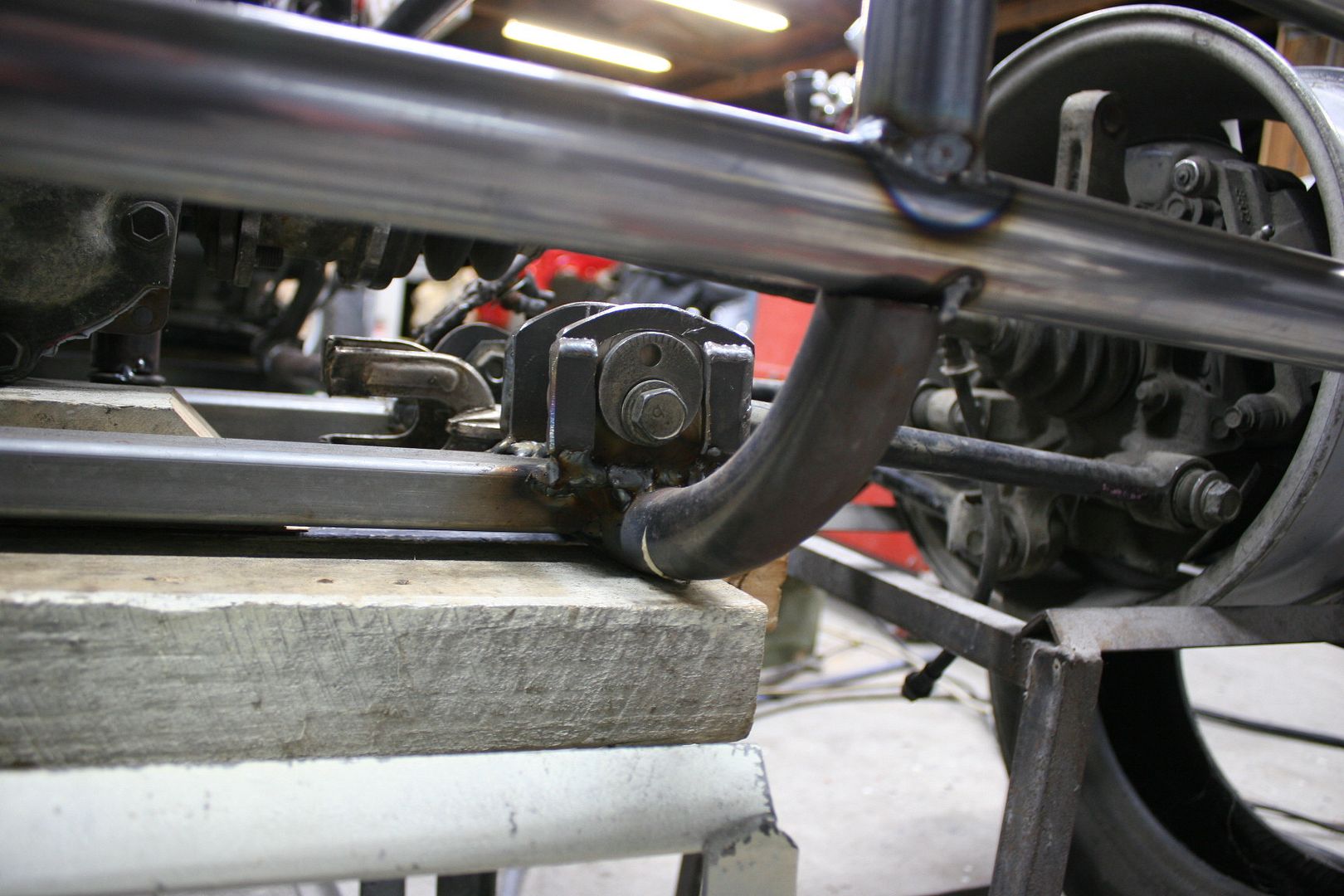

I should have the lower arm and diff mounts sorted soon :)

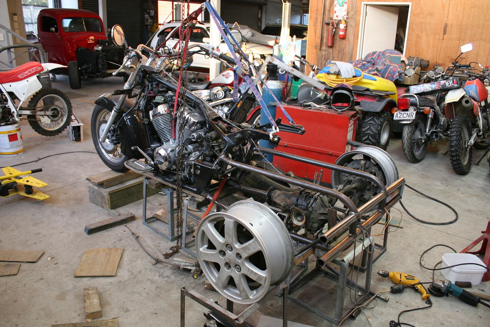

OK so its going to be an early night on the bike tonight...Just ran out of gas for the welder
So I guess an update is in order...
Been some highs and very lows in the last week and a bit.....

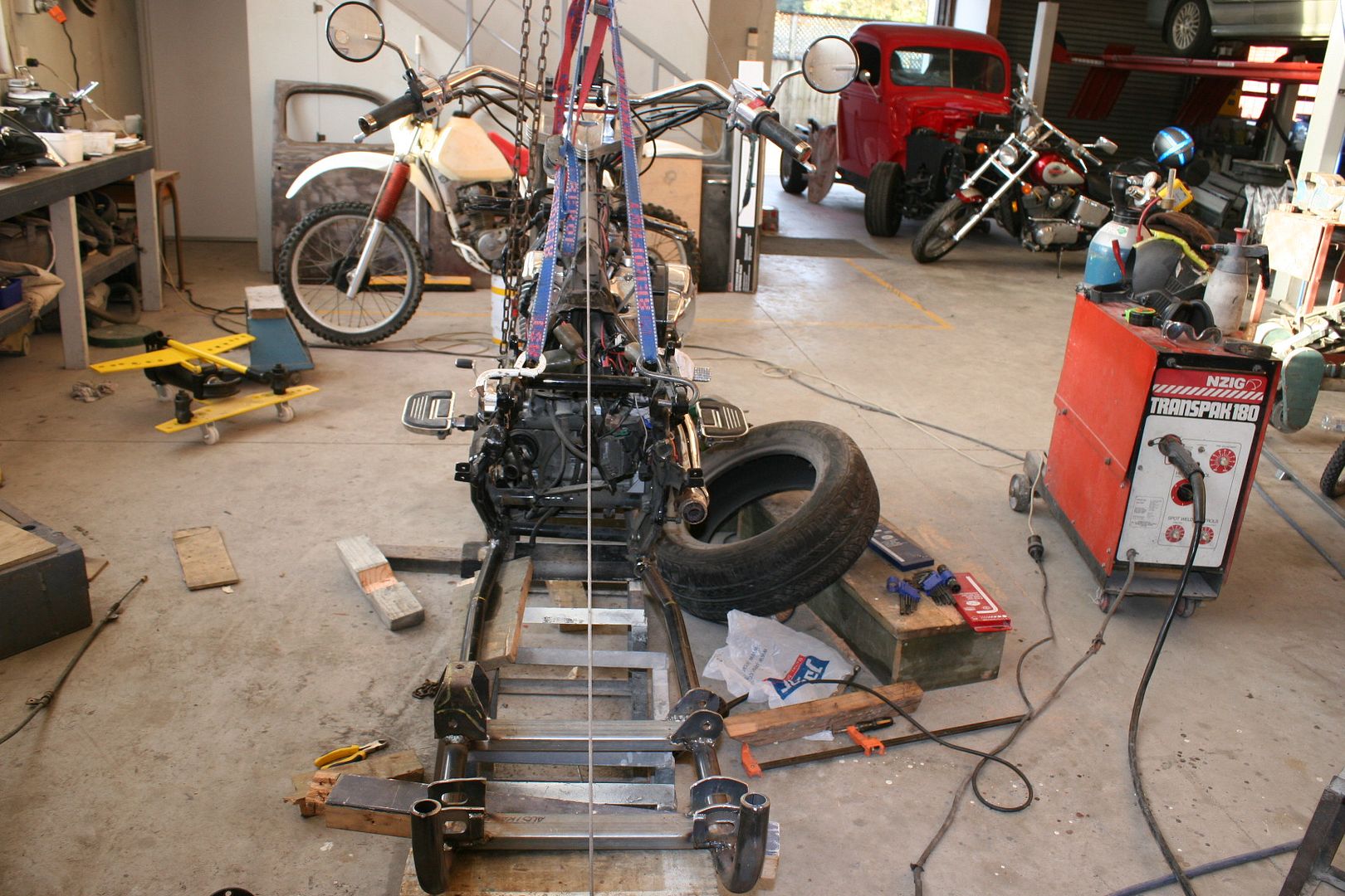

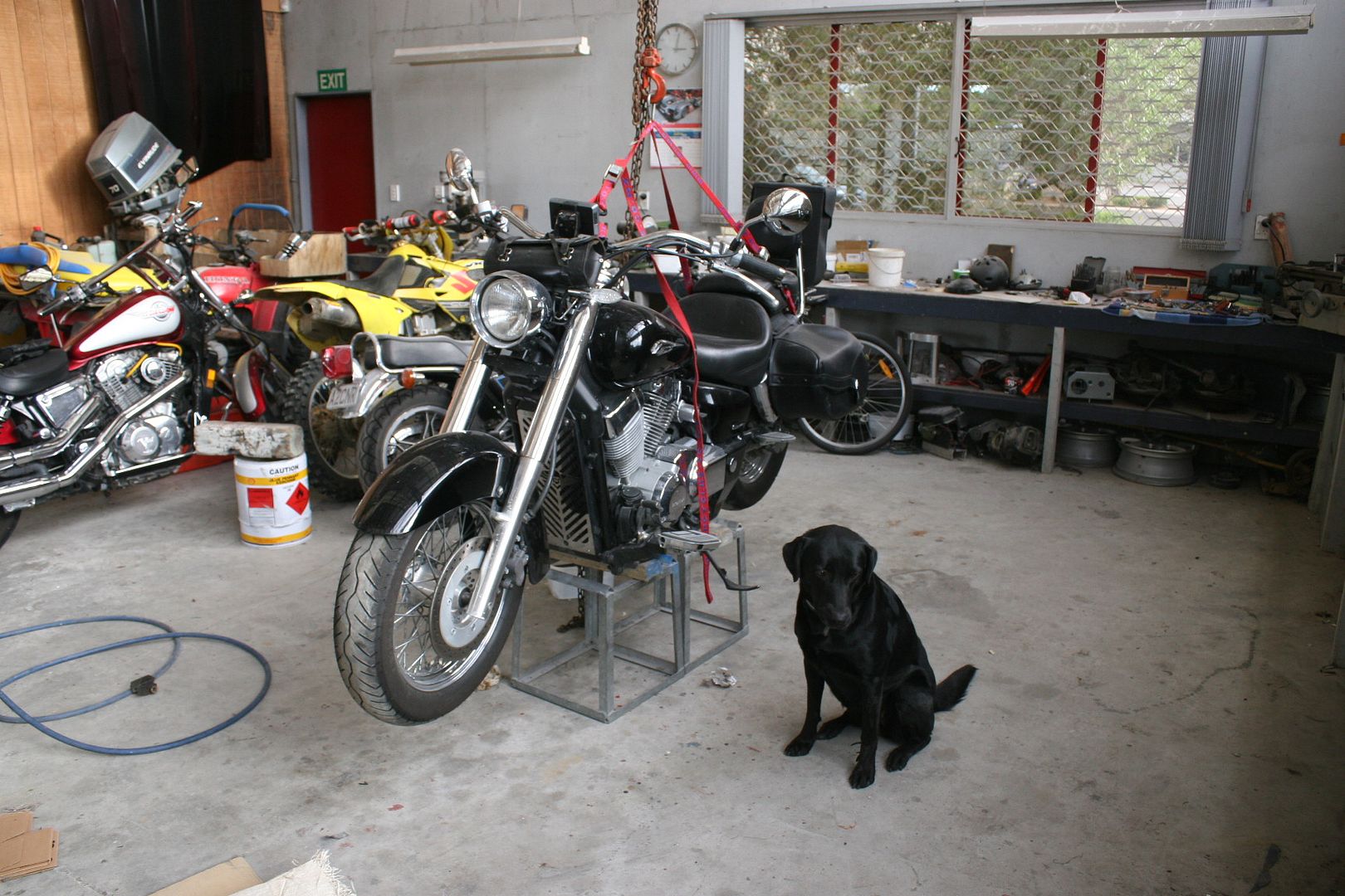

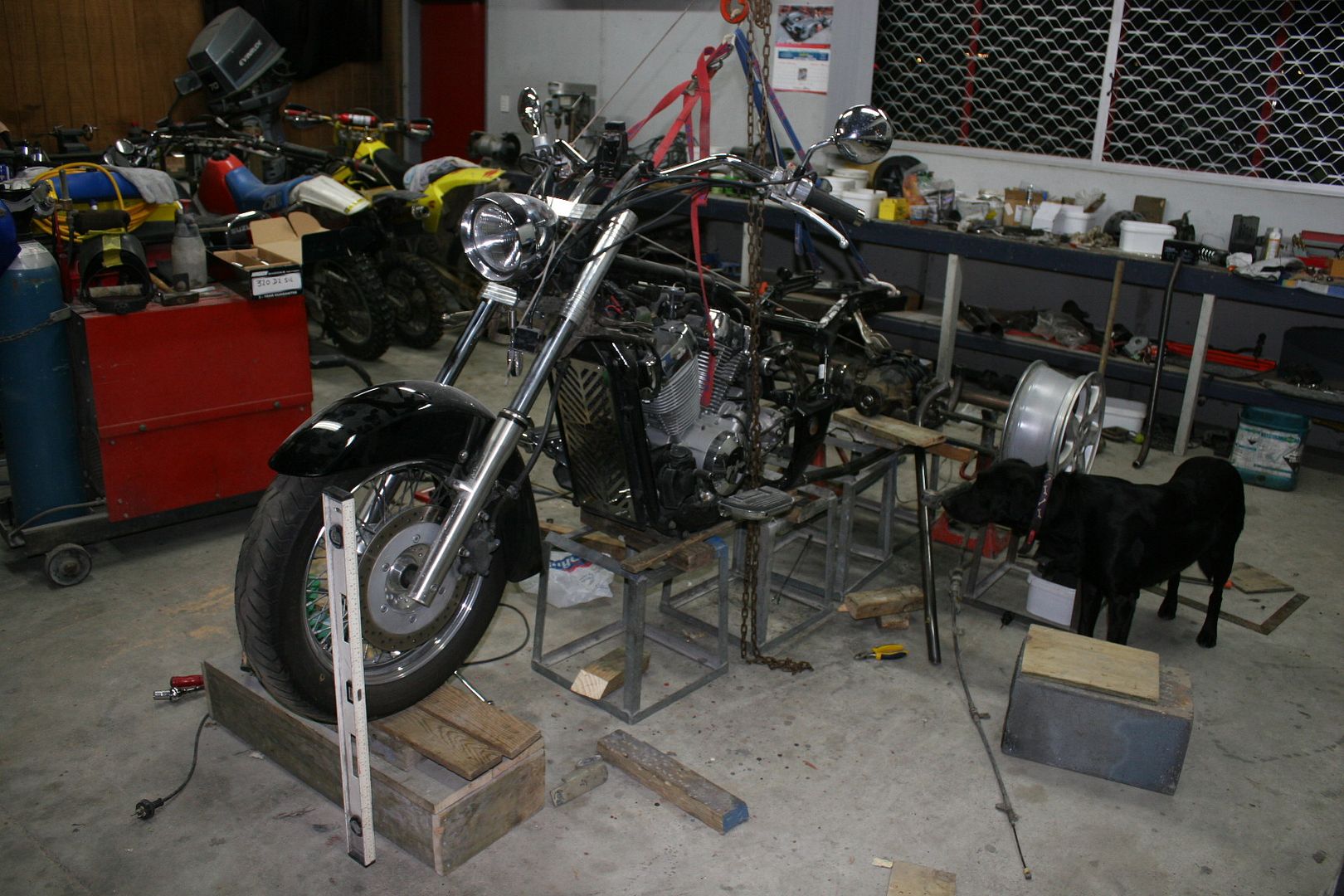

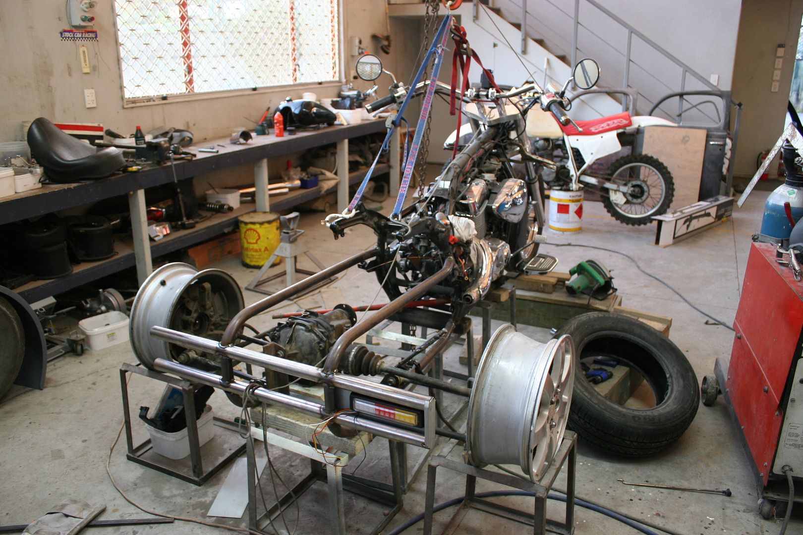

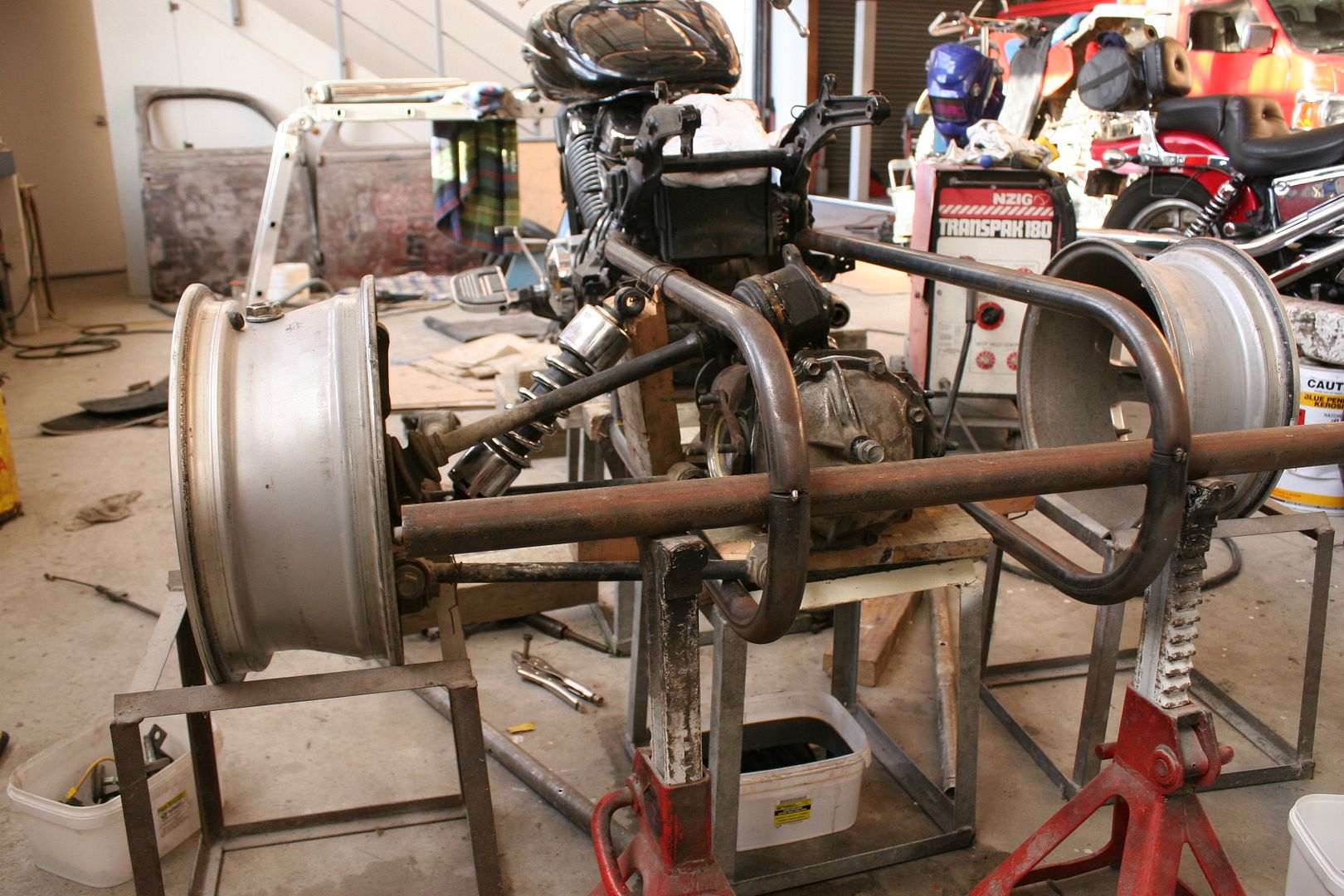

Sunday been was a shocker, with a death in the family (uncle) I sort to spend a day on the trike and get some real progress, I had some of the Suspension work done in the evenings so was showing progress :D

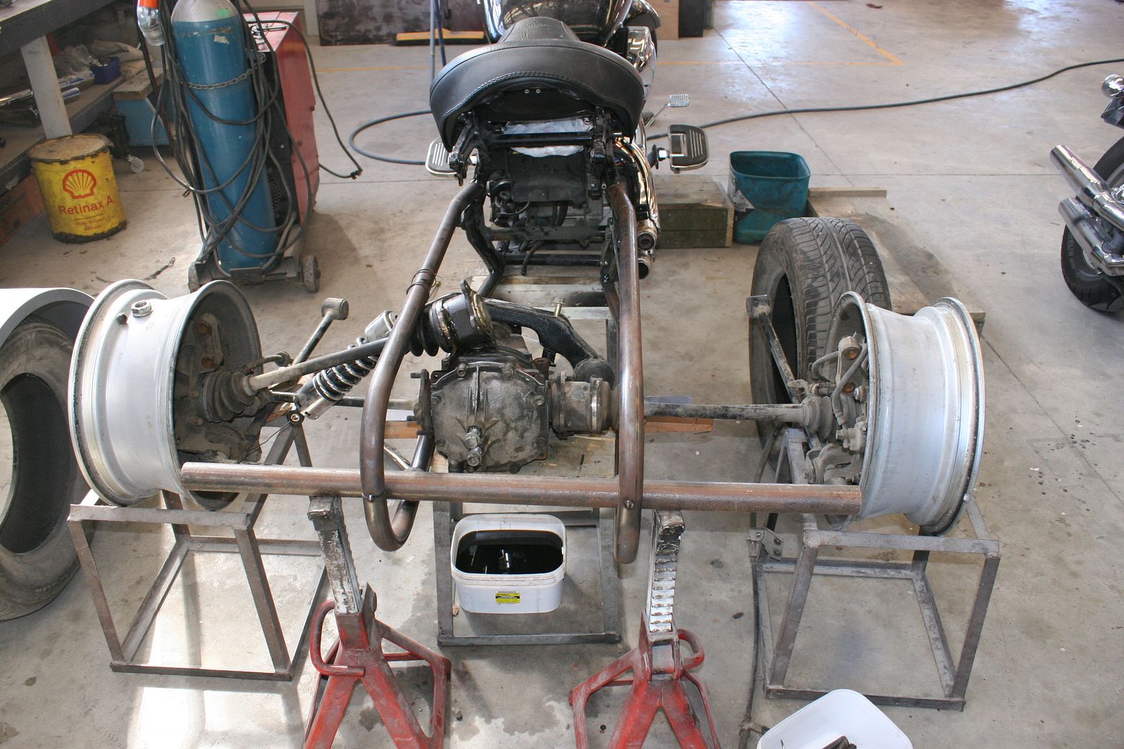

but on a stand back and look Sunday morning things didn't look right, lots of measuring and scratching my head the rear was square to the lower frame..... but not to the upper frame???

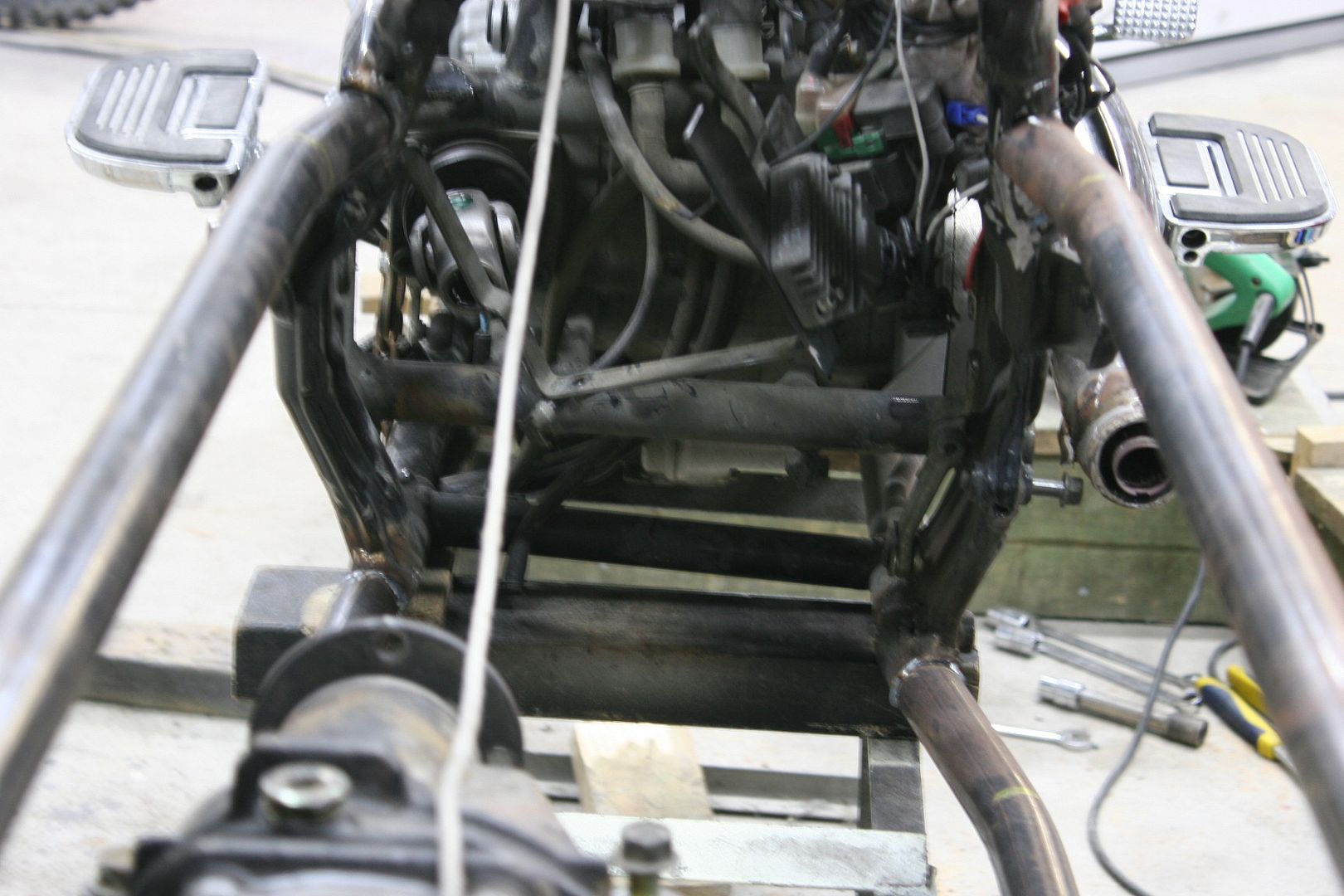

OK set the front wheel/ triple clamps to the center line of the bike, lock them there, get a level out and see it the from wheel is vertical (its not I can see it but I need to make sure) and sure enough its not, tilt the bike until it is.... and Houston we have a problem! the lower frame was not a good part to set the plane to measure from as one side is 18mm higher than the other... Faaarkin great. Out with the cutoff disc and drop the new frame of the bike (mostly just tack welded in place thankfully) ... take a break and check my emails and I have one re my saddle bags order... they want another $258 for freight if that's OK.... Faaark that, still trying to sort that one as I can get others the same size for 1/3 that freight.
The dog knows something is up... Look boss I see the problem right here :p
nothing in this pic is symmetrical side to side...
Bend a couple of the lower pipes, measure again, bend some more, recheck... still a bit more then we have the lower frame in place and Sunday over with zero actual progress

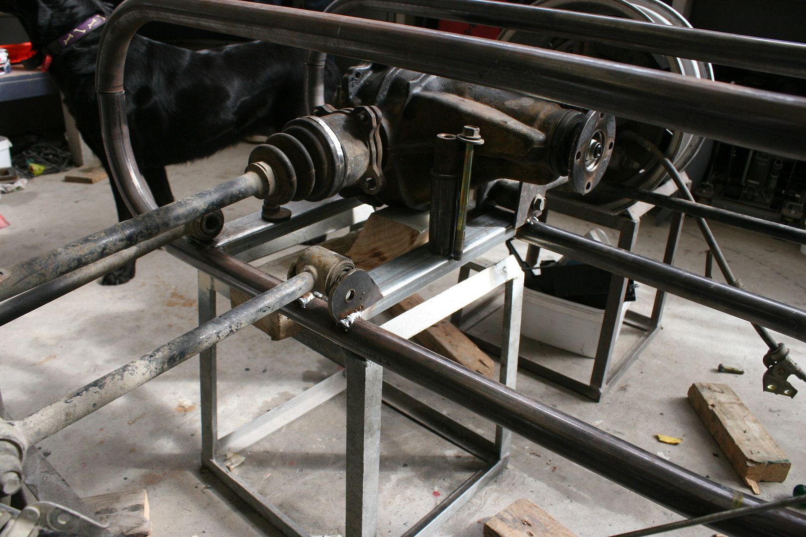

After work it all continues, While the upper is off time to make the bumper and light mounts, finish making diff mounts etc and now back on progress mode
Sorry to hear of the death and also hate to hear of all the problems with the build , but I bet you learned from that mistake and won;t be made again . Still seems your getting a lot done and the progress is looking good but I bet Mamas waiting and wondering .:confused:
As far as the boss goes it does seem he has spotted a problem may want to check into that a little closer or if he's like mine thinking about hiking a leg .:D
Yeah wont make that mistake again!
I am lucky.... the dog is a she so no cocking the leg on things
At least I didn't have to rebuild much, just tweak and re-weld in... All square now

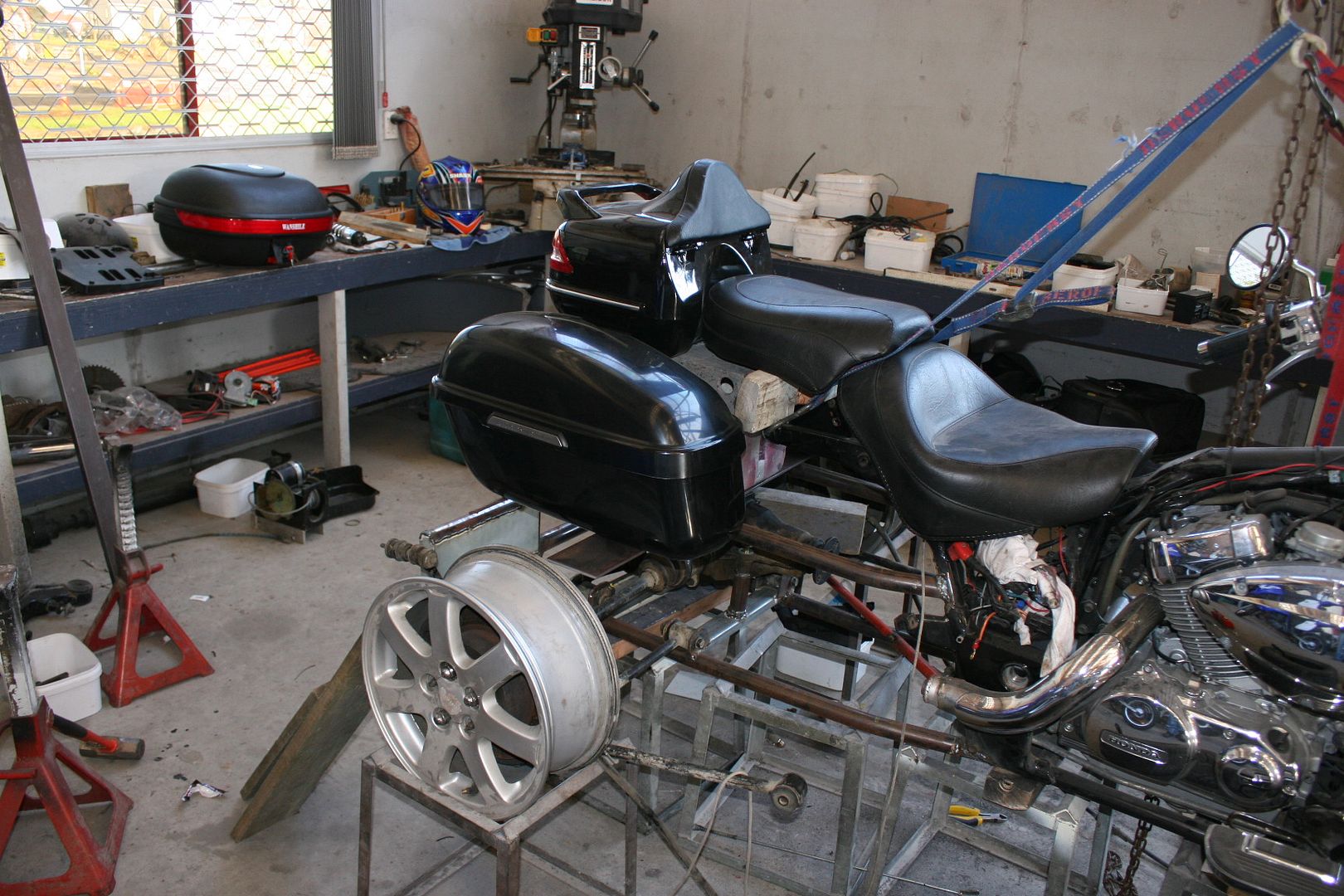

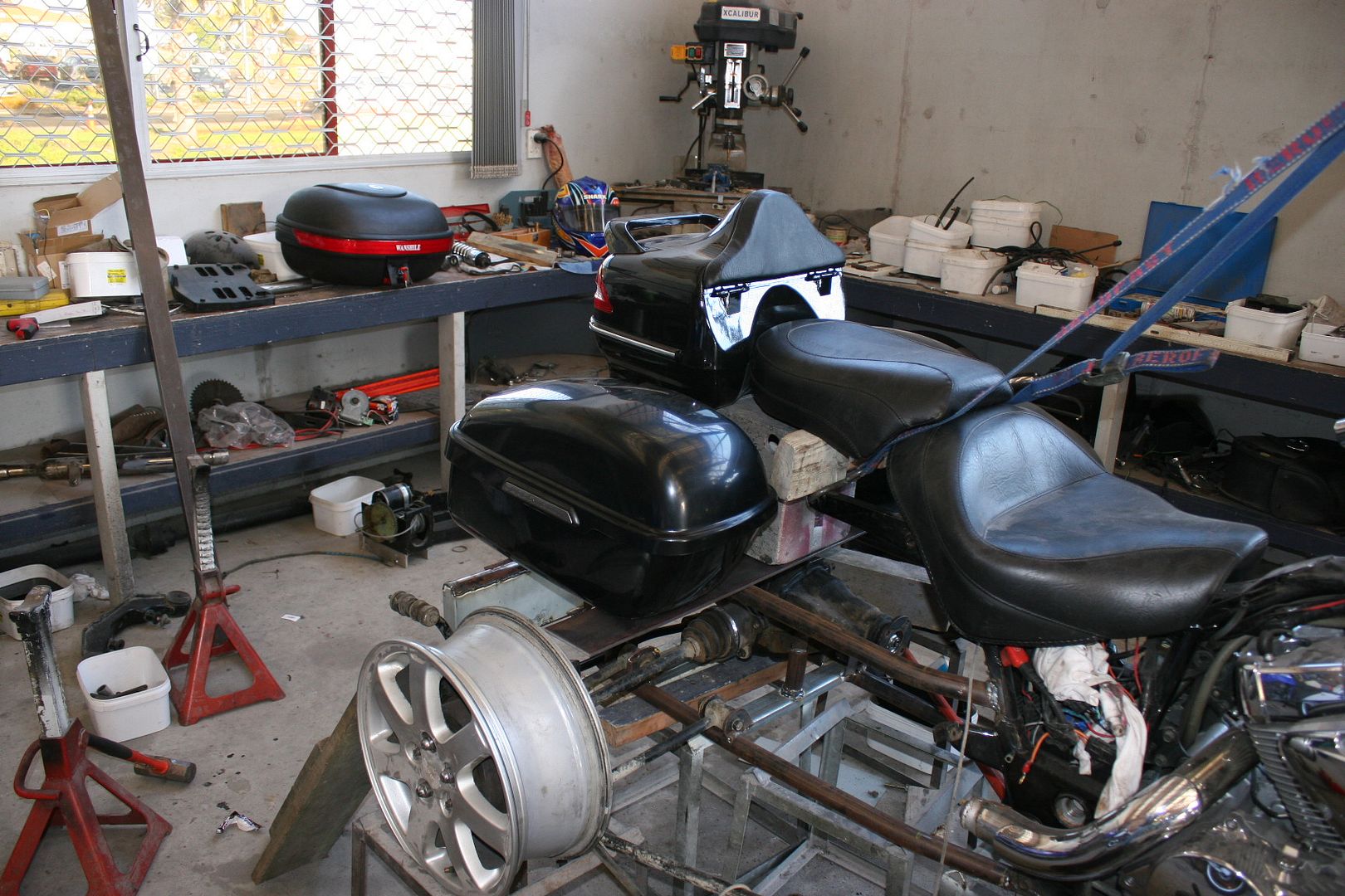

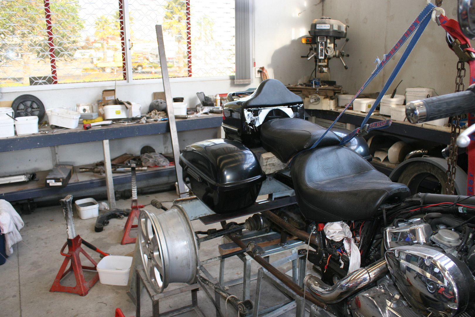

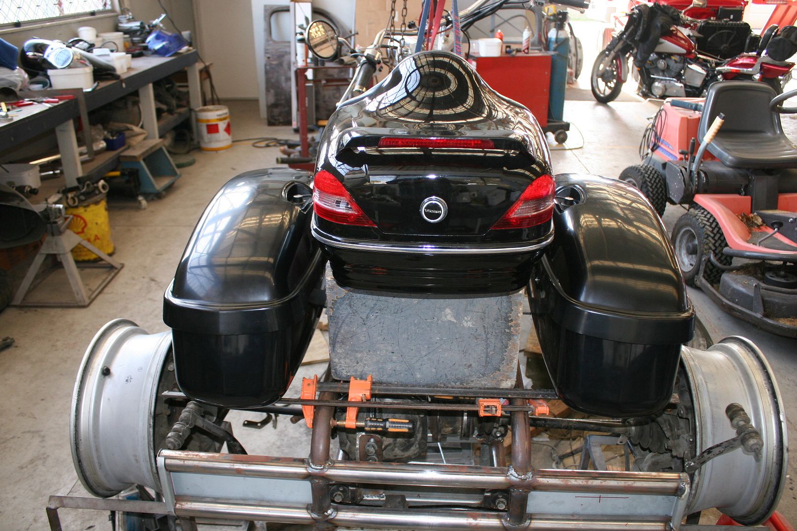

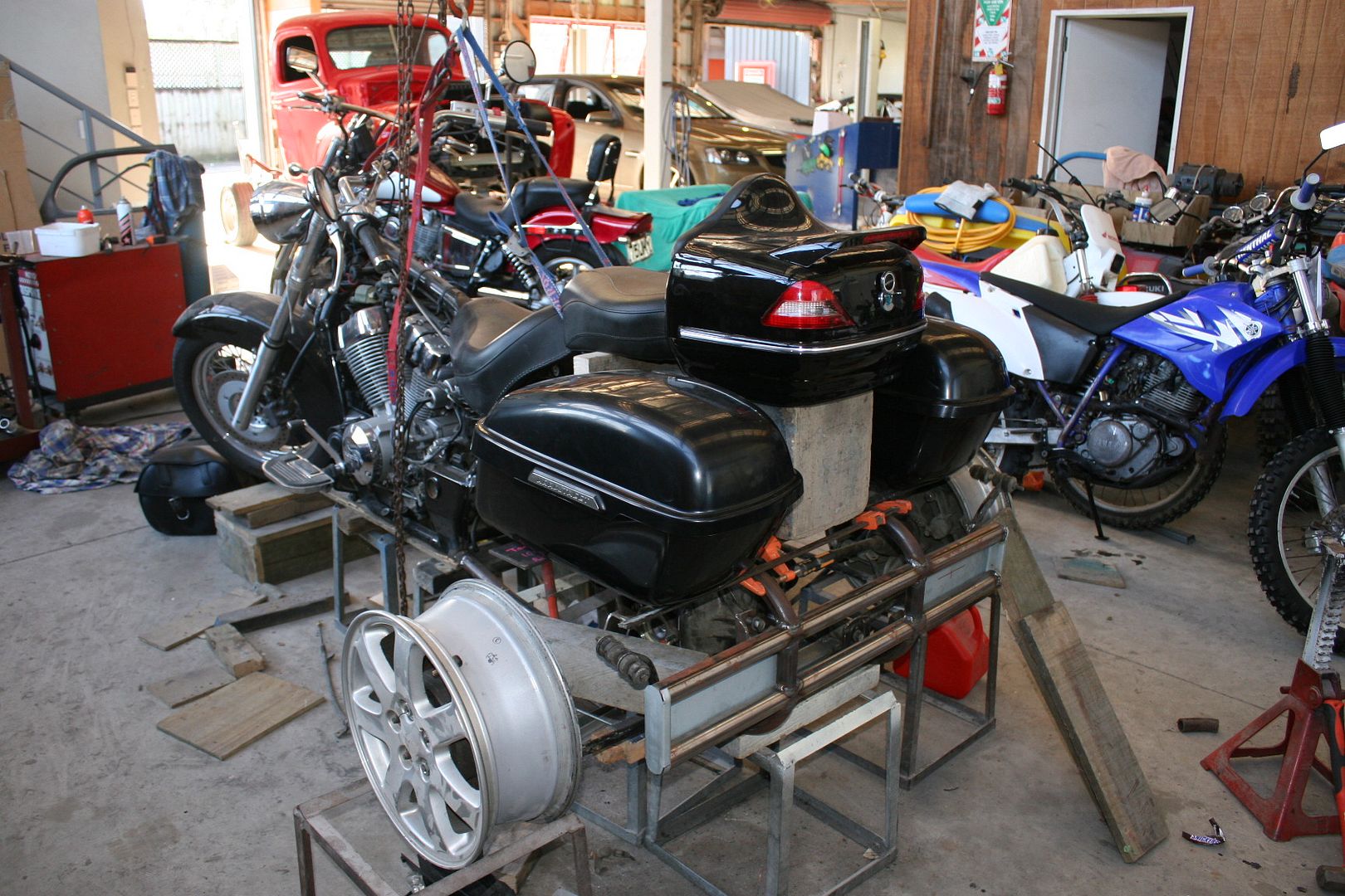

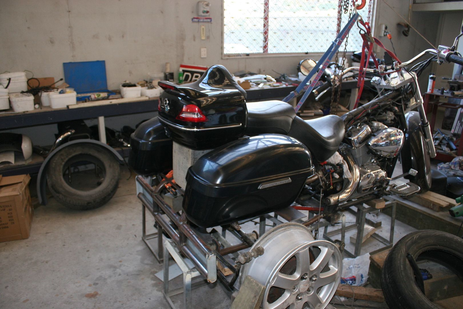

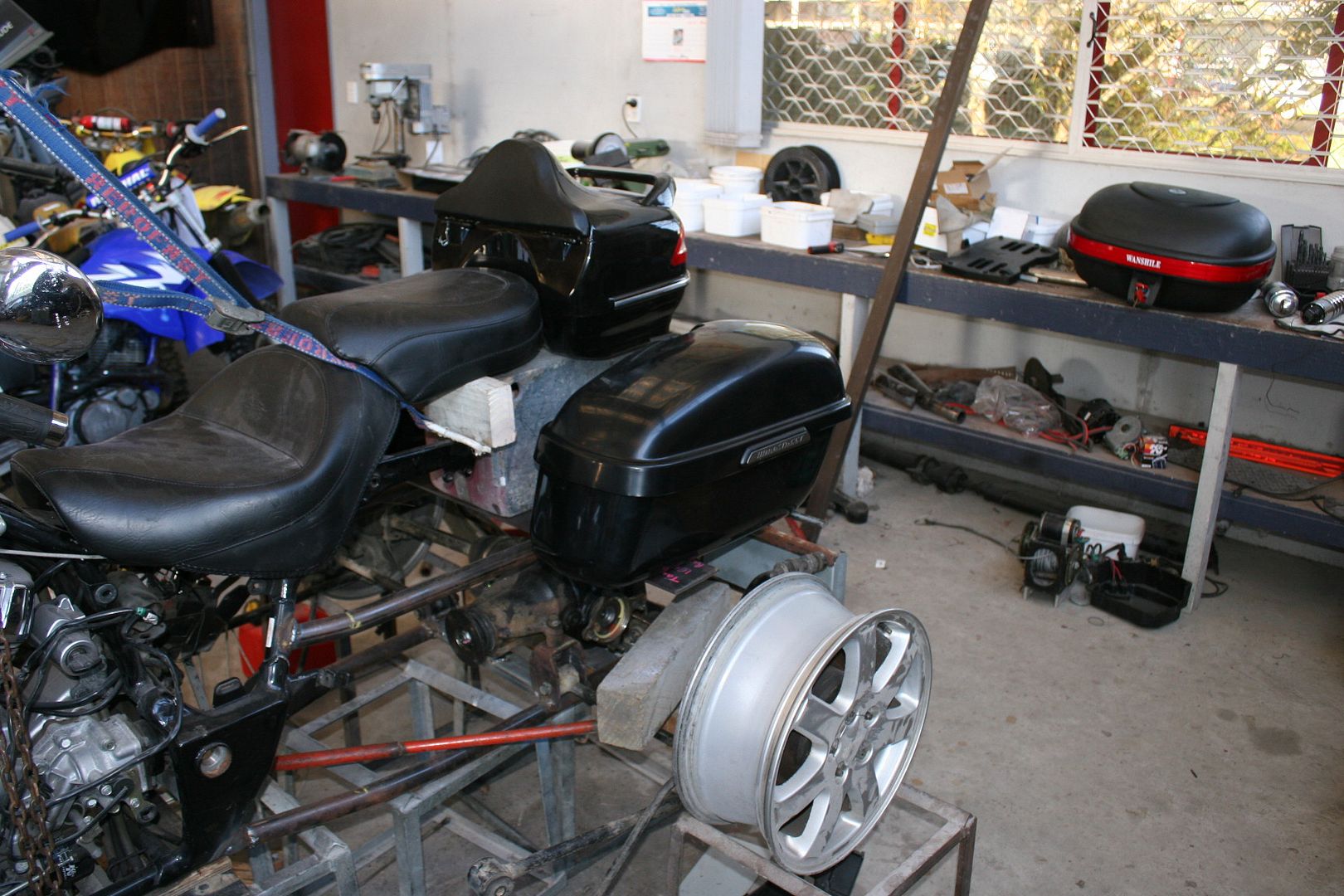

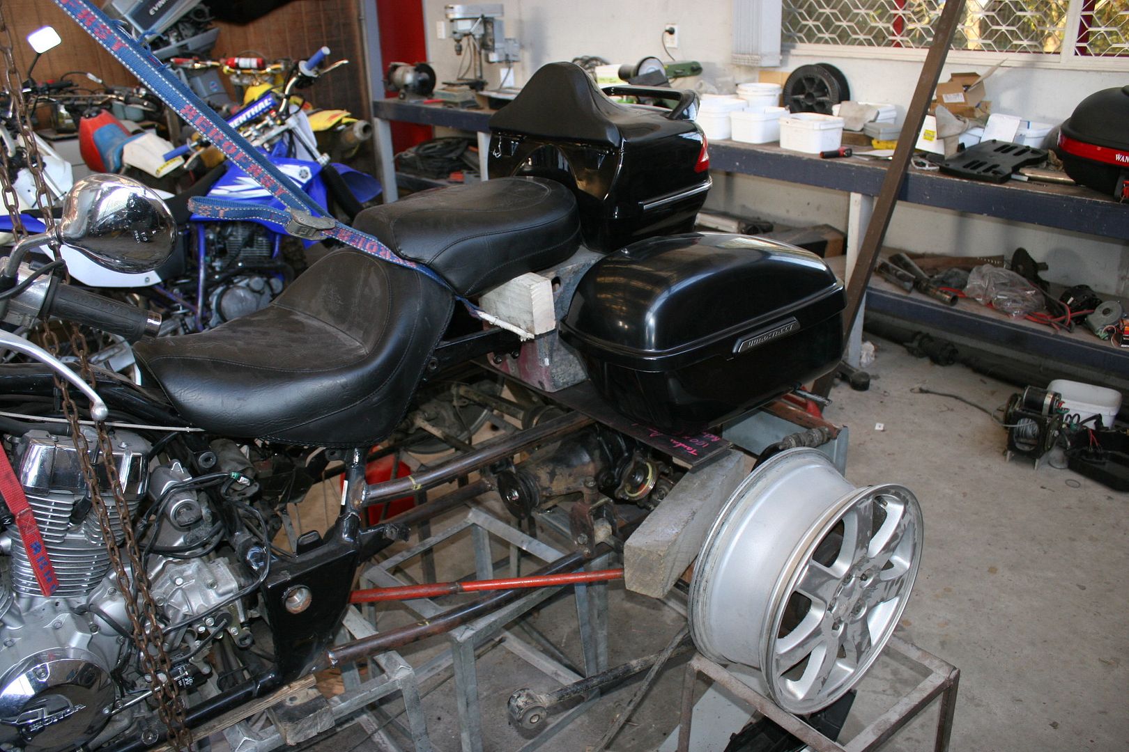

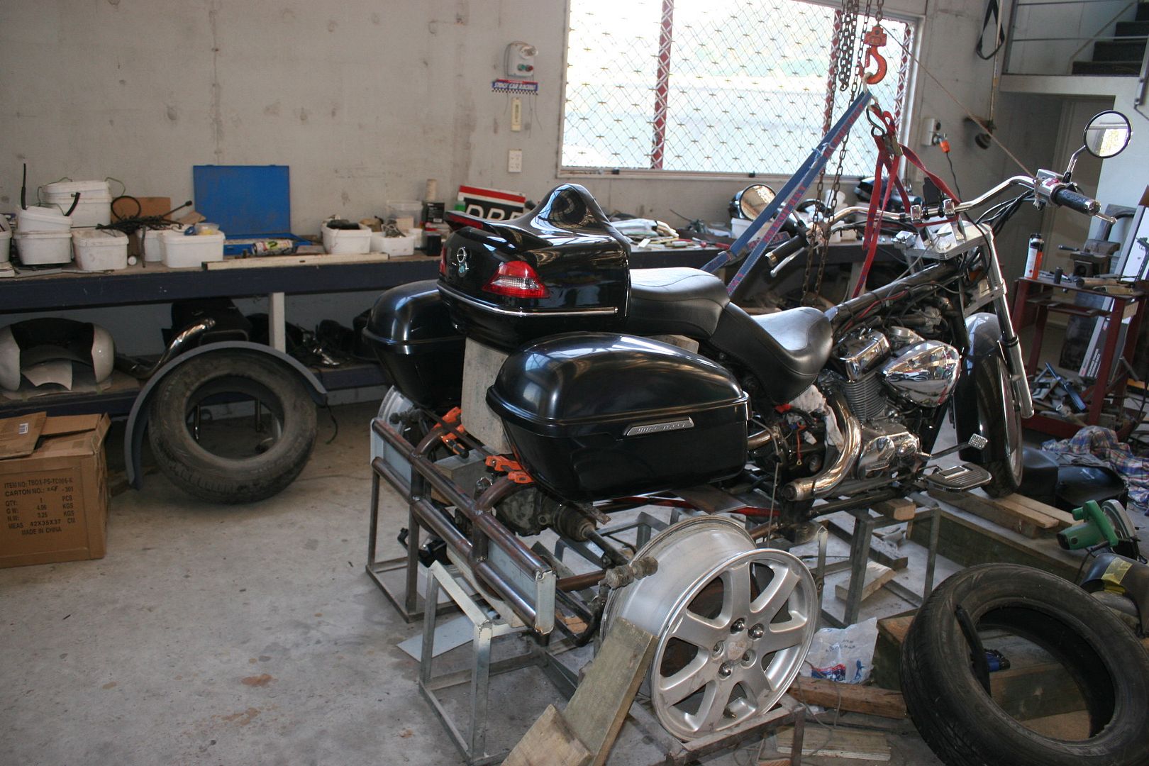

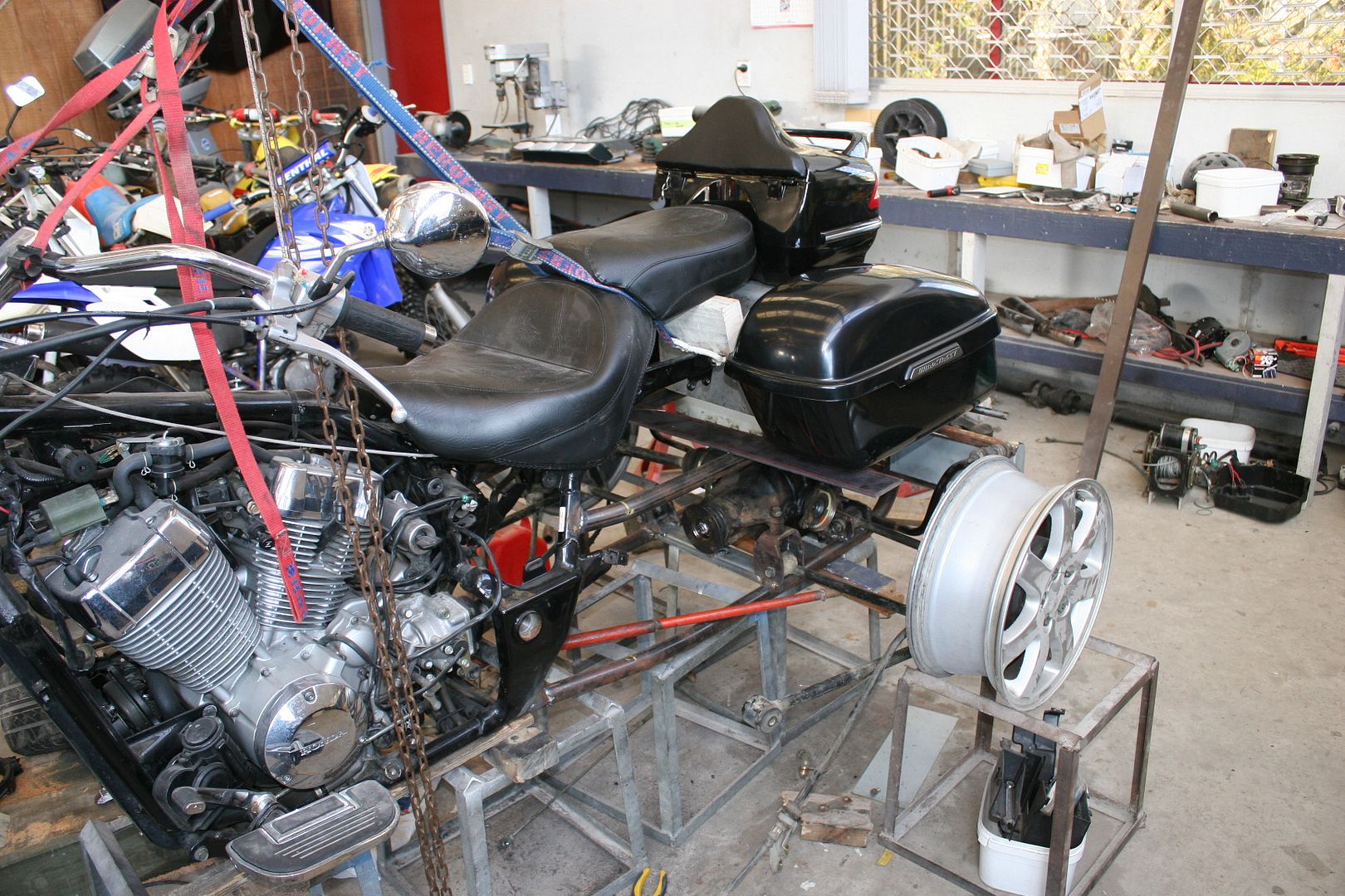

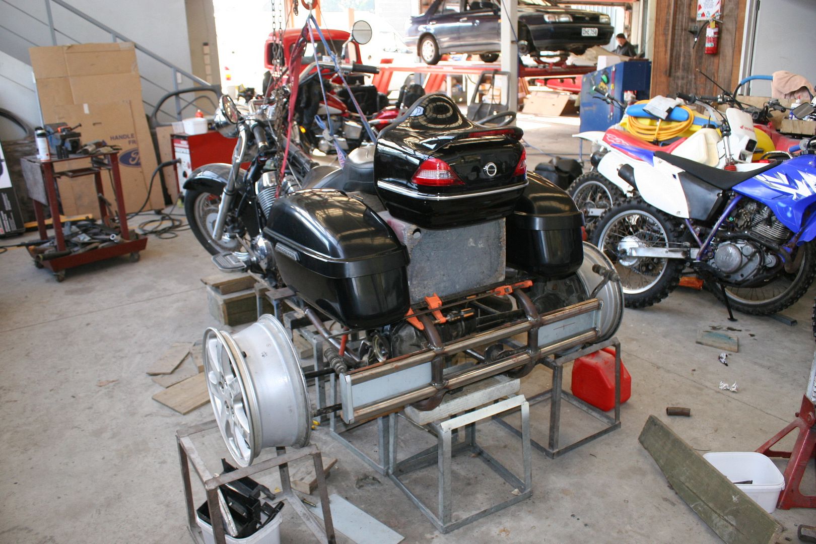

unpacked the saddle bags (similar to the original ones I ordered but from Amazon) and propped them up on the bike to see how they will look
The top box is to small to fit a helmet so have another on the way, the area the wooden box is under it will also be storage but longer than the bags.... plenty for those long weekend trips, the wife can be the gear storage on the trike so I will hardly need to put my saddle bags on :D
Now I have the bags I can get back to the suspension, had to wait to see the clearance to the bags.
I need to make my mind up on the way the bags sit, the wife is not sure.... leaning one way, I am leaning the other.
Thoughts anyone, 1st way or 2nd
or
or
or
or
Taper to rear, you'll need to raise the tour box so it hits you wife in the right back area, may also require a back pad added under the one that there or just a whole new pad to get it to look right. My wife never liked the Givi box for that same reason, it hits in the wrong area and doesn't give enough support.. a happy wife lets you have a Happy Life!! Just my FYI .... Lookin Good!!
The wife will be the pilot on this, I will be on my cruiser ;)
But yes the top box is going to have the base removed and a new one built to give it more depth and height, it also wont be tapered to give more space. There is going to be a total rebuild on the padding with more shape and a lower pad added
Yes the taper to the rear was my choice and now I have pointed out it will then match the tank shape it is now the wife's choice too :)
