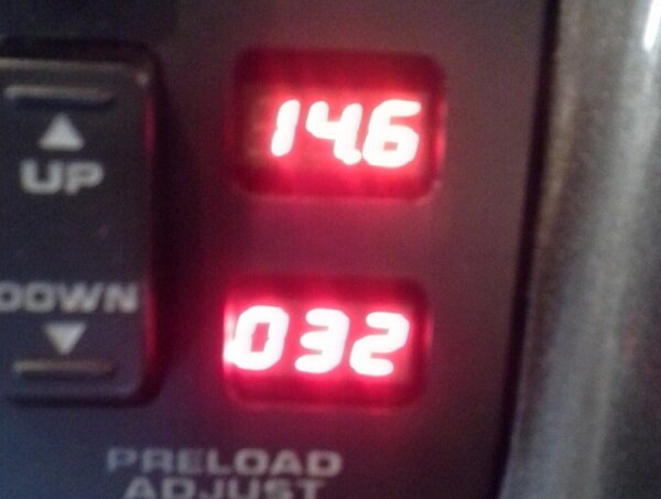

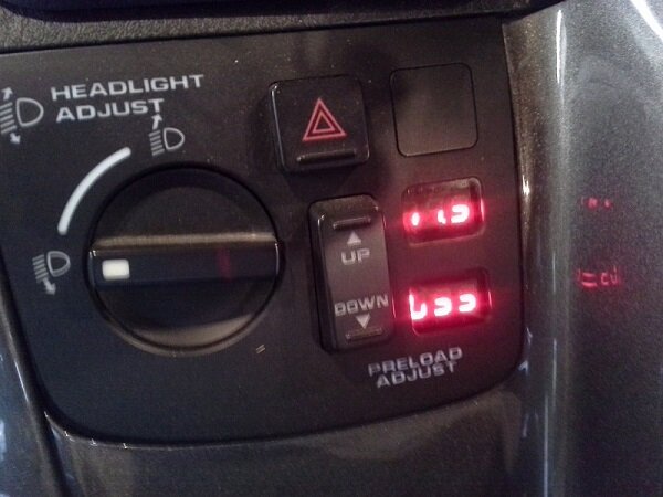

I was frustrated with seeing only a portion of the LED display on my Motor Trike Adventure.
Sometimes all of the numerals would display and sometimes they wouldn’t. If I pressed on different areas of the display, other segments would light. I figured that it probably wasn’t a bad LED, but rather there must be loose connections somewhere.

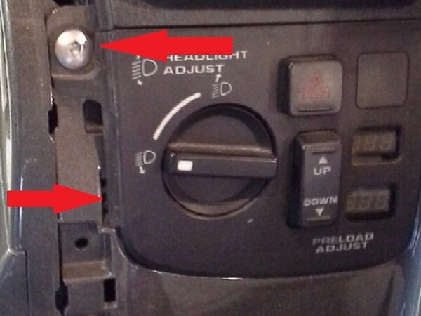

Removal was pretty easy. I removed the trim strip to access the 5mm allen screw. Just below the allen screw is a locking tab. Pushing on the tab with a small screwdriver just enough lifted out the panel.

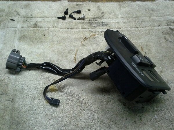

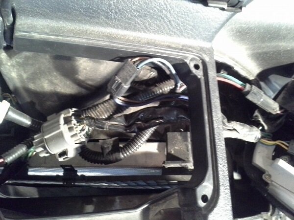

Pocket removal made it easy to access the connectors that go to the panel.
The whole panel was very easy to remove.

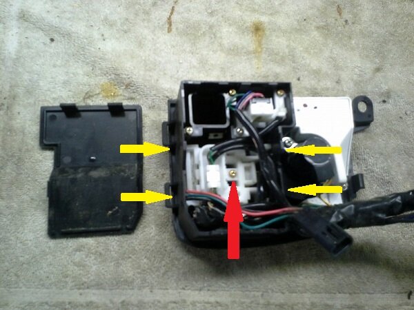

I removed the back cover to access the electronics. Then removed the center screw (red) and popped out the 4 locking tabs (yellow) on each side of the adjustment switch assembly.

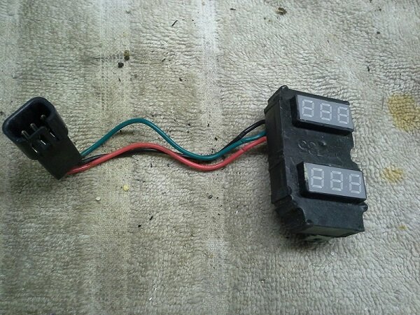

The LED display unit just slid out.

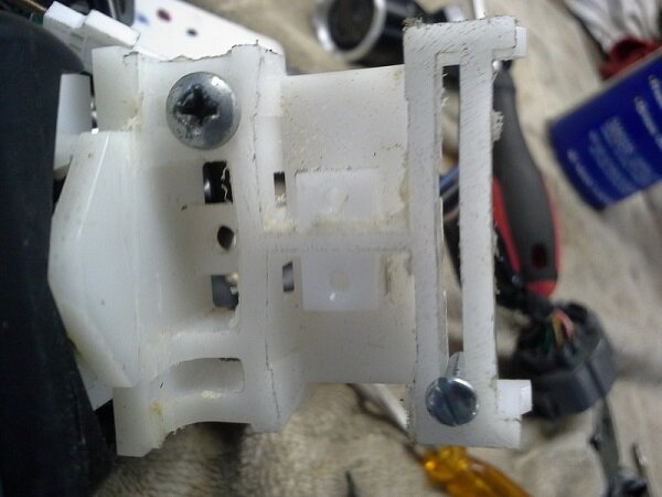

I didn’t find any loose connections, so I decided to reconnect just the LED unit to test it out. I discovered that I could ever so slightly twist the unit and all the segments would light. So somehow the unit was twisted in the housing.

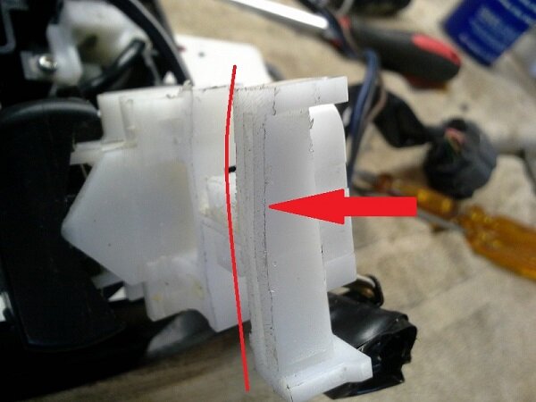

Upon further inspection, I noticed that the adjustment switch assembly that holds the LED unit in place was ground at an angle causing the LED unit to be twisted. Time and exposure to the natural elements probably caused it to be permanently misshapen.
I thought about buying a new LED, but over time without replacing the switch assembly, the same thing would happen. So I thought that if I could reshape the LED unit to a flat position, then maybe it would resolve the partial lighting of the display.
My solution was to insert tab screws to push down on the corners of the display unit to force it back into a flat position. It was trial and error to determine the right adjustments.
I put it all back together and wah-la, the results were satisfying.
I don't know how long this will last and I may have to go back in for adjustments.
But at least for now I have a method for a work around.
