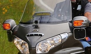

I used mine for the first time this weekend. I used the suction cup and mounted it on the center of my fairing just below the windshield. While riding I could see it being buffeted by the wind and upon playing the video, you can see the vibration in the movie.

As for using the suction cup mounted on the front, that is the only way I have ever used mine (have for maybe 15,000 miles of videoing) and it has always given me smooth video. On real rough roads it bounces some but not bad. Probably the difference between your RSV and my GL1800. Mounting to the fork tube or crash bar will give you a different view but the bounce will be even worse I'm sure.
