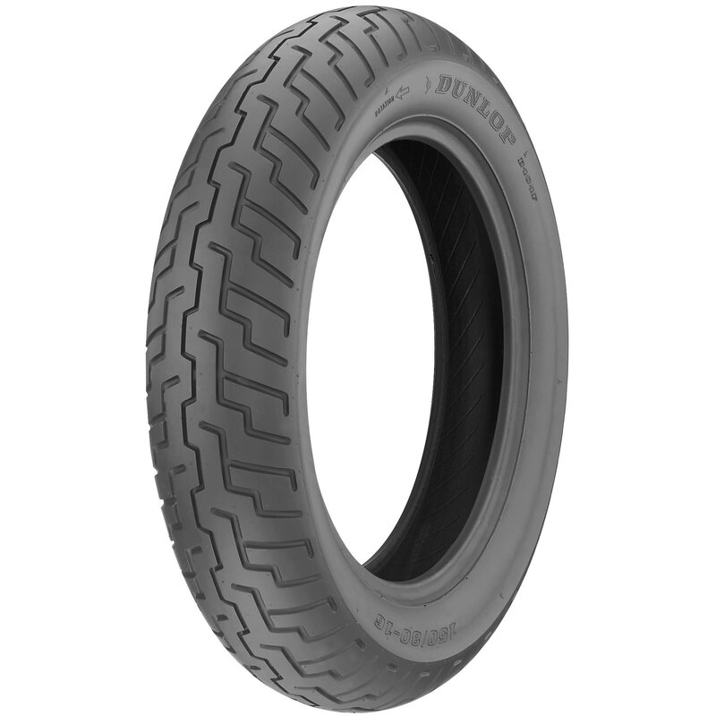

iv'e tried many types of tires on the front of my I/s trike. best tire iv'e had so far with little to no cupping and wear is great. is the shinko tour master. 130/90/17 I also only run 35 psi in it.
I also am running a 6 degree rake.
Every rear tire I could find in 17'' was smaller than the Valk OEM front tire. Messed up the speedometer more than it already is. LOL
I did as SolidBob suggested. I run the bias-ply Dunlop with good results. Stays balanced, very little noise & cupping. I wish they got better mileage, about 14K is what I get... aggressively riding.
