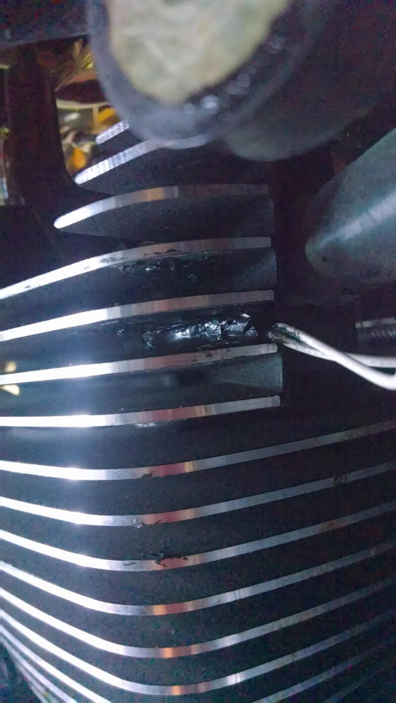

Dave I got the "creep switch" from Jayson & put it on the front head, left side, but put it into a pocket at the end of the fins just under the temp sensor. The switch is thinner & will lay down & fit into the small pocket.Then sealed down the wires with black RTV just to keep them from rubbing & to hide them inside the fin. It is a 105*c switch that seems to work VERY well so far. You can see a pocket in the fin just 1 lower to the front.
Not to hi-jack but......
Just my experience so far.View attachment 18692
Update: I have now installed the fans, and used this thermo switch position. It works great, the fans stay on when bike is turned off for about one minute or so depending on temp, but so far, have only cycled back on one additional time. I am really pleased with the performance of these fans. They are quiet enough I do not hear them at all while riding, and they keep the bike running much cooler. I can only monitor oil temp, but on a 65 deg day, oil temp only reached 200 where before fans the temp would have been easily 230 deg. Also as a note to those who ask if you feel hot air on right leg, no I can not say I even notice it. Love these fans, and finally, not concerned about engine temp causing problems / premature wear on my 103.
