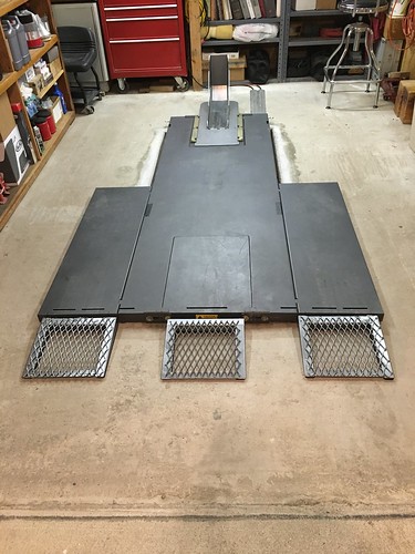

Here is a simple ramp arrangement I built and use regularly if I need to get under my trike.
Geez Jerry, that garage looks way too clean! I could only find 2, maybe 3, leaves that got in the door! ;)
I wish it was always that clean Jim. That photo was taken several years ago. A lot has changed. I now have a lift table planted in that space and shelves along one side. Still room for me and the trike but add one person and it gets crowded!! :laugh:
