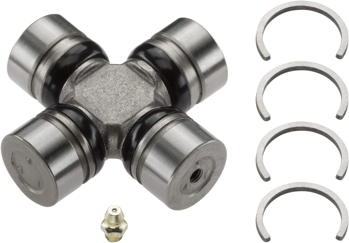

U joints don't need to be greased. They are sealed
Not all joints are sealed, Moog is one example of having grease fittings
