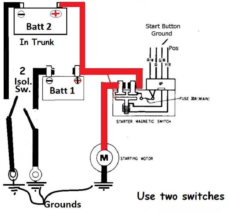

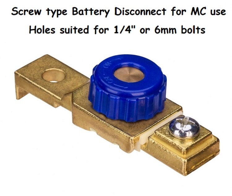

Anyway, I don't need another unused battery sitting on a shelf. I have portable power in a wheeled cart I built housing two Group 65 auto batteries, together they'll start a Cummins. Tonight I made my "holder" to go in the lower trunk of my Lehman to secure the extra battery. It's painted & drying as I type. My plan is to wire it using suitable cabling and a screw type battery disconnect on the negative side between it and "ground". I figure the Comp-U-Fire can keep up. These disconnects are small than those used in cars or trucks, more suited to use with 1/4" bolts.
Not because I need it, I just hate to see a good battery sit unused. This way, I'd at least have access to it if needed on the road. Anyway, just thought might be of interest. I have a couple of these disconnects, thinking I might put one to each battery. Such would maybe be handy when leaving it parked for long periods, like in winter if harsh. Batteries don't push current, but two will supply a plenty if needed.

If I use two disconnects, this how I'd do it. I might would put disconnects on POS (+) sides though, would work as well either way

Most two battery set ups have an isolator in between the battery's. This way if one battery 86's it won't take the other one with it...:Shrug:...
I know, but I'd just have it in place in case needed, and wired so I can charge it as I ride. I would not be leaving it connected … hence the disconnect.
I think you need one of those switches they use in boats and RVs. So you can use one battery or the other not both at the same time. I think the batteries have to charge separately because they're unbalanced?
It’s a A-B switch.
And I looked at some, but decided to leave OEM wiring in place. If I use two disconnects as described, I can easily enough choose a battery to run on … like if I want to run off the battery in trunk, just "connect" it with a twist of knob, then I can "disconnect" the trike's main battery at will with another twist of the other knob. If by chance I have a low battery at start up, I can use both, just as if jumping.

Well, I finished it. Works great as intended. I put a "disconnect device" on both battery's negative terminal. I tied the red positive cable into the trike's circuits by piggy backing on the main battery's POS. terminal, like a jump would do. The extra NEG cable went through trunk floor to be bolted to the trike frame for good ground. I used solder on lugs that I made of 5/16" copper tubing and 4 ga. wire I had on hand. I can chose which battery to use at will and I will have a spare on deck as backup as long as I keep it charged.
I did modify my "disconnects" in the interest of durability. They are made of an alloy with a brass finish. They have a blue molded knob on a 5mm brass bolt OEM. I removed that knob, found the 5mm threads were shallow, so I rethreaded the hole to a 6mm thread (still clears hole) and brought a bolt in from back side and then I could thread a nut … or home made steel "knob" onto what looks like a stud to close / open the device or circuit. This one I mounted on battery under seat as it will almost always be in use.
On the "extra" one in the trunk, I put a longer screw in through the threads from the front after spinning my self made steel knob all the way onto it, after threaded into device hole, backed it out about 1.5 turns and locked it in place using nut on backside. That way a spin of "knob" will disconnect circuit, but screw head prevents nut coming off.
I also removed the screw where wires attach, tapped it to 6mm as well and put a bolt through from back side and use a nut to attach cables with lugs.
Below is a revised drawing of the circuit I modded.
