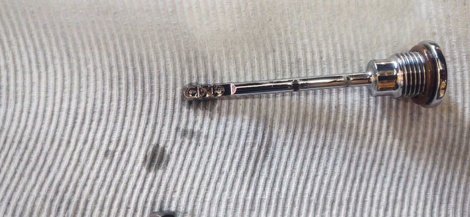

I pull the bright and shiny chrome dipstick with a tiny "X" in a bracket that I can't tell if there's oil on or not. The oil isn't dark enough to show on the chrome stick. What's the trick on determining the oil level in a '21 Freewheelers transmission?IMG_20240706_124817791.jpg
Try laying the dipstick down on a paper towel and see if the oil on the clean towel shows you the level.

Edit, I didn’t see the picture, I guess that’s what you were doing.
I took a piece of sandpaper and roughed up the Chrome on both sides of the stick. It does make it easier to read. You've got the shiny oil and the dull aluminum.
Hardware store had this small flame resistant blanket I used for sweating copper. Laid it over the dipstick and hit it with a pencil torch. Changed the color enough to read with lube on it. Don't go crazy with the heat.
