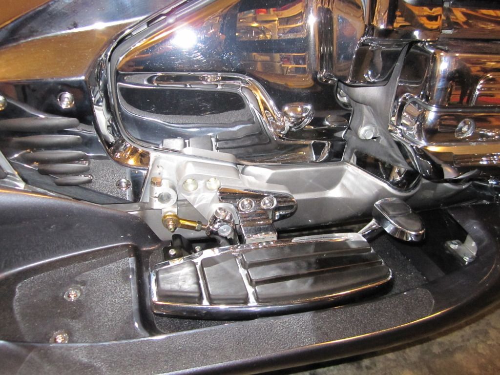

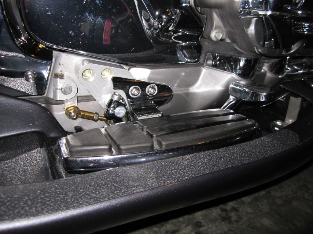

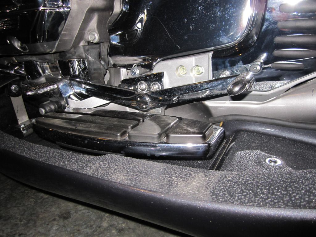

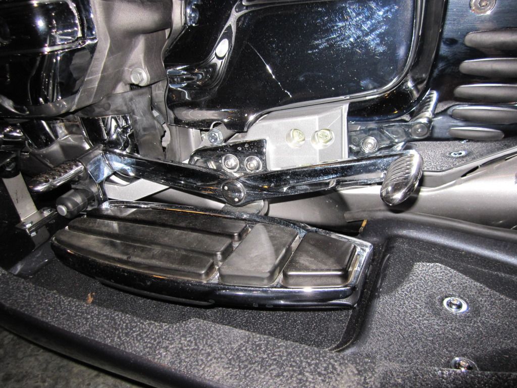

how about some pics of the roadsmith controls installed on your trike, would like to compare their positioning compared to what I got now.
Here's the pictures you requested.
At present, I've removed the floor boards and that annoying heel/toe shifter to give me even more room to stretch my legs.
You can clearly see where the original mounting points are.

I never understood all the complaints about heel toe shifters from the wig guys until I saw those pics. My heel pads on both my Vol and the VTX are just behind the floorboard and only 1" higher than the board. I love them.
