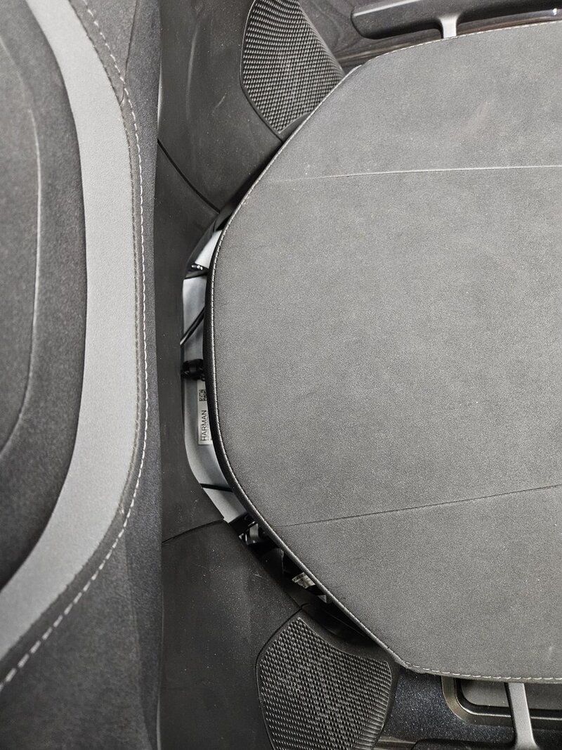

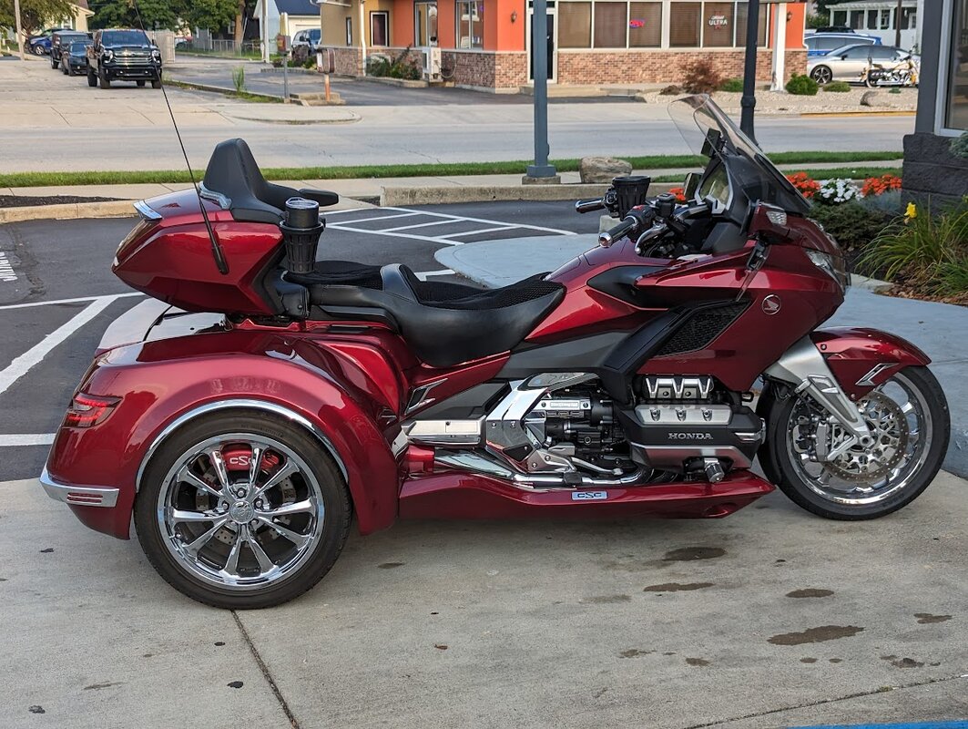

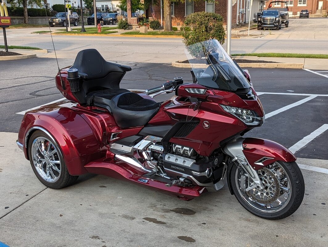

It will work, but... I installed the Kury kit on my 2019 to move the truck back for more room for my "bigger" girlfriend. It gives a decent amount of room but there is a "cushion" that slips in between the seat and the backrest and it looks a little goofy. If you look close you can see it in these pictures. Girlfriend loved it, me not so much...PXL_20230819_225217697.jpgPXL_20230819_225158310.jpg
How secure is the trunk afterwards? Any shaking? Did you have to fabricate anything to make it work?
No fab work needed but it is a little fiddley to make it all fit. There is a plastic extension that fits under the trunk and it didn't work well with the CSC trike body so I just left it off, you could hardly notice unless you knew what you were looking at. I never noticed any shaking of the trunk any more than it did before?
