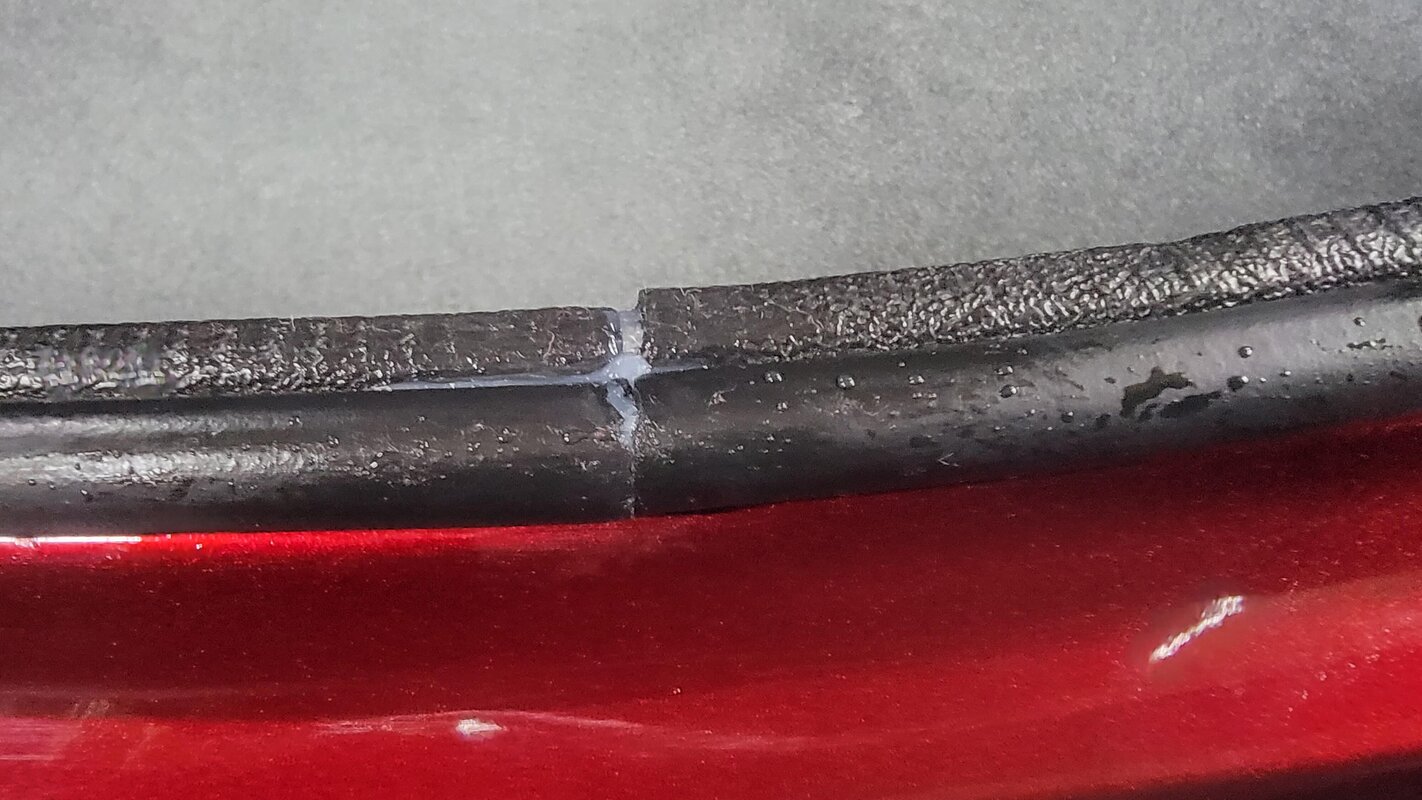

The joint where the rubber meets is the spot my lower trunk was getting wet. I just silicone the joint together and put some inside the opening. took off the excess and closed the door so it be formed shut whendried. It had a puddle of water on the bottom letting it leak inside. the top would've keep the water running off. No I'll see if this works in the real world, garden hose it did.20230819_153613.jpg
