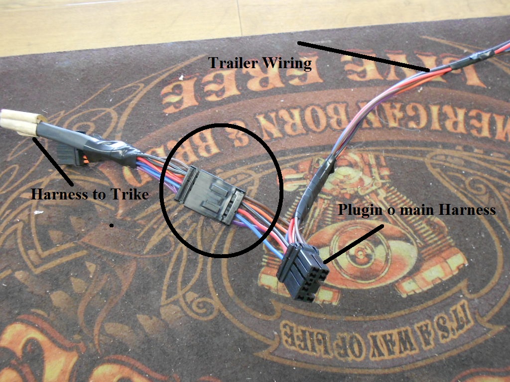

James, you should be able to make this harness and plug into your existing harness.
Unplug trike harness and check signals from running lights (blue & orange), brake lights (red), turn signals (brown & purple) upon application. If you get signals from all of these, this set up should work for a 5-6 wire trailer.
