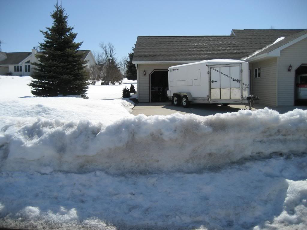

I use my enclosed 7 x 20 ft snowmobile trailer to haul mine.
It has a drop rear door on it so I can drive it in.
Once in, it's tied down and ready to go.
Also holds my cargo trailer if I want to take that.
I would never trailer it on a open trailer.
To much junk can fly up and hit it.
I pull it with my Chev crew cab truck that has the 6.0 engine and trailer package

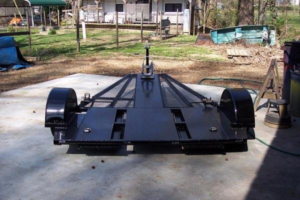

many states no plates required.

I have a RV tow dolly when I want to pull my trike , unbolt the center arm , bolt in a extension bolt on top rail and wah lah there it is ,,,works great pulls better with the extension over the tow dolly .
