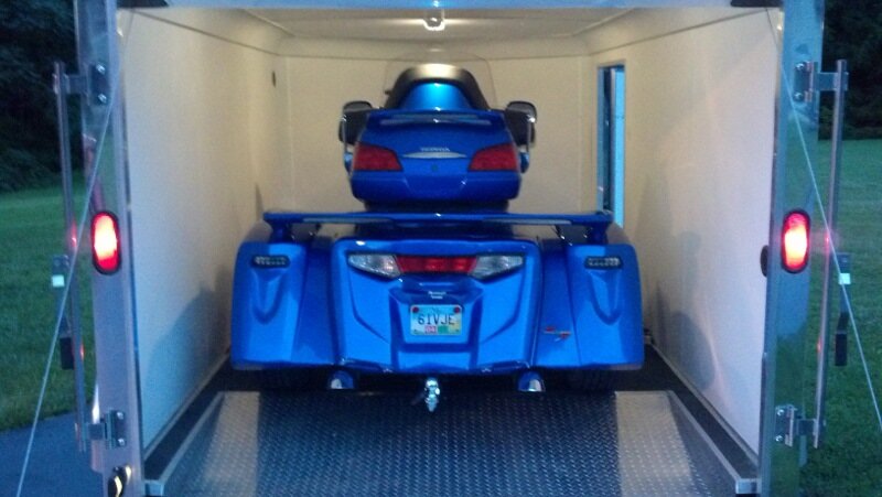

This is my 2012 Hannigan in a 7x12 Haulmark V-nose low hauler.
Here is my 7x12 wedgenose for my 2012 Hannigan - - - Updated - - - Sorry, I mess up

How did you get it in sideways?? That would save on trailer width!
(Snicker,Snicker) You know someone had to start the smart alec comments!

You need the 7 x 12 because of the width of the trikes. The rear door is big enough. I have a Roadsmith and just bought A Wells Cargo for $4000 V-NOSE

LOL Well, you just need as extra long ramp that slowly angels to about 90 degrees. If you go slow enough the trike doesn't know to fall over and go boom. It's really that simple. OR, it could be that I screwed up the picture when I was trying to load it.

Have a 6x12 Pace American trailer. Have hauled both a Yamaha (Hannigan trike) and a Goldwing (Roadsmith trike). Door width is 66 inches so I have about 3 inches of side clearance. Not much room at the back of the trike, but there is some room up front for a few extras. Taller isn't better (except when you are in the trailer) as gas mileage suffers with the extra height. If buying again would get 6.5 or 7 wide 12 long tandem axle with brakes. Emergency stops can be frightening..<img src="images/smilies/AGGGH.gif" border="0" alt="" title="AGGHH" class="inlineimg" />
No matter what you are pulling or what you are pulling with electric brakes are important. When I ordered my trailer I was pleased to learn that the electric brakes were only an extra $50.00. I did need to purchase a brake controller but found one that was almost new for $50.00. My 7x 12 gives me room to walk around the bike while it is in the trailer. I wouldn't feel too comfortable with only a couple of inches, or even 3 from the wall. Scratching up a fender can lead to an expensive repair bill. I didn't want to tandem because of the extra weight and tire life is greatly reduced.
Have a 6x12 Pace American trailer. Have hauled both a Yamaha (Hannigan trike) and a Goldwing (Roadsmith trike). Door width is 66 inches so I have about 3 inches of side clearance. Not much room at the back of the trike, but there is some room up front for a few extras. Taller isn't better (except when you are in the trailer) as gas mileage suffers with the extra height. If buying again would get 6.5 or 7 wide 12 long tandem axle with brakes. Emergency stops can be frightening..:AGGHH:
