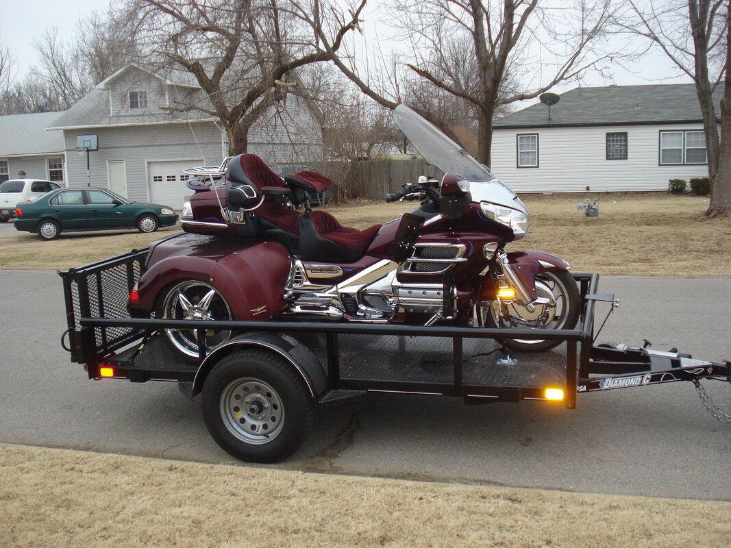

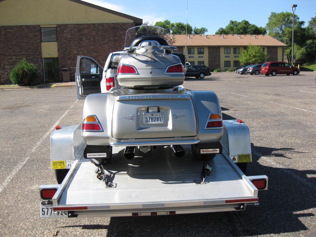

I haul my 06 Roadsmith trike with a 10' open trailer. I use a couple of soft ties around the lower triple tree and secure them to ratchet straps that connect to "D" rings in the trailer bed. On the rear I use a couple of ratchet straps that connect to the draw bar in the trailer hitch and secure the other end to the side trailer rails, locating the straps to provide a forward pull when tightened. I don't use a wheel chock but using one would be useful. I secure my front wheel to the front of the trailer frame using straps or rope. All of the straps I use on the trike are secured to provide a forward "pull" on the trike which keeps it snugged up against the front trailer rail.
DO NOT use the engine guards as tie down locations!
I finally found a pic of my Roadsmith trike on my trailer. It's a 5'X10' open trailer. I had to make a short draw bar for the trailer hitch, as the standard one was too long.

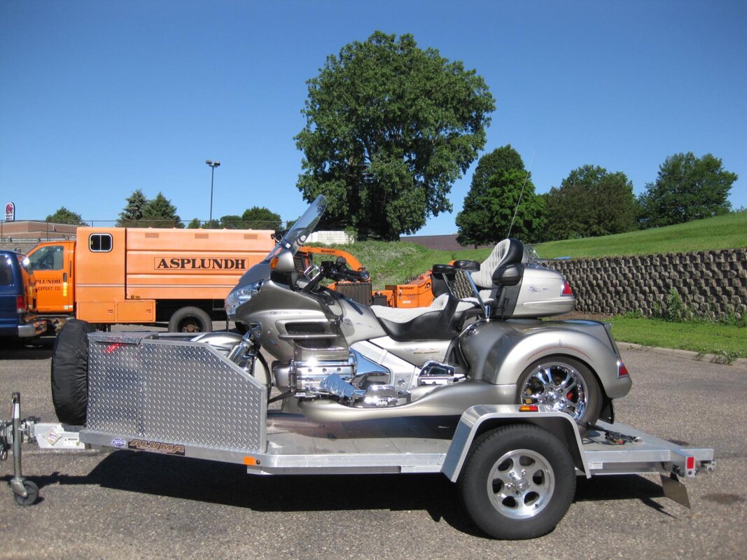

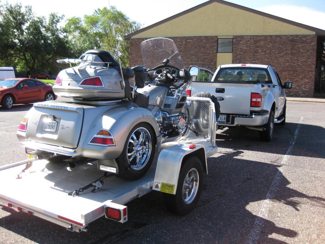

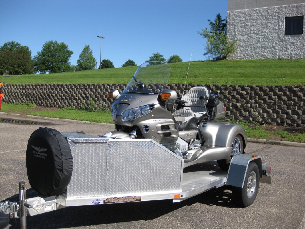

Never had damage and I also use it for my mowers and hauling appliances or a couch.... yes on the chock....

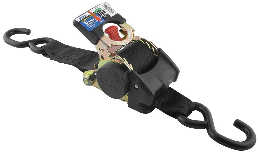

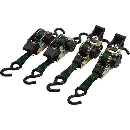

Additional to my PM these are not normal ratchet straps.... they are Push Button adjustable and much easier to use..... some what hard to explain but I have replaced all my old straps with these....
