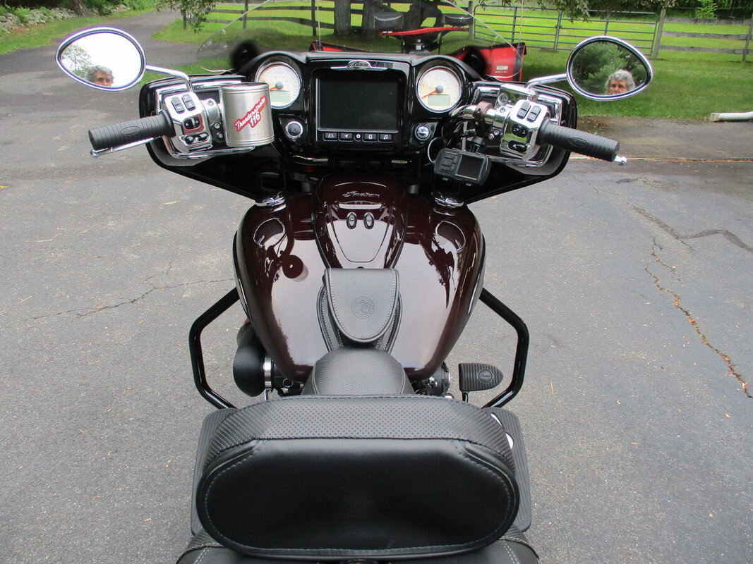

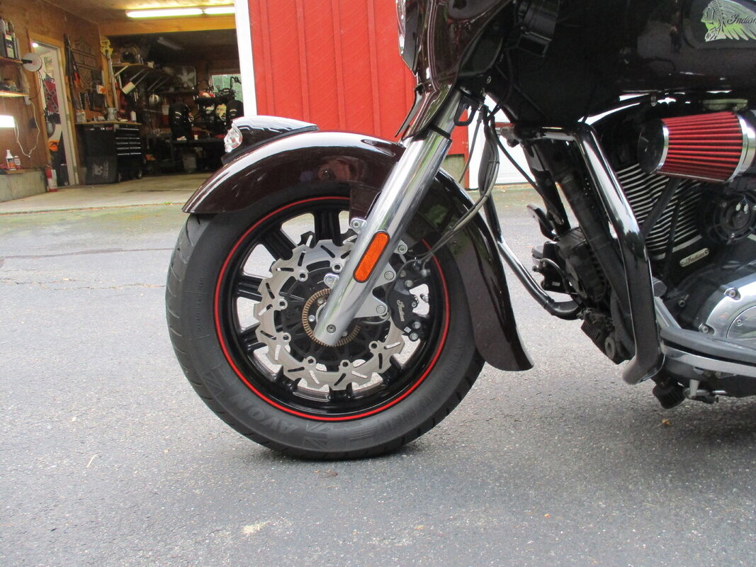

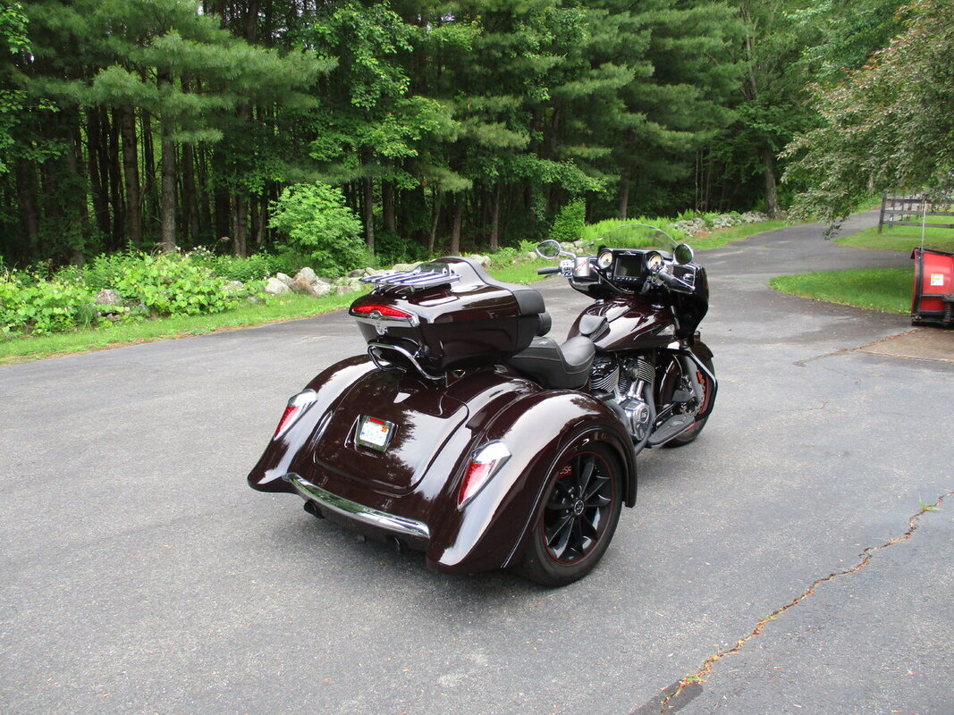

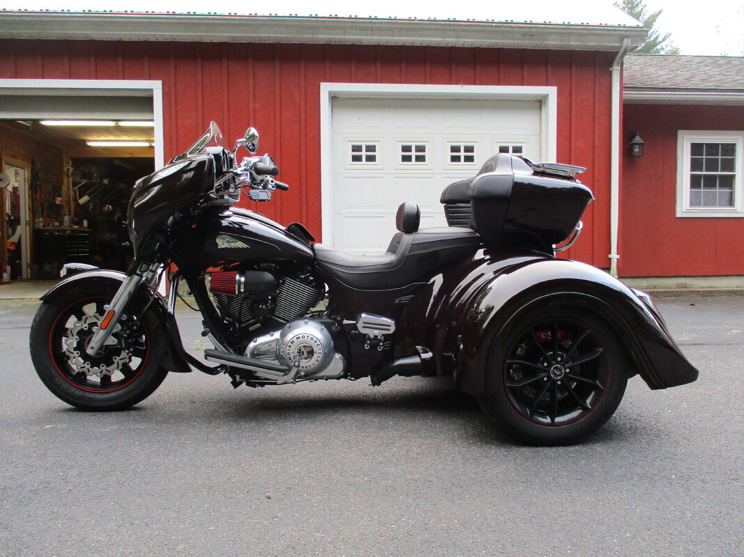

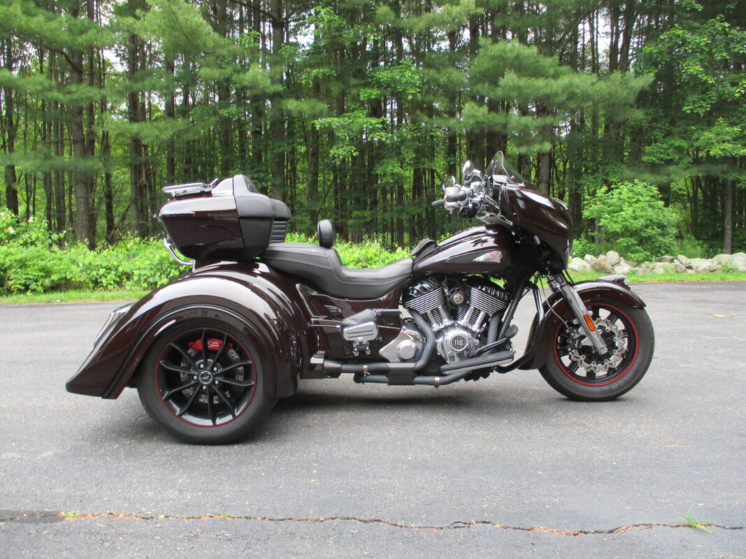

I got my Indian Roadmaster CSC trike Back together A few weeks ago, the weather has gotten better to ride, there's not much I did not change, complete repaint color change, replaced rear shock with Bilstein shock different valving, put the standard sway in it, added a CSC emergency brake, Changed the exhaust put a Rinehart true dual on it, changed the air intake, ported the heads, MSD coil, new tune, replaced my burned out rear light bar, new Galfer front brake rotors, EBC front brake pads, flushed the brake fluid. I liked my trike before, But OMFG Its a different trike Handles so much better, my brakes are so much better, way more power, A real Blast to ride. with the bigger sway bar it does not roll in the corners, Im running 26 pounds of air in the rear tires. I got to wash it after putting 900 miles on it in 3 rides, & post some pictures.

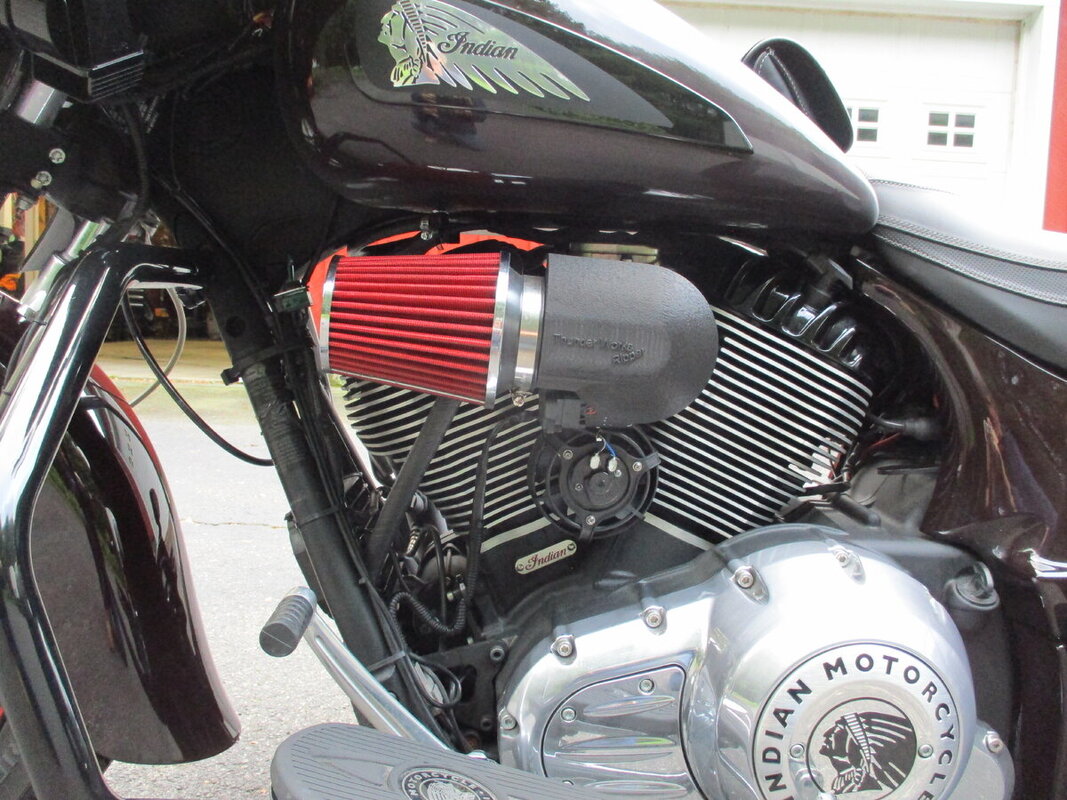

That's my 7-gallon gas tank; it was 5.5. The color looks black in the shade, dark maroon in the light, kinda of a bright red in the direct sunlight. I got an Avon 140/80/17 road rider tire on the tire; it can be mounted on the front or rear. Indians run really hot, I put three cooling fans on it, removed all the heat shields, took the upper valve covers drilled 25 5/8 holes in the top of each one, the coil & a bunch of other stuff mounts in between the cylinders, I moved the coil to under the seat mounted the horns to the inner fairing, it runs about 30 degrees cooler now. Galfer front rotors, EBC pads, new shock, and sway bar. Went out Sunday, 346 miles, averaged 41 MPG.
Do you have any pictures of the mods you made? I'd like to see how you made the Rinehart TruDuals fit within CSC's a-arms and CV axles..?
