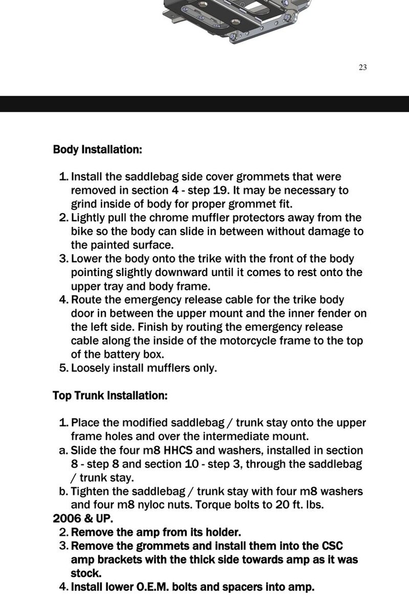

And I just confirmed the Cobra emergency release cable. It is listed in the installation instructions. (Look at #4 in screenshot)
