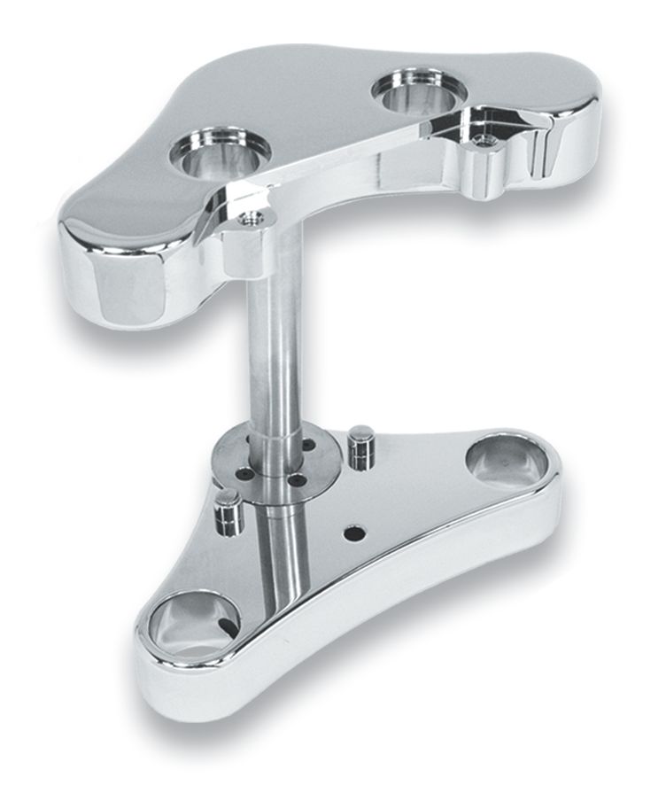

Just a heads up for you Sportster/Dyna Narrow Owners. I've just added a line of beautiful raked Sportster/Dyna Trees and running a special of $399 on the plain trees right now, members only. The Chromed and Show Polished trees are more. All are top quality trees same as pictured and are thicker and stronger than most, have the hidden pinch bolt system VS the ugly cuts, radiused edges and no fork tube holes in the top to keep them clean and smooth looking. These have a one year manufacture's warranty and are 100% USA made, same as all my other raked trees. All years models available.
Chrome Tree Shown - Polished Ones Look As Good
PM or Call me for details.
