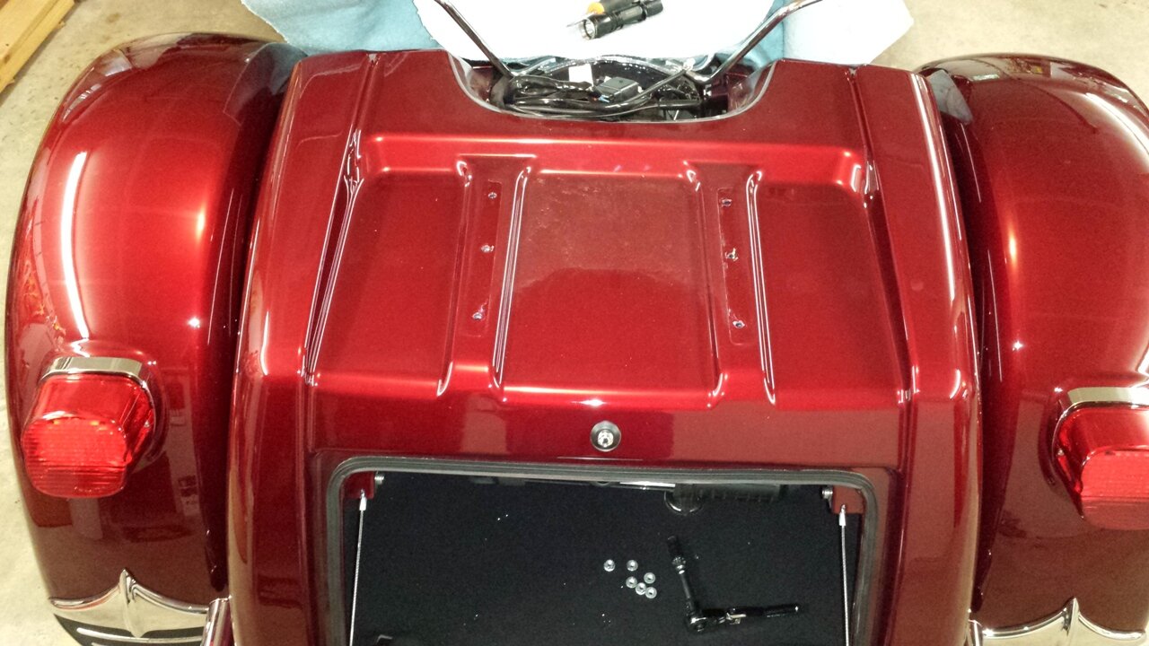

Ok, i have a 2004 fatboy with a champion conversion kit installed, LOVE THIS RIDE, i am looking at putting a tri-glide touring pak trunk onit for the comfort of my wife who just had spine a operation..... anyone know what hassles or problems with putting a tri glide touring pak on my trike?????? are there kits to convert?????? am i barking up the wrong tree???? please help my baby ride with me again....... thanks for your help....jake

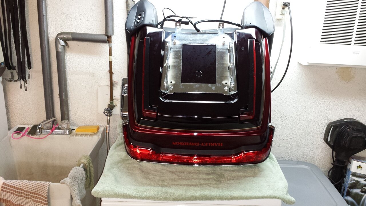

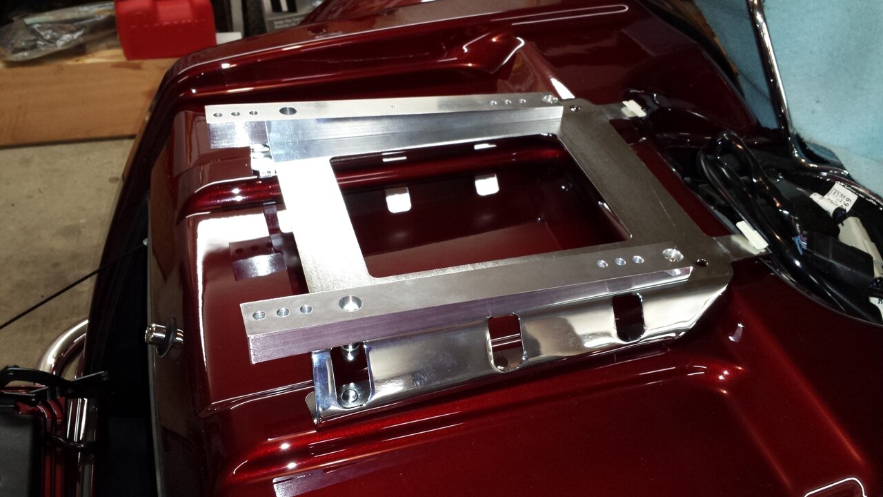

If Champion can not help you ..... If it were mine .... I would buy the tour pak I wanted and find a machine shop to make you a custom mount.
FWIW the 2014 NEW DESIGN Tour Pak mounting studs are 2 each on 8" centers at the front and 2 each on 8.5" centers at the rear.
Sorry I do not know the front to back distance off hand.
Classic Harley in Leesport PA has a used area with many tour paks and different mounts. Maybe you have a Dealer near you with similar used/swap section .... or go to some swap meets.
