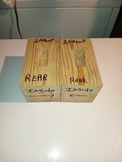

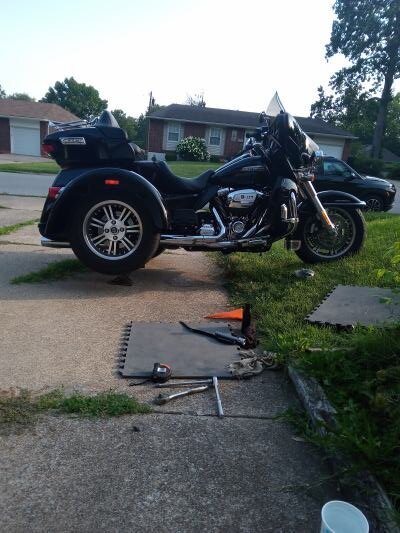

I decided to make the lifting blocks that I had seen in a video on here. Went up and bought a 4x4 came home and cut out the notchs in the center for the tow hooks. Rode the front tire of the trike up on a terrace, used a scissor jack to lift the right tire 6" off the ground using the right lift block. Opened the bottle and filled it to the line with anti-freeze. Removed the radiator cap and filled the hose with anti-freeze, activated the fans and pump.
The coolant sucked into the hose. Shut the trike off and refilled the hose, activated the fans and pump again only the coolant didn't suck into the hose. Shut the trike off and removed the cover for the pump and then reactivated the fans and pump but the coolant still didn't get sucked into the hose. Felt the pump and it was not running. Tried it several more times and the pump refused to run.
I believe my pump is intermittent and that's why its overheating. So I put the trike back together and rode it into the garage. Gonna wait till my appointment with the dealers service department and see what they say. On the positive note the trike lifting block worked great and was not that hard to make. Now I have the confidence to lift the rear wheels on my trike if ever needed. Thanks again for everyone's help.
