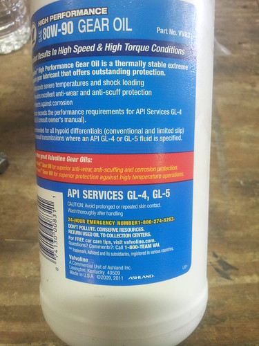

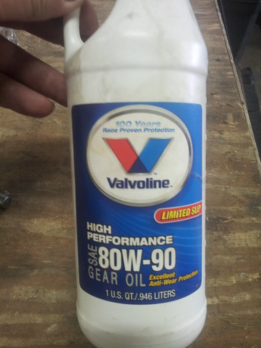

So.... I use .
It is rated for both. That means it passes the test for both grades.
That’s what I used…. Just like regular gear oil from the past. Non of that new fancy slick stuff. Not only for the corrosion issue, it needs to stick to the gears and parts. I also use Traveller brand oil from Tractor Supply in the crankcase. It’s like oil right out of the 1970’s.
