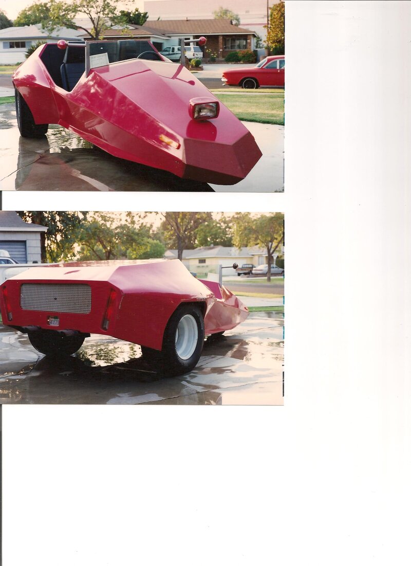

I went with the IRS for easy adjustment in the rear height area and it kept the wheels verticalTrike and sides.jpg.
