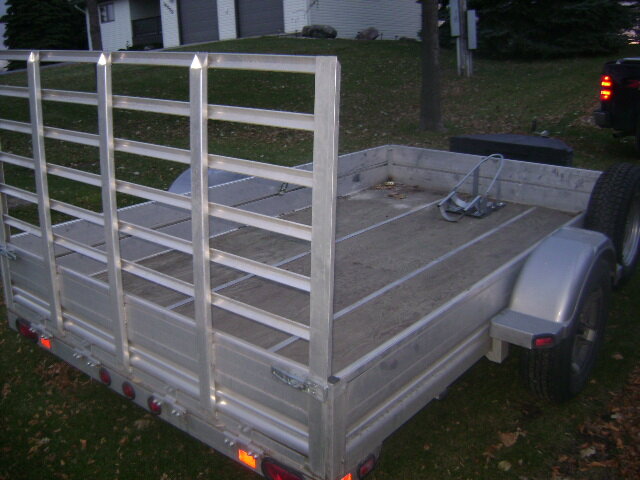

I hauled my GL 1800 from North Dakota to Arizona a year ago. I put a wheel chock on my trailer that goes over center when the front wheel goes into it and that holds the front wheel in quite well. I used ratchet straps hooked to the engine crash bars off to D-rings in the front corners just to secure it at the front without putting a lot of pressure on the front shocks and then put ratchet straps from the safety chain loops on the trailer hitch to D-rings in the rear corners of the trailer. I've had no problems trailering that way. I'm attaching a picture of the trailer with the wheel chock in it.

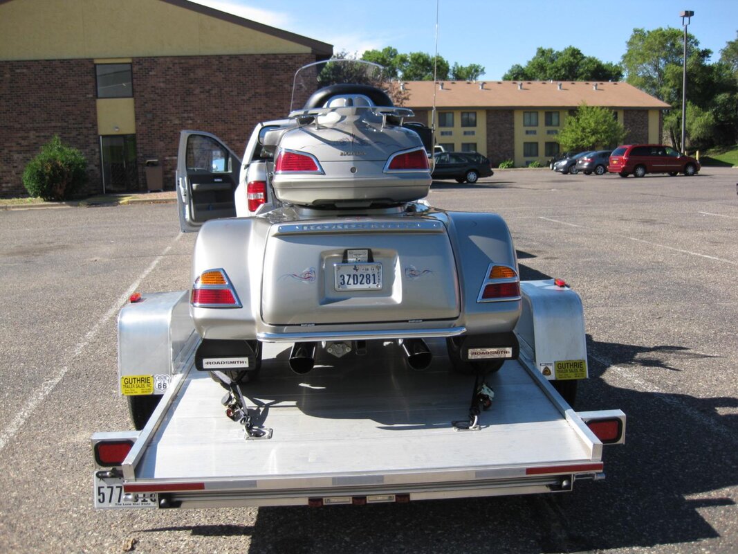

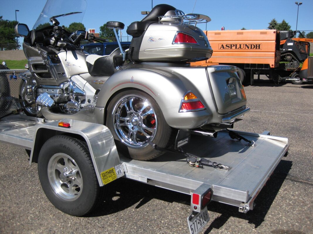

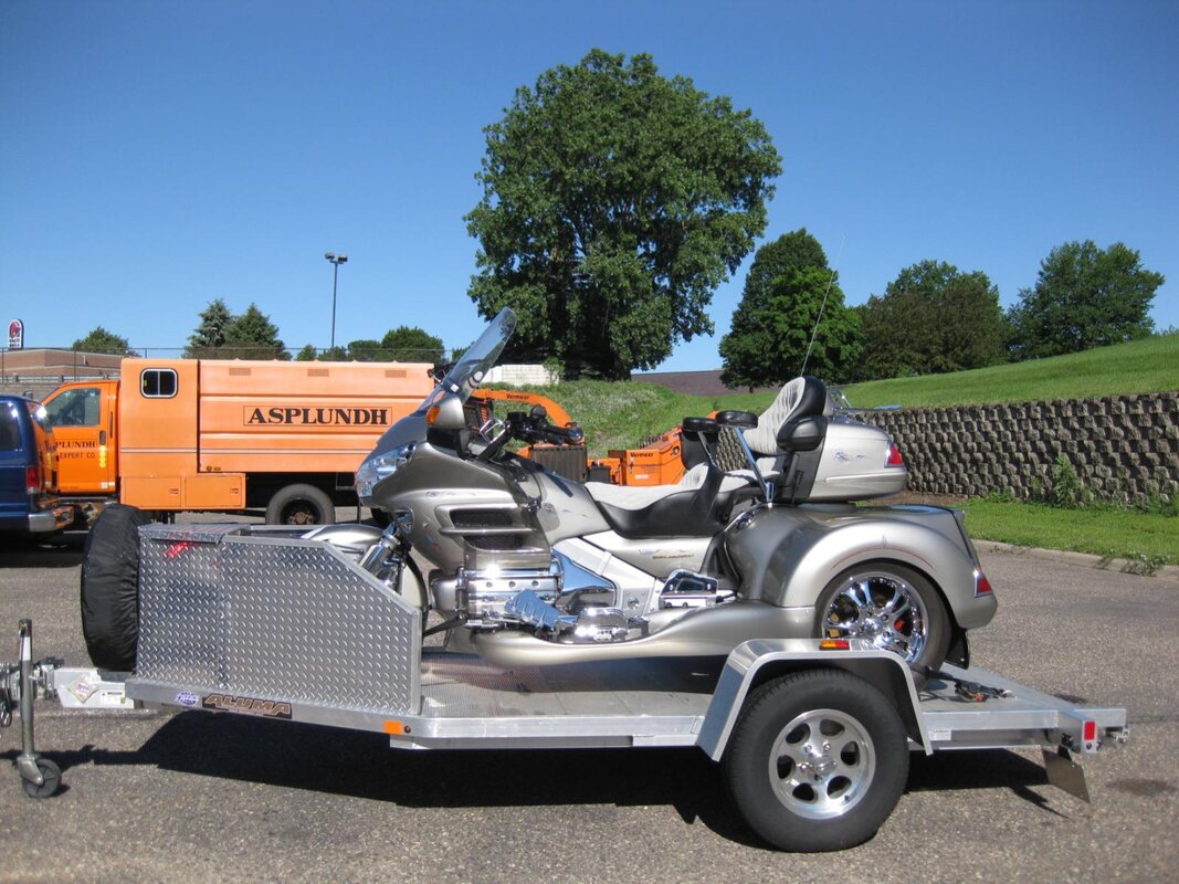

Same here never a problem on the crash bar and nylon wraps with tie downs on the rear. I also tie the front wheel and tire to the chock so nothing goes anywhere.....

That looks like an Aluma TK1. Is it? Can you load your trike on it without bottoming out or shimming the ramp? My Roadsmith has an 80" wheelbase and is 113" total. (I haven't actually measured it but that's what their website says) I think that's about the longest kit made. The wheels are actually behind the passenger seat. Makes for a comfortable ride but can't load it on my 4' ramp without causing damage. That's why I'm looking at the portable ramp. It looks like you don't bother tieing down the handlebars. Is that true?
That is the TK1, just drive it on as it has a small dovetail area to lessen the angle. Not even close to bottoming on the glass body.... if there is a chance of that crank the nose up a little to change the angle, I just don't try to lift the truck much. But that's only occurred once....still no problem. That is my Roadsmith on the trailer, I only tie down the front wheel in the chock, from the crash bars to the forward tie down loops and then each rear tire as I show with the nylon 18" straps thru and around the wheel and tire. Never tie to the forks or the bars..... the way I tie it never moves although if it pouring the straps may need and extra crank due to stretch.... the straps I use are Retractable Automatic :http://www.homedepot.com/p/Erickson...Downs-2-Pack-34415/202563733?N=5yc1vZc2dnZ92e and they work great, takes me longer to tie wrap the front tire than all (4) of the tie downs..... 10 - 15 minute tops from driving it on the trailer / tieing it down and ready to depart....
