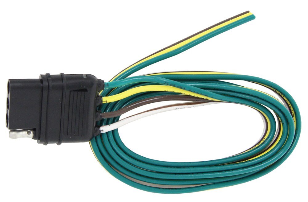

Just ordered my hitch from open road outfitters. now just have to figure out what harness I need. My trailer has a flat 4 pin connector, but it has 5 wires going to it.
What brand of trailer is it and can you post a picture of your flat 4 plug? The only flat 4 plugs I've seen with 5 wires had a double (white) ground going to them.
Ok, I'm not familiar with Diamond trailers so lets try this. Does your Trailer Plug look like this? A Flat 4 will have 3 female ports and 1 male plug (that's as close as I can describe it :)) but it can have 2 wires going to 1 of the positions on the plug, most often the white (ground) or brown (running lights).
Yep it looks just like that one.
Then you need the 4 wire kit for you bike. I'm using components from this co. http://electricalconnection.com/index.php?route=common/home.
I suggest that you call them and tell them what you are trying to do and let them tell you which of their components you will need. IF you are not accostumed to doing this type of work you might want to find a shop to do it for you. The Canbus system will not like anything other than an isolated trailer wiring package, you can't just go cutting and splicing as you might have in the past.
