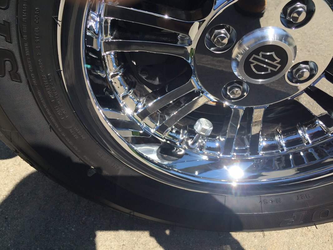

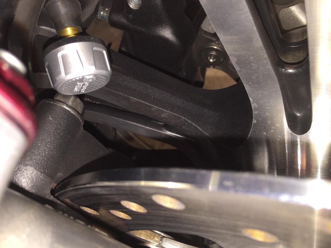

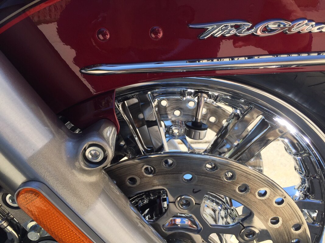

I have been using the FOBO system on my 16 TGU for about a year. I have been pleased with them and found them to be pretty accurate when compared to a high quality air gauge I own. I can tell you that the FOBO will not work on the front TGU wheel with the stock air stems. The FOBO will not clear the right side caliper. Also, it is recommended to use metal valve stems when adding these units. Some people stay with the rubber valve stems, but you better keep an eye on them.
I had my TGU wheels chromed by Sport Chrome and when I mounted my tires on the chrome rims I used Chrome metal valve stems. If you get a metal 90 degree stem and turn it "in" toward the center of the rim, it will clear the right side caliper as well as the left side. I used the type that mount on the inside with a nut. The second pic is a rear tire with the same 90 degree valve just to get it a little farther away from the road.
PS...sorry for the large pics, should have resized them I guess. Also, the third pic is the front wheel before being chromed and with the stock valve stem. You can see the FOBO will hit the caliper and destroy it and the stem most likely.

Thank you for the response & definitely the pics - they really helped me understand the clearance issue & how you mounted the stems. FWIW, I would not even consider running any external stem mounted sensor on a rubber valve stem - it would have to be metal.
Is it difficult to add air to the front tire with the valve positioned in that manner? I can imagine in your own garage you might be able to experiment with different air hose chuck set ups to find something that gets in there easily, but would it be hard to reach with the hose at the gas station when away from home?

Kevinch, I don't have any problem with the front or rear tires when using my shop air hose. I roll the front tire forward or backward to get the end of the stem at about the 1 to 1:30 position.
I put a nice padded mat on the floor kneel down with my knees on the mat. I bring the end of the air hose chuck in from the left side between the same spokes that the FOBO is mounted between on the right side, then I hold the FOBO valve stem with my left hand and press the chuck on the valve stem to add air. I hold the stem to keep it from accidentally moving when I press the air chuck on it
If you will notice, the HD rims have the valve stem mounted on rims in an area that is "slanted", not a flat surface. The post above shows the "T" type that lets you add air from the side without taking the FOBO off. I have no experience with it, but it appears that it would be hard to use on the front tire without hitting the right side caliper.
The rear tires are actually a little harder to air up. I can still get the end of my air hose chuck (even with the 1/4 inch quick connect on it) in at an angle enough to add air.
