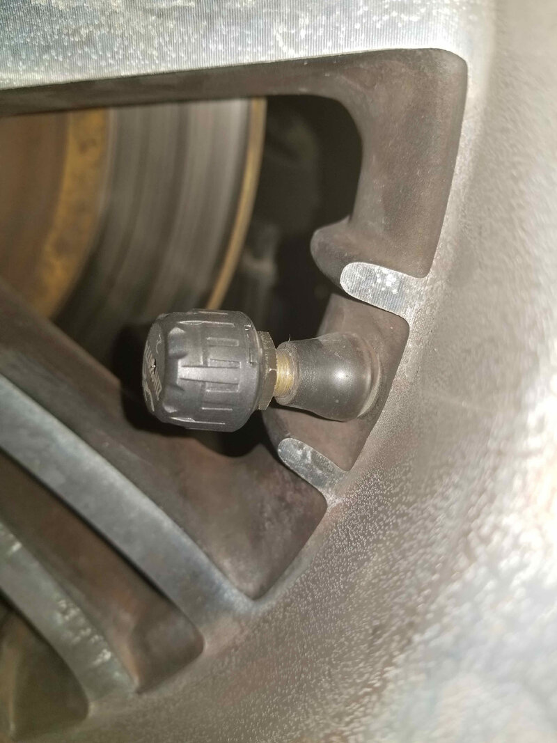

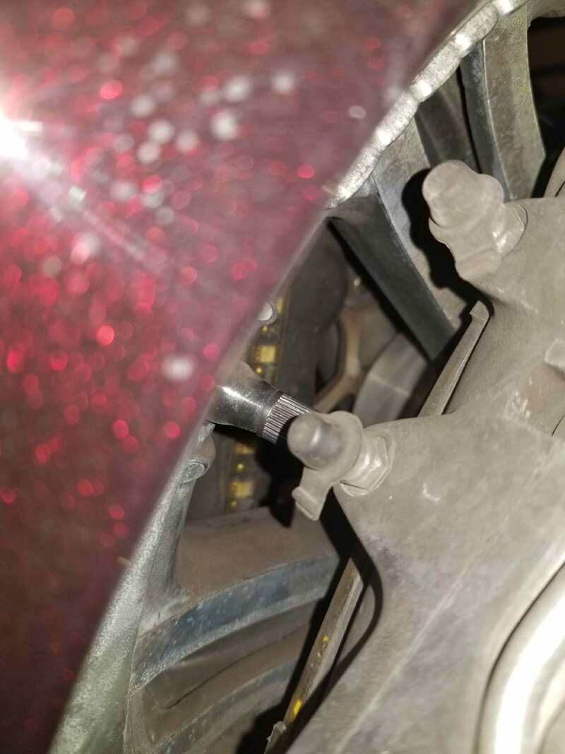

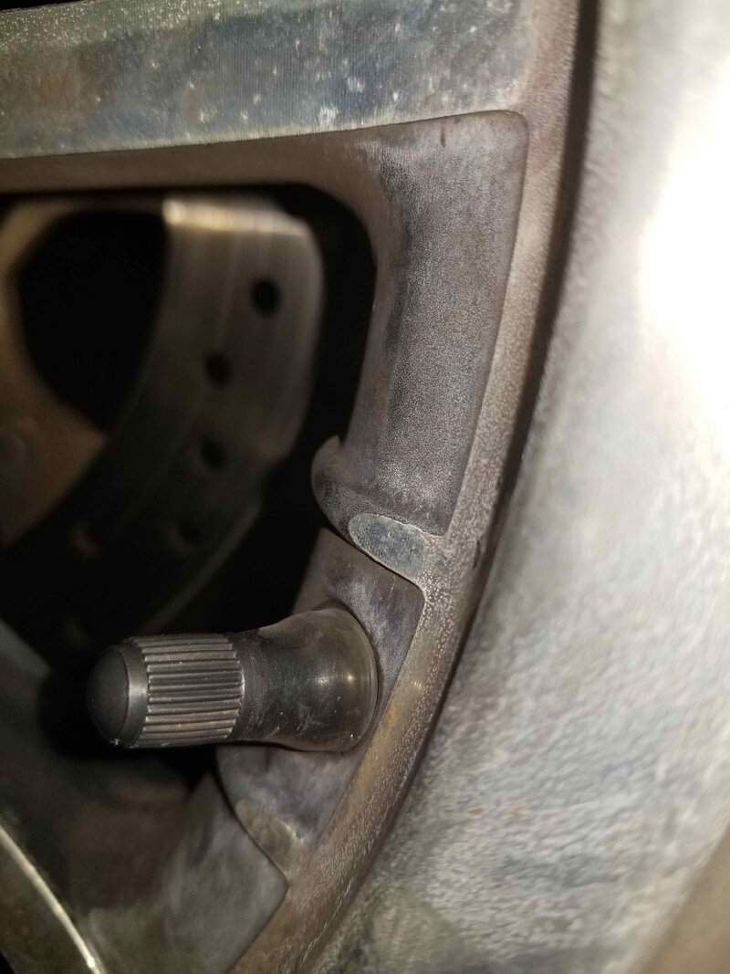

Yeah here's some more info and pics. The one pic I forgot is that there is a monitor that I mounted on my bars and the monitor is what pings the three tire sensors and gives me a display of tire pressure, tire temp, and any warnings I have configured.
As the pics show, there is very little clearance on my '14 Tri-Glide between the valve stem cap and parts of the brake caliper assembly. So you can imagine that when the tire sensor is on the valve stem, it's just bigger enough that it is hitting against that caliper assembly. When I had the sensor on, and manually rotated the tire, I could see it hitting just a bit against the caliper assembly. So I'm guessing that's why both the sensor and its little locking nut both disappeared mid-ride.
Other than this issue, I am pleased with the TPMS system. You can also get internal vs external sensors, but this requires that you take off the wheel and tire and replace the valve stem needle stuff which is a lot more work than just screwing on the external sensors.
I will still research if I can get a slightly shorter valve stem for the front tire- that would likely solve this issue for me.
