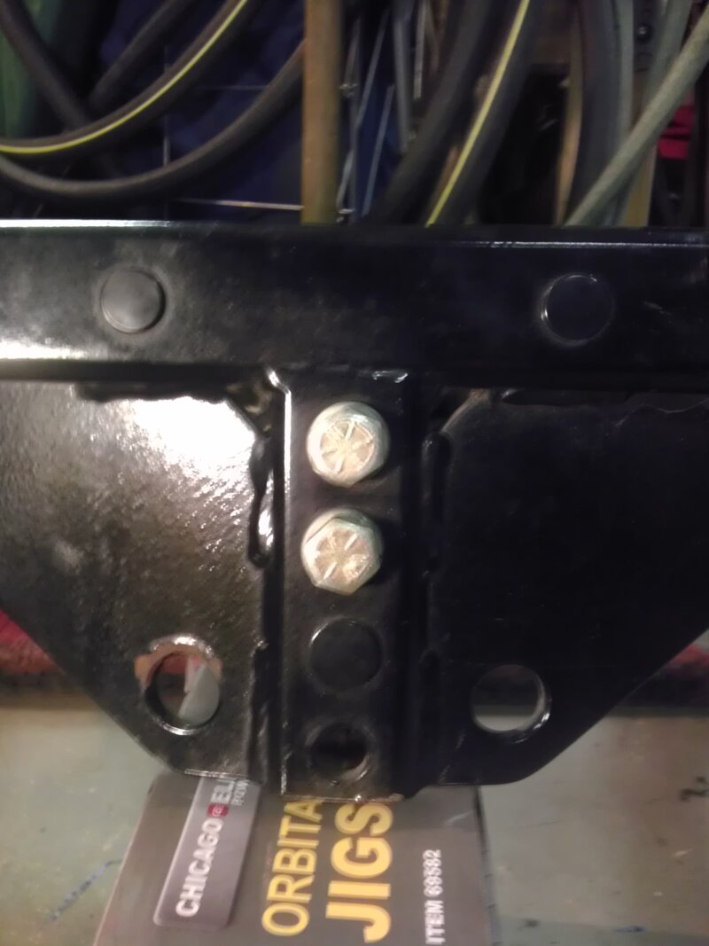

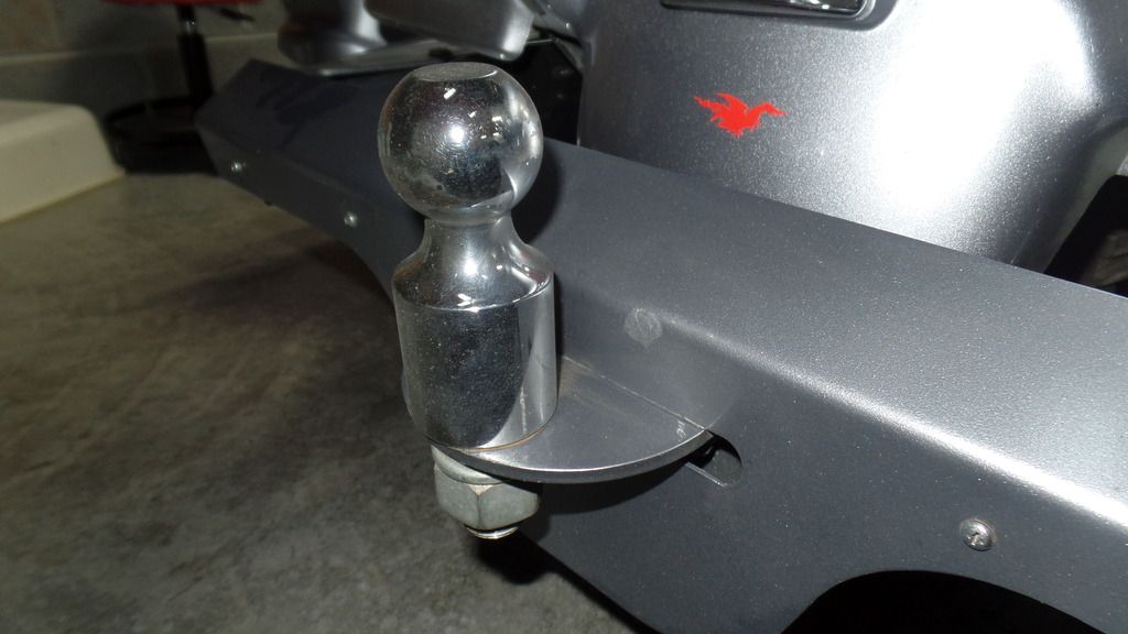

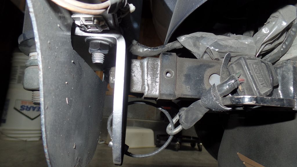

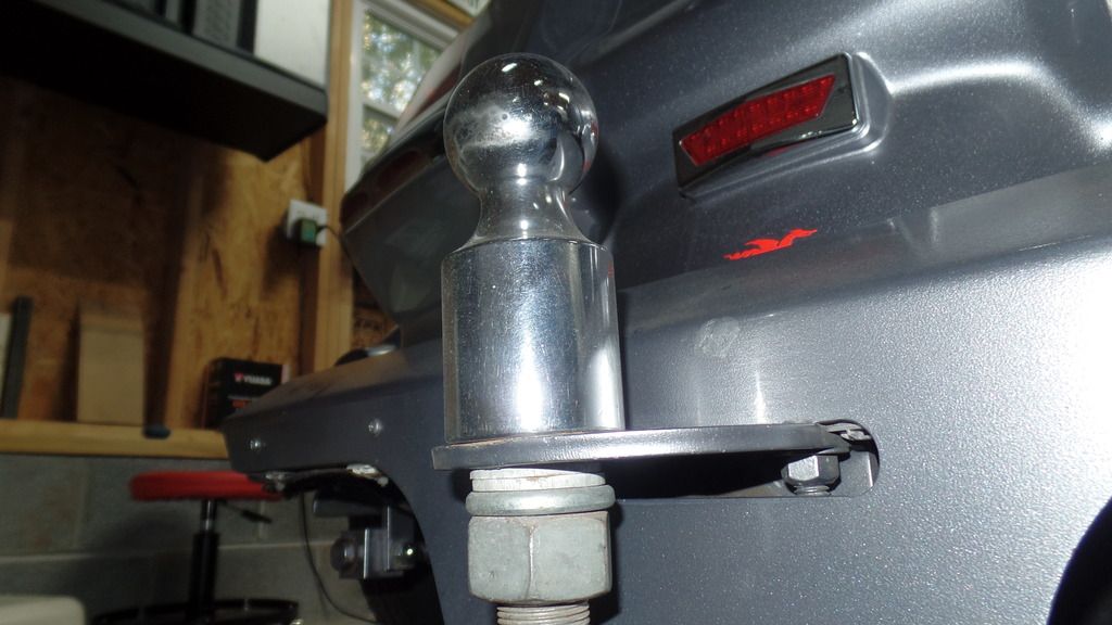

OK John,
Here are the photos of the ball mount... The mount itself appears to be a circle of 1/4" plate steel bent in half and then mounted to the trike cart...
There are three mounting points... One mounting point goes into the stinger of the hitch, and the other two are thru the cart frame... See attached photos...
The ball mount on my Tow Pac also serves as the attach point for the safety lanyard that attaches to the receiver with a steel wire lop and carbiner...
Les
Good deal John - shouldn't be too hard to fabricate a mount... Like I said before, the toughest part is going to be locating and bending the 1/4 \" plate steel... E Bay is a good source for steel plate...

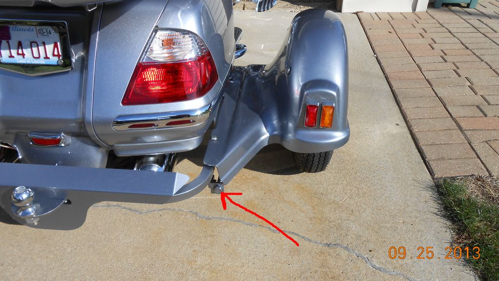

Anyway, you'll have to post some pictures soon when you get it all together... I just removed mine for a while and have been putting around on 2 wheels again - one of the reasons I like the Tow Pac so much... Think I might make a small mod and permanently bolt the lean stop braces in place with a second bolt... There is a hole in the frame bracket for that and mine haven't changed adjustment in many miles now so I might just do that... You can just barely see it in the photo below...

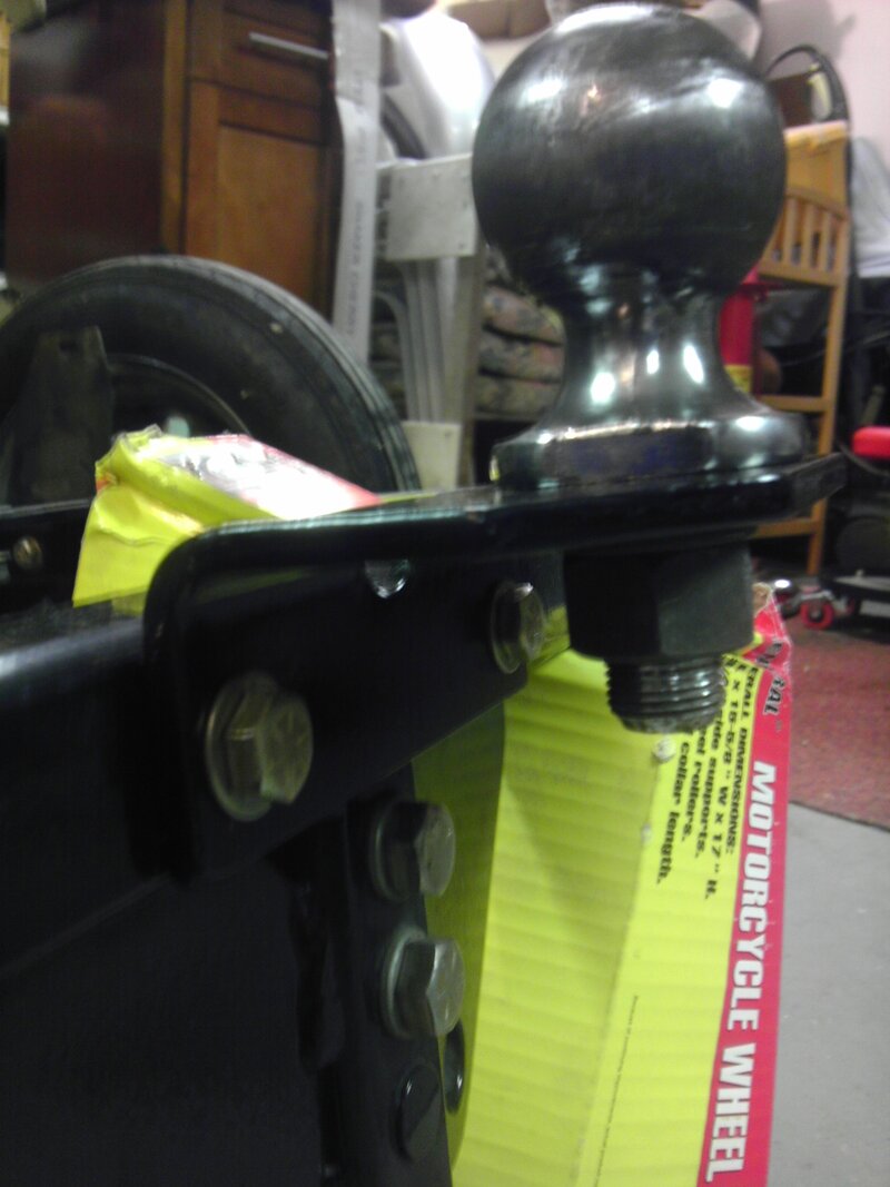

Here's my new hitch now added. Turns out an Insta-Trike made in 2005 has only half of the attachment brackets and points the same as one made in 2012. Most everything is different even though they are both made for the same years GoldWings.

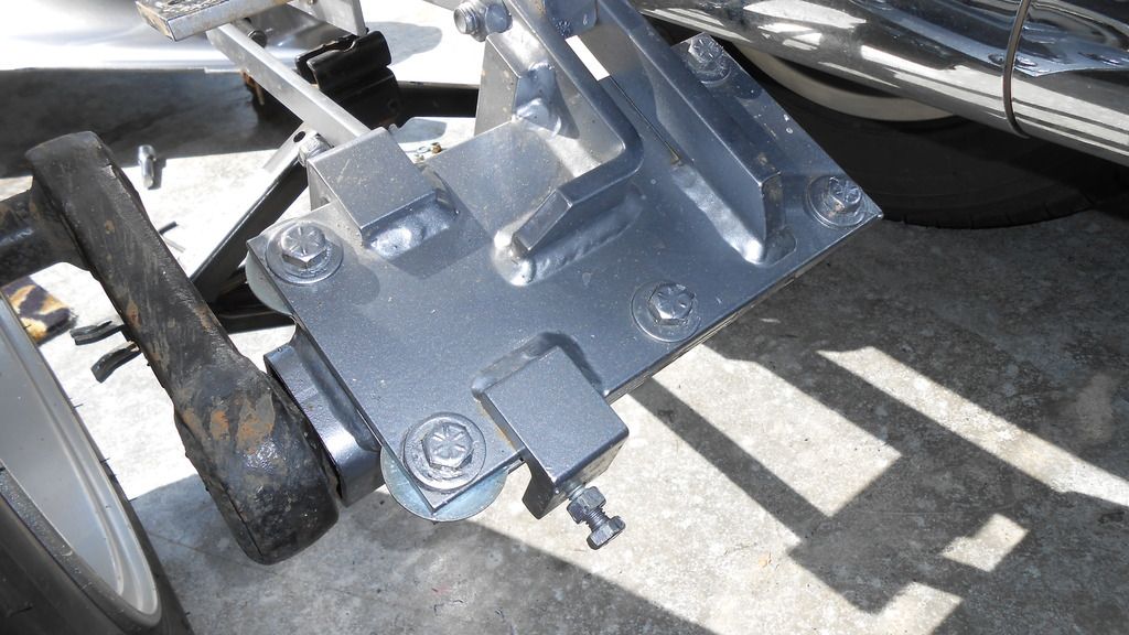

Hitch looks good John - looks plenty substantial to me... Not sure I understand what you mean about "wiggle room" between inner and outer framework???? Can you post photo of same???

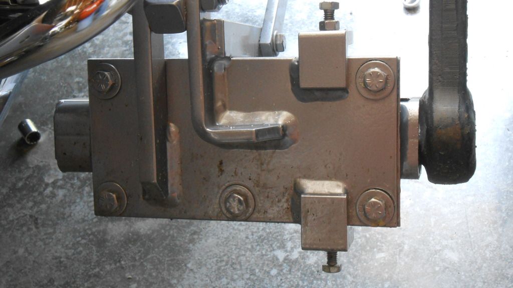

These are what my adjustment brackets look like - how do they compare to yours???
As you can see from the photo below, my lean stop brackets (L shaped brackets) are bolted to the welded brackets on the cart frame, so I have no adjustment there other than the height of the lean stop bracket which essentially adjusts rough wheel height...
Fine adjust for wheel height is accomplished by the adjustment screw on the back of the cart as shown in the photo below...
