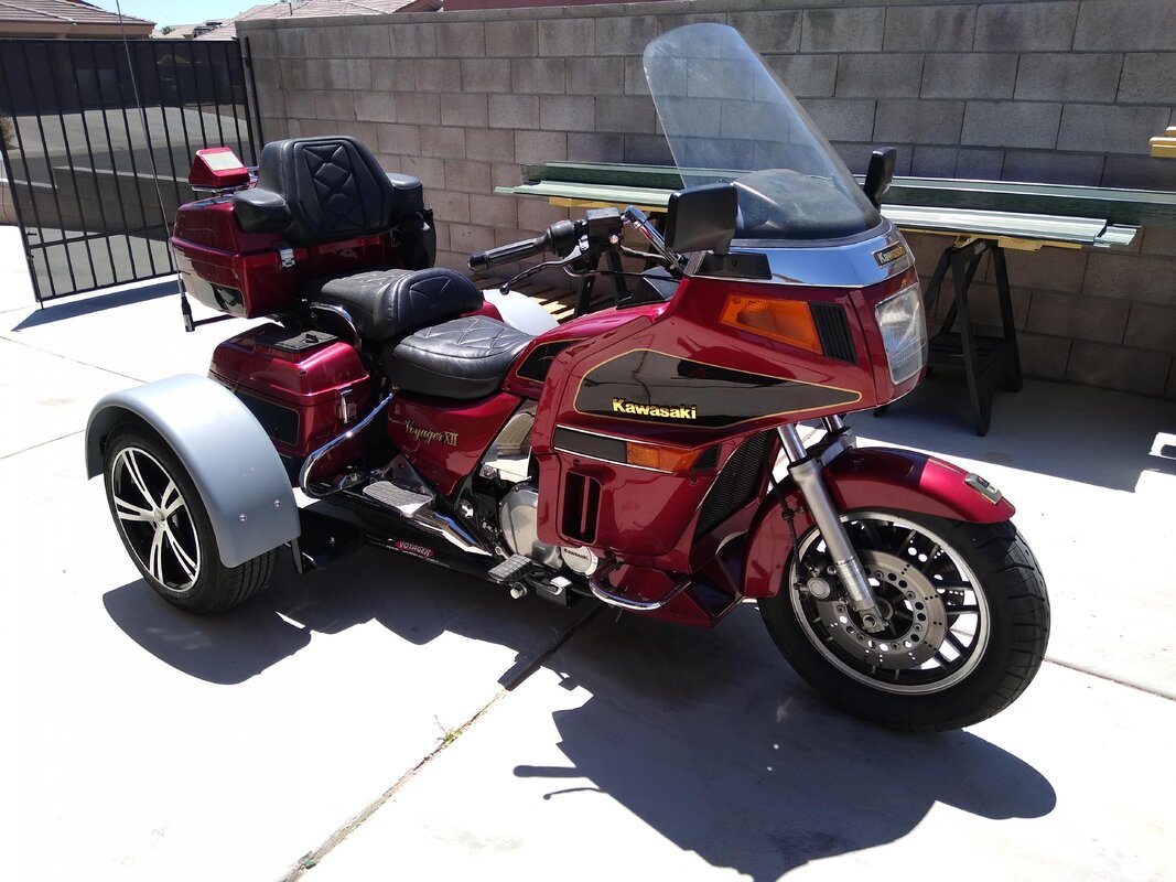

So I purchased a new Voyager kit with reverse. I like the quality of the kit, very robust and the welds are perfect. I’m hoping to post my results with this kit if there is any interest.
There's definitely an interest Jim, we always enjoy a build thread and pics.

So I received my Voyager kit. First I changed all fluids and brakes before installing the kit. Easy to install. I also ordered the reverse kit. The kit was very well made. It took about the same time to install the reverse as it did to install the Voyager kit. I installed it on a 97 Kawasaki Voyager. I guess I can say I now have a Voyager Voyager. Steering is hard as I expected. Something I guess for me to get used to. I’m running 1” of preload at this time and it seems about right. I’ve ordered the matching paint. I haven’t bought paint for awhile and wow the price of auto paint sure went up. Two pints of color and a quart of clear was $400. I’ll post pics when the paint work is done. Now to get used to this beast and not forget I have wheels sticking out on each side.
