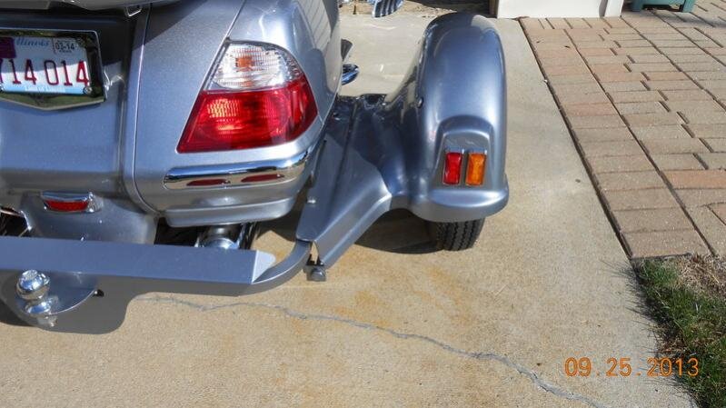

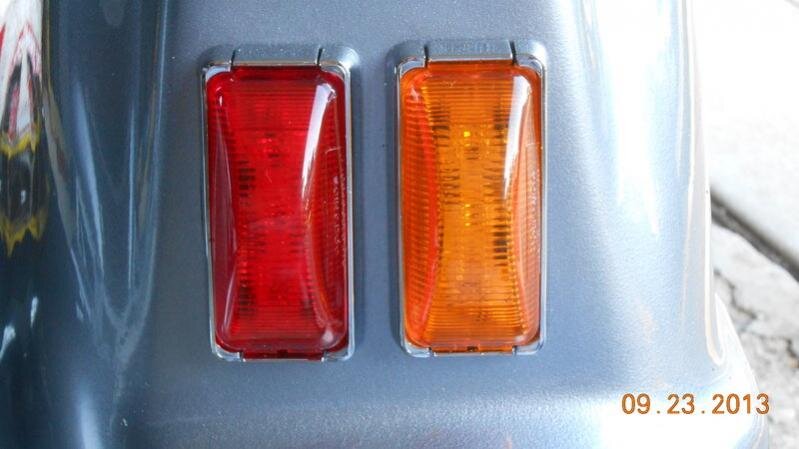

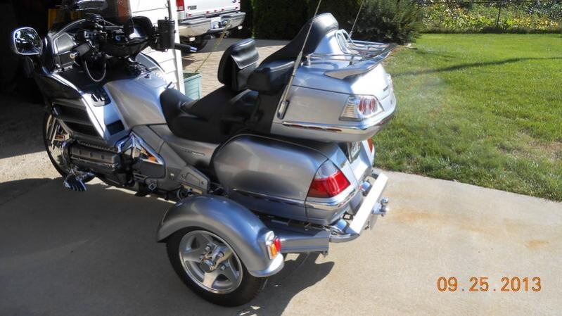

Well, I finally finished putting the trike back together after painting and I installed the LED lights as well... Here are a few photos of the finished produce and some wiring details... I used Panduit cable supports to hold the wiring - they have a very aggressive adhesive on them and should hold without issues...
There is also a link for a video I shot last night of the lighting action... Not the greatest video but it will give you an idea of how things are working... I developed a scheme to let me use the running lights as brake lights too using a few isolation diodes and a 470 ohm resistor... If your interested in that, let me know and I can post the schematic for that...

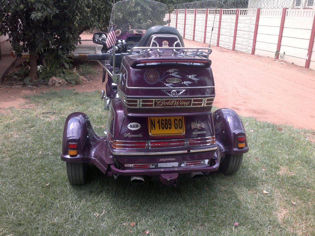

Ok. A little bit of myself. I bought a 95 Aspc in 2012 in Loxley AL. Done a 5000 mile tour which took us as far as rhe Rocky Mountains and ended up where we started. Afterwards I imported the bike to Namibia and did some extendd tours also through South Africa. Myself is 61 and me wife 64. Imported a Insta Trike kit from TowPac and are doing the last work on the installation. Problem is the tail lights on the kit. To find an integrated LED set seems to be impossible in my country. I am planning to use two marker truck lights one in amber and one in red. I saw your post about your setup and would like to have the drawing or scetch how you did the wiring on the tail brake light. Our time is seven hours ahead of yours.

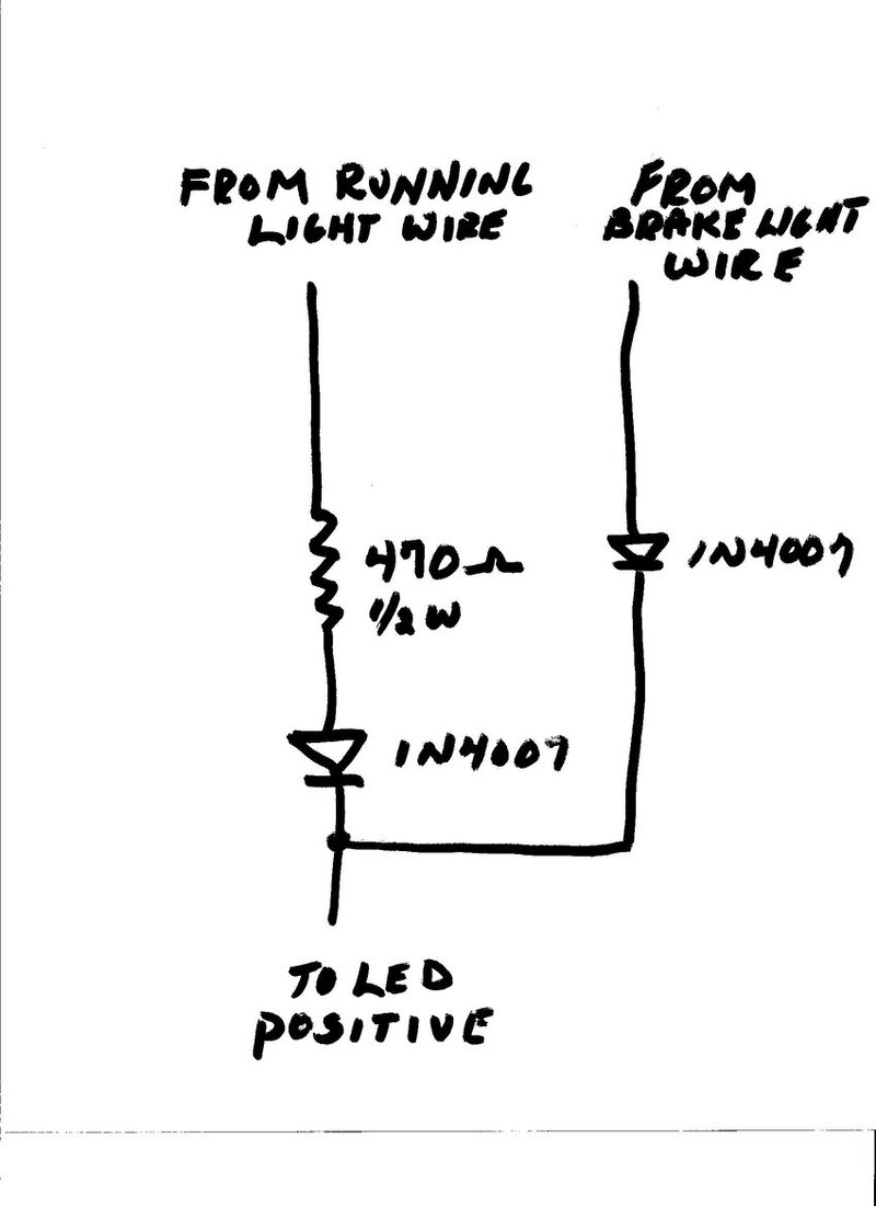

Below is the drawing for the brake light wiring... Note that the resistor value was for my particular light which used a total of 3 LED's in each lamp assembly... Should be close for yours since LED's are current activated devices... I used a 1/2 watt resistor, larger would be fine, don't think I would go any smaller than 1/2 watt though, more for physical soundness rather than electrical considerations...
In actual usage, voltage for the running light is supplied thru the 470 ohm resistor/1N4007 diode and the LED lamp is a bit dimmer due to decreased voltage/current thru the 470 ohm resistor and it's 1N4007 diode... When brake is applied, that slightly higher voltage from the brake light circuit is applied to the LED light thru the 1N4007 diode with NO resistor and that slightly higher voltage makes the LED lamp brighter... The 1N4007 diode in the brake light circuit serves to isolate the running light voltage from back feeding up into the brake light circuit as diodes will pass voltage in one direction only... This setup has been on my Tow Pac for nearly 2 years now and is functioning flawlessly...
I soldered up the components and put heat shrink tubing over them and tucked them into the Tow Pac wiring harness on the bike, but you could put them on the Tow Pac too - just depends on how convenient it is for you...
Let me know if you have any further questions...

Tx for the info.
Rita, my wife. Turned 64 on the 8 th. Happy bday to you. All I have to do now is to find a electronic shop to buy the goodies. The Gw has this fancy breaklight unit that flashes the stoplights before it stay on. Hope you understand as my homelanguage is Afrikaans. It sound and is very similar to Dutch.
Also the truck marker lights, though 12 V LED has very heavy gauge wires. Will that influence the resistor in any way
Do I have to be very concerned about wheels going out of alignment while on the road resulting in exessive tire wear. What method do you use to align the outrigger wheels to the bike rear wheel.
Will take her out this week for a test ride. Just something else. The downforce on the outrigger wheels. Must I be able to lift the wheel of the floor and be able to turn it by hand. This is what I understand from other posts.

Well, happy birthday to your wife too Willem, and I understand you just fine - no problems here with that...
The heavy wire going to the taillight might indicate that the LED's draw heavier current... Do you have a meter to measure??? If not, just hook up the light with the resistor and diode in circuit and see if either gets hot to the touch...
If they do, you might have to use a larger wattage resistor, like 1 or 2 watt rating... The extra current , if any, should not bother the diode assuming it is below the diode rating of 1 amp...

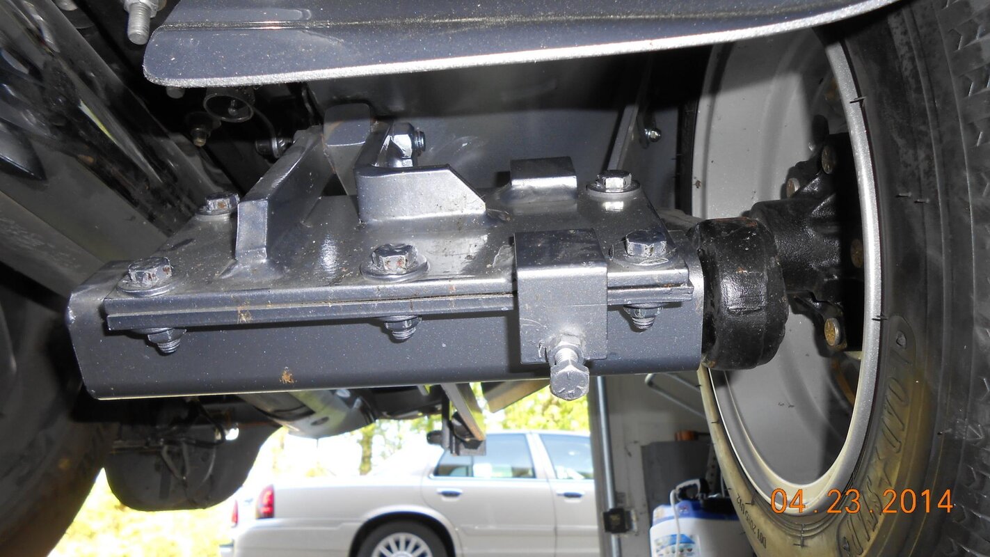

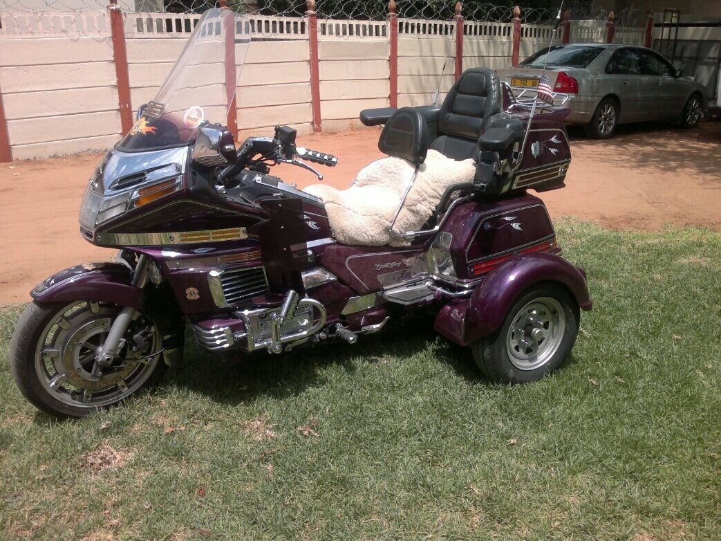

The tail lights are working perfectly. one thing though that bothers me. the ride is very harsh. it seems that I feel every stone on the road. I do have a CT on the rear but the tyre airpresure is not up to 40 yet.
Dadstoy and all who can. I notice that the kit has lots of places that can be adjusted. the manual and the instructions does not help in any way. The left outrigger wheel leaned in and was out by about 1 and a half inch. I emailed a q to towpac but have not recieved any responce. the troubleshooting guide just mention a shim.So I put a shim at the outside bolt where you adjust the tow-in which rectified the lean in.I am not sure if I shimmed at the right bolts.
Any help please..
Hi Willem, hey, the bike looks great with the Tow Pac - love the color!!! Wasn't that called Pearl Royal Magenta or is that a custom color???
OK - lets start with adjustments...
1 1/2" out sounds a little extreme to me - might want to check the sub-frame alignment to make sure everything is seated properly...
If the 1500 Tow Pac is like the 1800, the wheel alignment is handled by a rectangular plate on the independent suspension arm that looks like this...
Slightly loosening the 1/2" bolts should enable you to then use the set screws (2 long bolts with jam nuts) to move the trike wheels into a parallel position with the bike rear wheel...
Use the adjustment jig from a previous post to do that...
Camber, or the Tow Pac trike kits vertical wheel position, is pretty much fixed and as far as I know, there is no adjustment for that to my knowledge...
My trike wheels are just a bit tilted in at the top, but the tires are wearing pretty evenly at this point in time with about 5K miles or so currently on the Tow Pac kit...
As to the bike riding harshly, two questions come to mind... What tire pressure are you using in the Tow Pac tires, and what is your rear air suspension set to on the bike??? I run 40 PSI in my Tow Pac tires and could probably go down to 35 PSI although I have not tried that yet... 50 PSI as recommended by Tow Pac seems high to most of us and I think most Tow Pac owners are running 40PSI or lower...
Reducing air pressure on the bike's suspension, will preload the Tow Pac a bit more and put more weight on it's tires... Have you tried the "tugging on the trike tire" yet as I suggested previously??? If you can't move the trike tire, you have it preloaded too heavily...
Try increasing the air pressure in the bike's rear suspension... On my 1800, I run with the suspension at 5, although the 1800 suspension is a bit different than the 1500 as it employs no air bladder as the 1500 does, but rather varies tension on the rear suspension spring via a hydraulic actuator...
Additionally, what car tire are you using, and is it a run flat, or non-run flat??? I have a Yokohama Avid Envigor ZPS on mine and it is a run flat, and I run 32 PSI in it currently... If your using a run flat at 40 PSI, that is probably way too much pressure and will harshen the ride...
Let me know what your answers and we will go from there...
You will feel bumps and road irregularities a bit more with the trike as you have an asymmetrical setup now as opposed to only 2 wheels, so take that into consideration as well...
Les
Tx my friend
You have the colour right and it is still original.It has custom handpainted dreamcatchers and buffalo heads with Indian beads on, which has turned a couple of heads also in the US on our tour over there. I tried to contact one of the PO's. I think because we are in Africa it scares them off and got no response on a fb request.
I will love to make contact with the PO.
The kits differs a lot. One of my problems is definitly preload, which I wil adjust during the week.

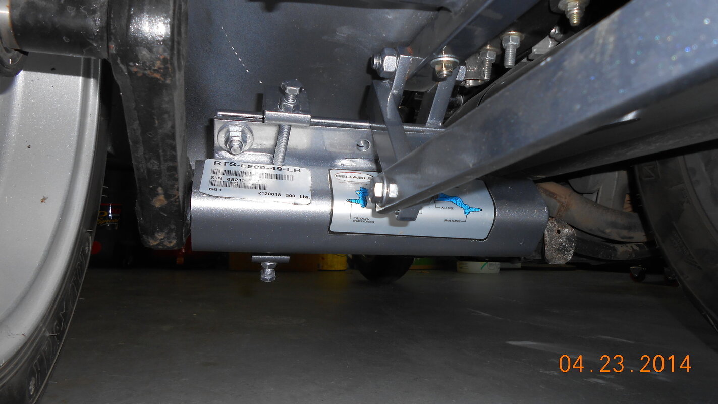

The sidewheels mounts with only 2 bolts to the frame. this is also the bolts you have to loosen to adjust the toe in, which I did and the wheels are parallel to the bike rear wheel.
In the troubleshooting manual they specify to shim if the wheels lean
sorry I posted the former post without finishing. Tp sugests you shim the axleplates. now I shimmed only the outside bolt which rectified my problem. I am now worried that both the bolts do not pull absolutely straight which might put unnecessary strain on the bolts and plates as the two plates does not ly flat against each other because of the shims.
