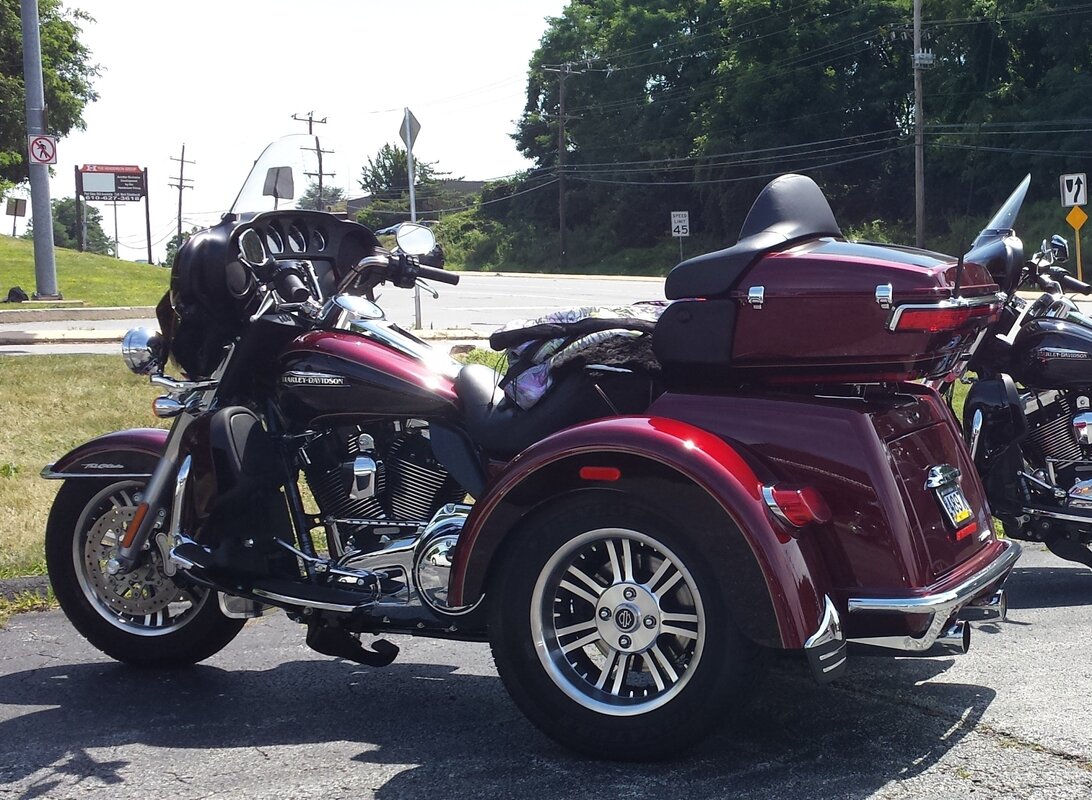

We love our 2014. We have 22k miles in 26 months. I de-catted my stock headers and added Nightrider FL-Vied-10s to richen it up. It's now no hotter than any previous HD I have owned. We love the Boom system and use it all the time for navigation and playing music off a memory stick. Go find a good deal on a leftover 2016.
