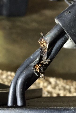

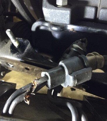

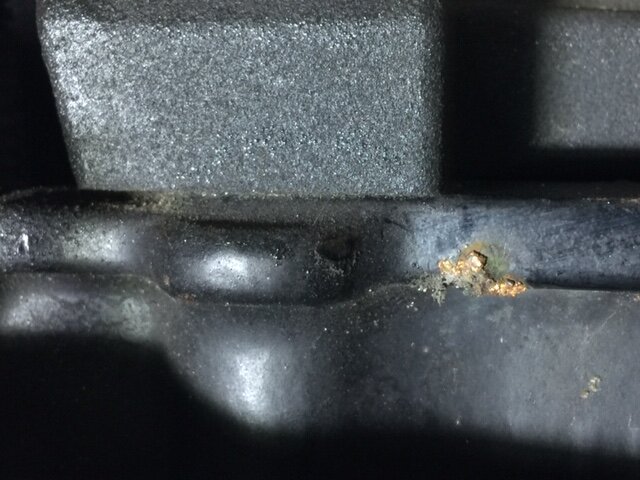

This past Sunday I was checking the bike over and found this IMG_1932.JPGIMG_1935.JPGIMG_1934.JPG
The wire had been sitting against the motor for who knows how long with heat, friction etc, finally allowing bare wiring to contact the motor block. I have no idea for how long this has been going on but all systems on the bike are working well but this is a failure/breakdown waiting to happen.

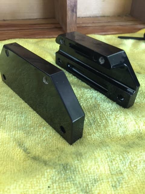

I took pic's of the unit CE-608 thinking i'll post them up along with how it looks installed but it wouldn't fit correctly, so I called lowbrowcustoms and they have a motorcycle tech support dept and I spoke with Todd. Try as he may he couldn't answer my question but what he did do is give me the number for Cycle Electric and the names of the 2 guys I could possibly speak with. (thumbs up)
So I spoke with Carl at C.E. and he was a huge help. He explained that the frame on out Tri-glides are a little different and that the cross member above the oil cooler that the voltage regulator attaches to is solid soooo I need an adaptor which pushes the regulator foward off and away from the oil lines, etc. He shipped on out to me Friday.

Installing the CE-608TG voltage regulator

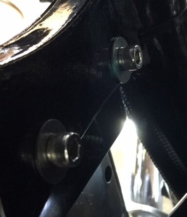

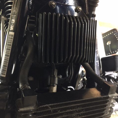

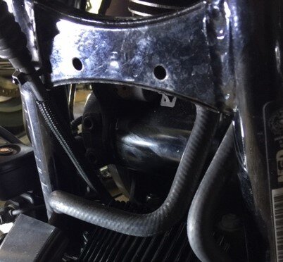

This pic 0.jpg shows the 2 adaptors. The one on the right is the one that comes already mounted on the regulator made to fit the crossmembers that are concave. The left one mounts to the front of the solid TG crossmember IMG_1973.JPG . I had to remove the old adaptor and attach the new one to the regulator. I made a trip to ACE hardware for SS Allen/socket head screws (1/4-20 x 1 1/2")and 2 SS washersIMG_1977.JPG . The 1 1/2" length allowed enough threads on the front to use the old nuts .
After attaching the new regulator to the crossmember all that was left is plugging the connectors back together and reattaching the oil cooler.IMG_1978.JPG
Easy to install high quality product. It was a hassle to not have the correct length installation screws in the kit. The correct pruduct # is CE-608TG. If your in the market for a new regulator I would suggest you contact the retailer your considering purchasing from and make sure they have the correct model available. Carl from C.E. made it sound like the TG update to the item number might not have gone out to all retailers.
