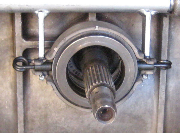

Now I have a howling noise every time I push in the clutch. It just started the other day.
It does not howl when the clutch is ingaged
It sounds like when I have had a wheel bearing go out on other cars
I think it is the new throw out bearing.
I will have to pull the engine and look at it soon

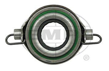

I ordered one but it is a little different then the last one I put in
It has a rounded mating surface like this one
The last one had a flat surface like this
Can I use this or do I need to order a different bearing?????
The flat one used to be considered the good one.
The stamped round face was considered the cheepo.
The last one I got was advertised as a good hd one for the high pressure clutches. It came in as a round face. Used it anyway. Seems to be ok.

This is the type of bearing that is in there now
I ordered the same but got one in that has a rounded surface
Well that picture is the style that goes to the pressure plate with what looks like a big washer on it. The rounded ones I always thought went directly on the clutch fingers. And that style needs the snout to keep it centered. Of course I've been wrong before.

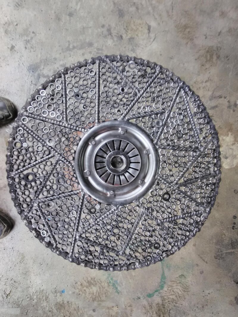

my pressure plate does have the "big washer" on it
I made my old clutch (from a previous replacement) into a table but you can still see what it was

Ok just wanted to be sure you knew. Can't help with parts, there are no quality parts far as I know. I had a brand new chinese bearing make noise immediately, took it out cut it apart. Wow no grease at all nothin and thats probably 20 years ago. You would think they would've gotten better over the years but apparently not.
Appletree auto has a youtube video on the different styles of clutch. I don't how to link to it. But if you search youtube for appletree clutch id it should come up. The throw out bearing you show in your link is the late model with the sleeve, it won't work with your pressure plate. John at aircooled is very knowledgeable give him a call and ask him what you need.
