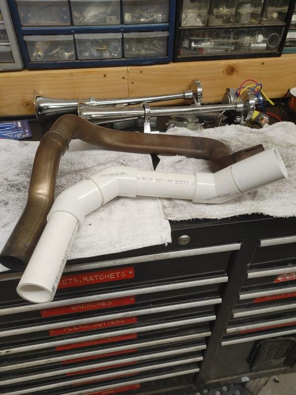

When I changed to an IRS rear end I made a new crossover pipe with less bends and no flattened section like the OEM pipe. The problem I had was finding a muffler shop that had the small diameter pipe. I ended up at an auto parts store that carried premade muffler pipe pieces. I found a straight piece that had a bell on one end and a pre-bent 90* with a bell on one end. I took these to the muffler and they were able to make what I needed. I also made a mockup of what I needed out of PVC joints so that the muffler shop could use it to copy from.
Here is a photo of the OEM pipe and my mockup

The OEM pipe is 31" in total length with 7 bends and a section that is flattened which is 10" long and only 1" OD. The new pipe that I had made is the same length with 2 bends and maintains it's round shape the entire length of the pipe.

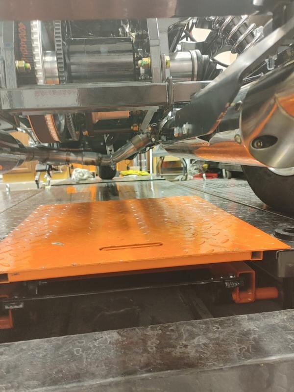

On the mockup I couldn't find a 90* sweep so I used 2 45* couplers, when I had the pipe made it has a 90* not 2 45* bends. I didn't take a photo of the new pipe but I do have one of it installed.
