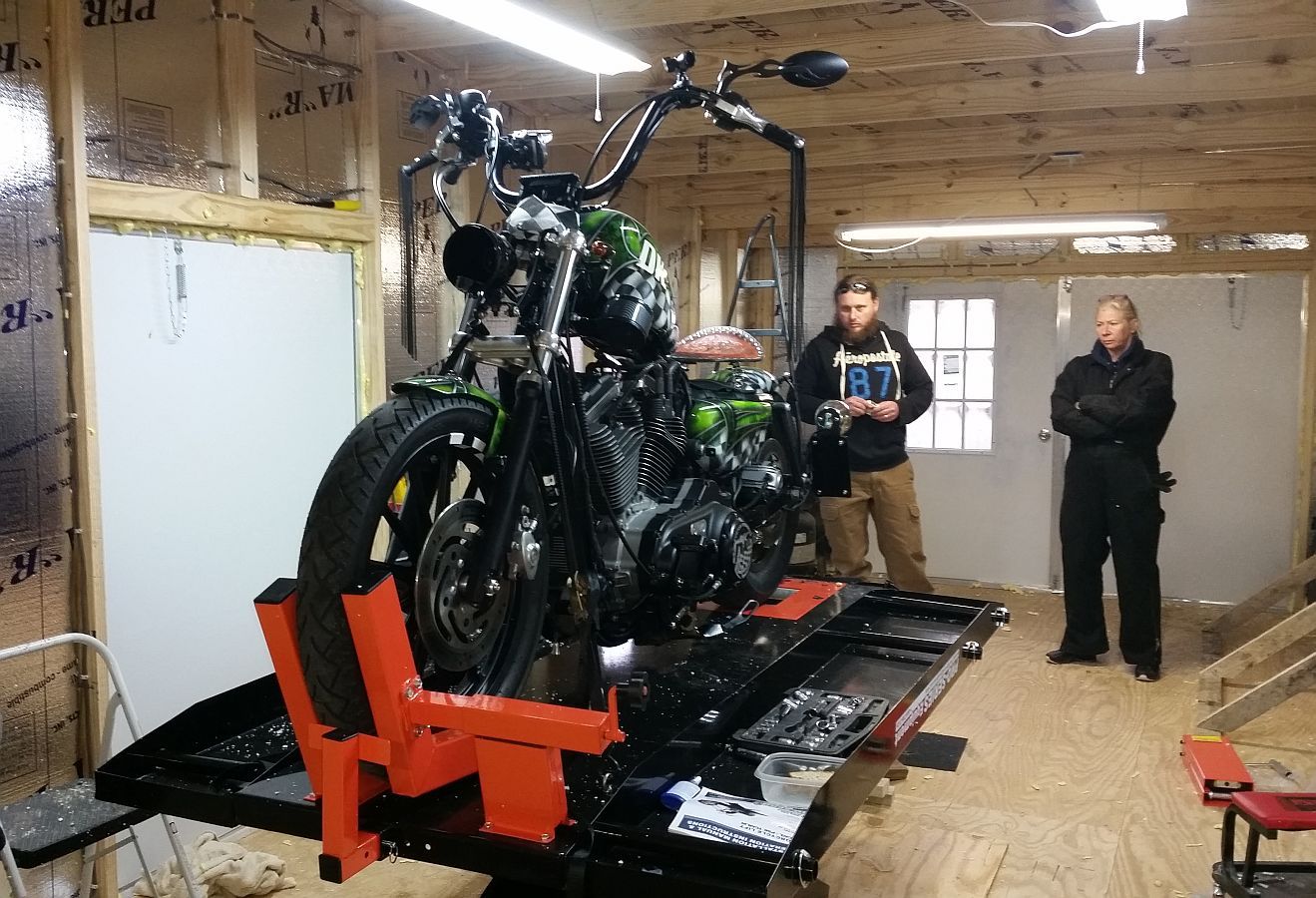

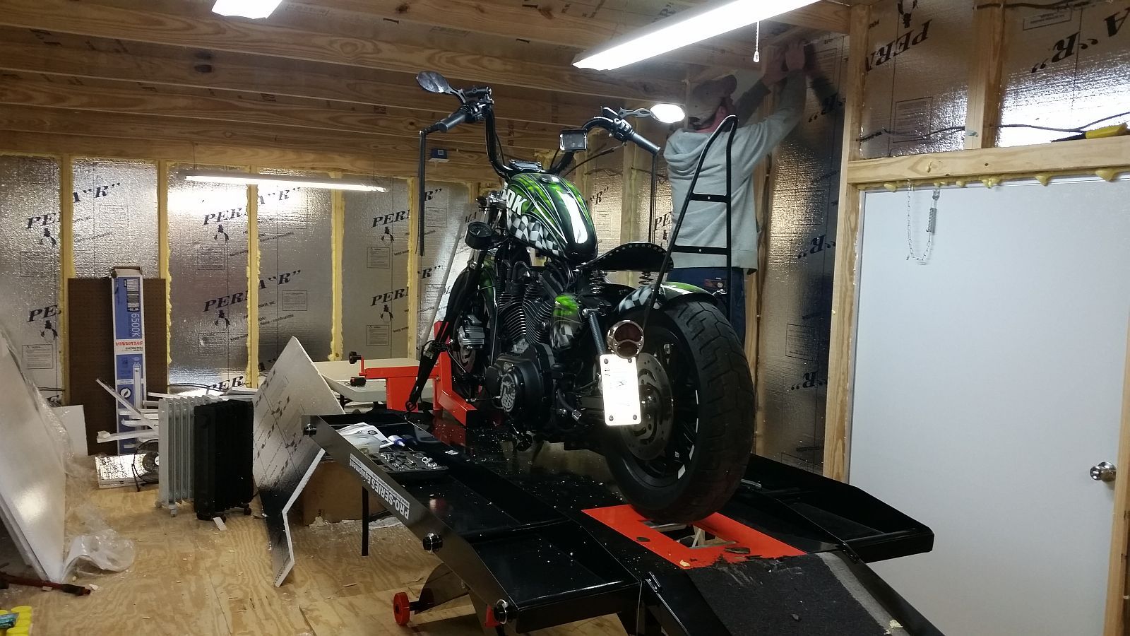

Ran out of room at the shop for building bikes, so we are setting up a new building (metal shed) with a lift.
Sporty was the first bike to go on the new lift. But I will post a couple more pics as soon as we get the Tri-Glide on it in the next few days.
Mark is still installing the insulation as we are testing out the new lift. :)

Upside down manufacturers name on lift??? :xzqxz:
Did you do this on purpose so you have parts trays instead of flat area???

What brand lift is that? Been looking at all the lifts out there, and trying to find the most economical.These lifts for trikes are expensive.
My curiosity is getting the best of me!
Bob :Dorag:
It is a Pro-Series Equipment Lift Table
http://www.proseriesequipment.com/products/auto-lifts/motorcycle-lifts/pse-tcmlw.php
Yes, the side extensions can be turned upside down, like in the picture, for a tool/parts tray, or turned right side up for the wheels on a Trike.

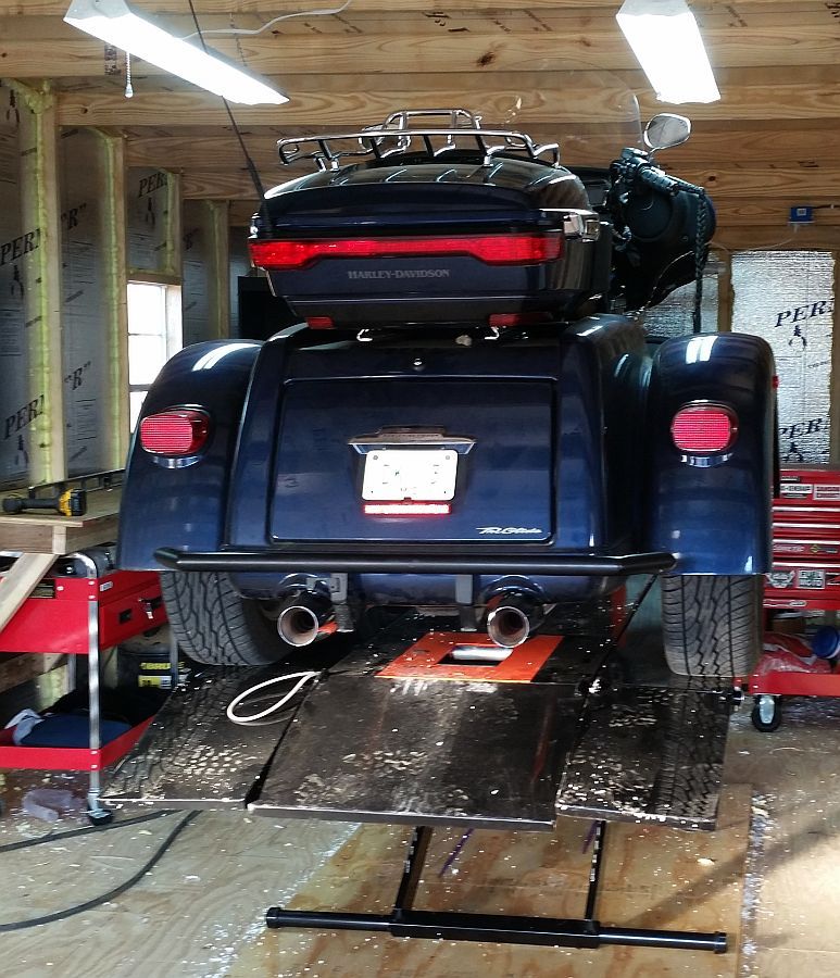

Here are a few pics from this weekend-

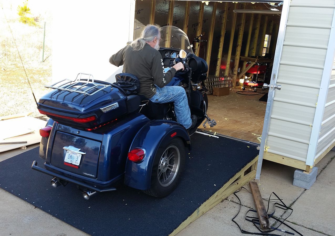

Pulling the TG in for the first time-
Up onto the lift ramp-

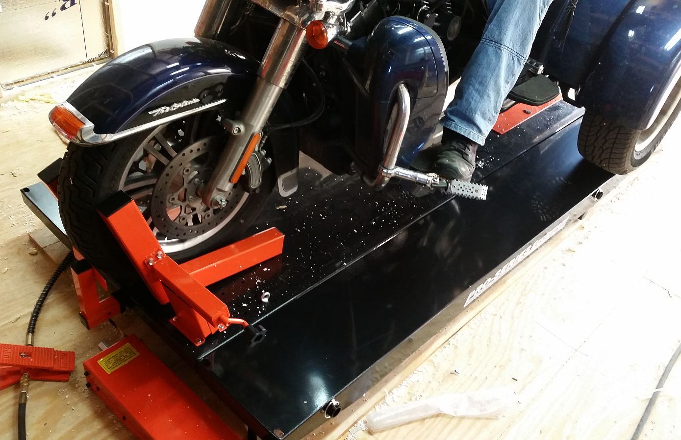

Locking it down-
Up it goes... wow, it is really dirty, poor TG needs a wash -
All three bikes will fit in there, with another on the lift with enough room to work. :)
Well Kevin, what do you think about the lift for the TriGlide :Shrug: is it a good fit :Shrug: how about the power to lift the TriGlide, I noticed it was rated for 1000 lbs :Shrug: in your honest opinion, does it do the job safely :Shrug: Thank you for your support, ThumbUp
According to the link the lift is rated at 1500. I think it comes with a service jack rated at 1000. Looking at the rear of lift with the tri on it looks like the extensions are pushed down or maybe it's the photo. How's it seem the with tri on it? Steady?
Yes, the lift is rated for 1500 and the frame jack for 1000. Power to lift is great, it goes right up with the TG at a good pace...just as fast as it did with the Sporty.
As far as fit- Length is fine, and it has an extended wheel brace, so it can work even for long front ends, but the standard is plenty long enough for the TG. It is a 48" wide table, which is standard width, but as you see a bit of the rear tires do hang off the sides just a bit. Not an issue.
We've only put the Sporty and the TG up on the lift. We have not actually worked on a bike while on the lift yet.

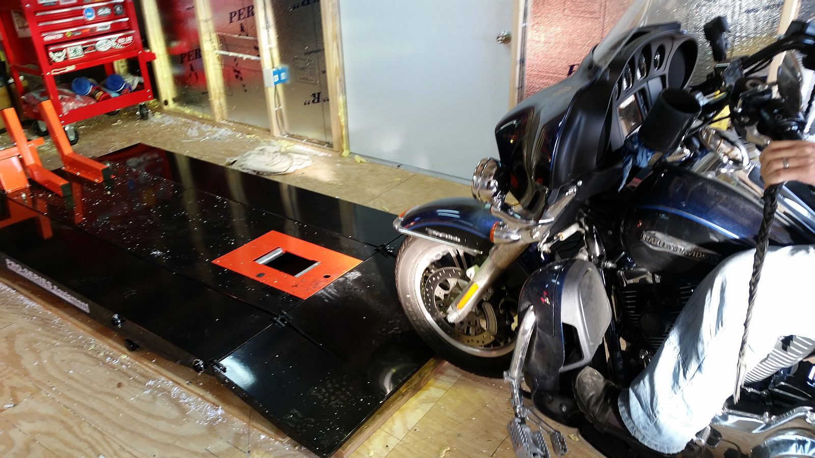

The ramps just slip in, and are meant to be removed after the bike is on the table. I did not do that. But while riding up they did not shift...that was solid.
Up in the air, at the highest stop (38" I think) it is NOT as steady as I would like. But I have worked with other lifts that were more expensive that were even less steady. The main functional issue is, will it collapse. I do not believe it will. However, it is just nicer to have something that is rock solid (no movement when you push it side to side)...but those generally cost 4-5 times as much.
I am not planning on sending it back, but, I can't recommend it right now either. Give us a couple of months working with it.
I can say this, if we were making them, we would have used heavier gauge steel in many of the components. But we have a strong ethic to over-engineer.
Thanks Kevin, keep us posted. And more pics when you can. :wave4:
Will do. Yesterday we worked on a Sporty for about 3 hours that was lifted almost all the way. There are 7 stops and we were on the 5th one.
After working on it for 3 hours, we both realized we had not thought once about the table, that we were completely comfortable with how stable it was.
Of course, a Sporty does not weight what a TG does. As soon as we get the TG back on it, and spend some time working, will share my impressions.

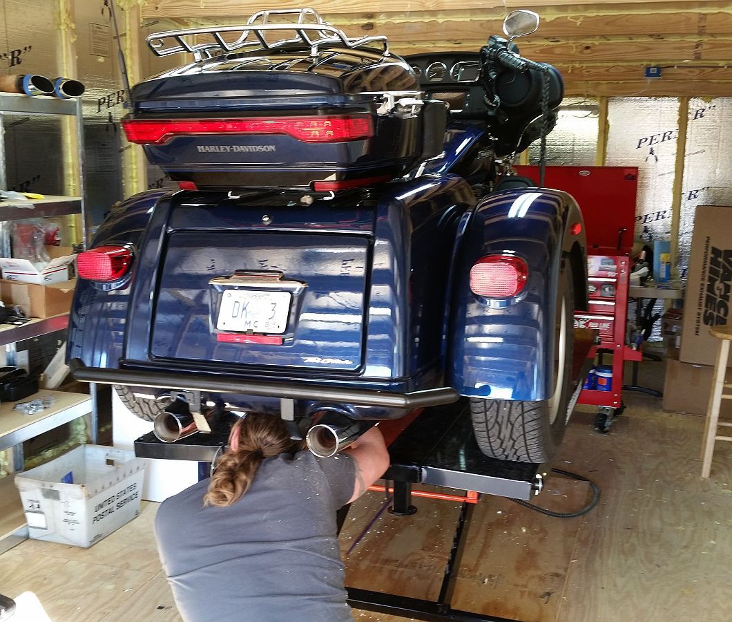

We got the TG back on the lift yesterday...worked on it for several hours yesterday, and again for several hours today.

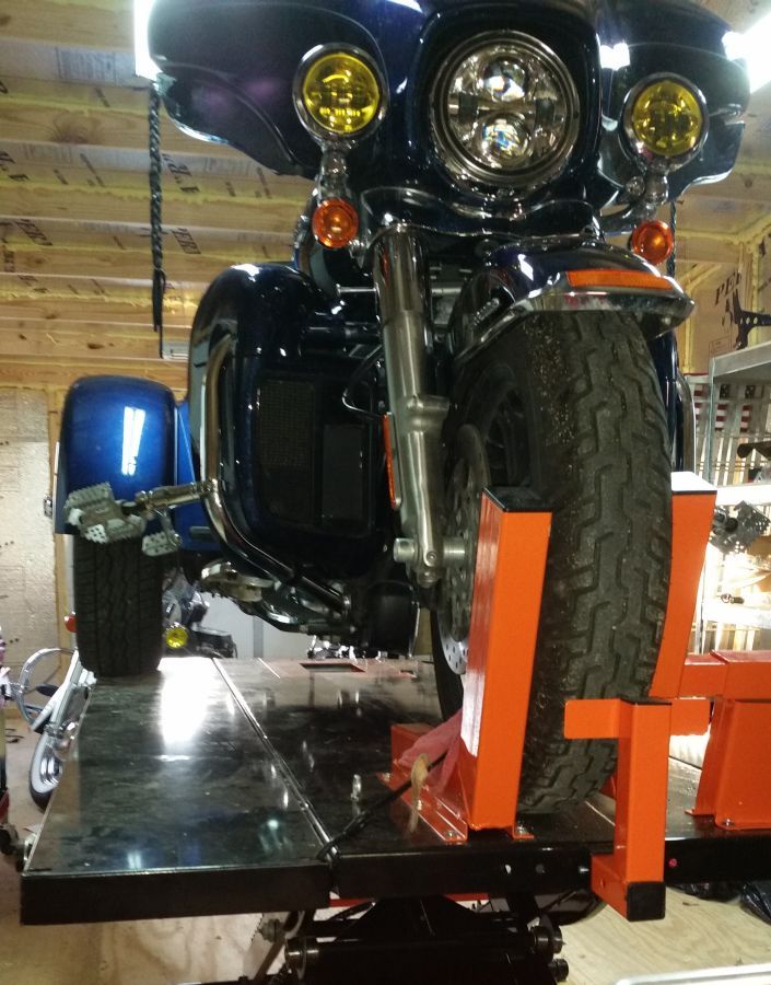

Here's a pic with it at the 6th out of 7 height lock out positions-
Great news is that once we got it up and working on it, we did not have a second thought about it's stability.
Another pic-
You can see that the extensions are tilted out a bit from the weight. This is not because anything bent, but because the holes in the extensions are a bit larger in diameter than the shafts they are sitting on. Tacky, yes, the best workmanship, nope, but it was solid and got the job done.
One of the things we were working on required us to remove the left rear wheel. We used the jack that came with the lift and, once we loosened the lug nuts and double secured the front wheel with a strap, we jacked the rear wheels off the lift and pulled the left wheel of the trike.
I completely forgot to get any pics of that! :( But everything worked well, as it should. During yesterday and today we must have lowered it and raised 5-6 times as we were working on different parts of the TG, zero issues.
