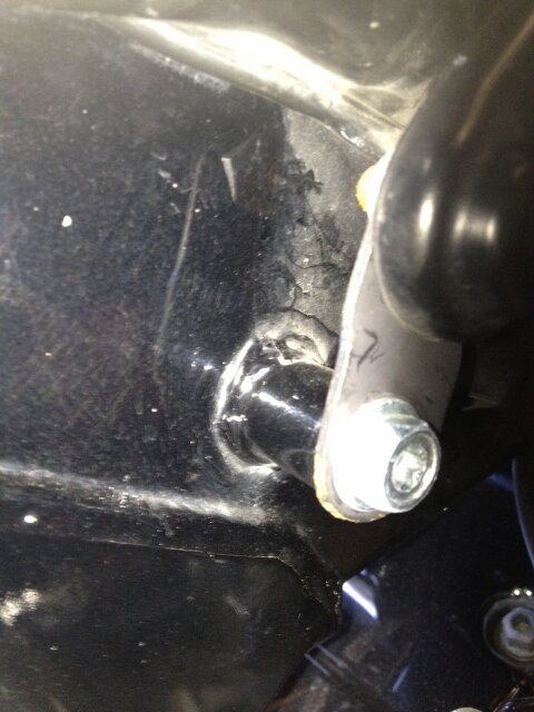

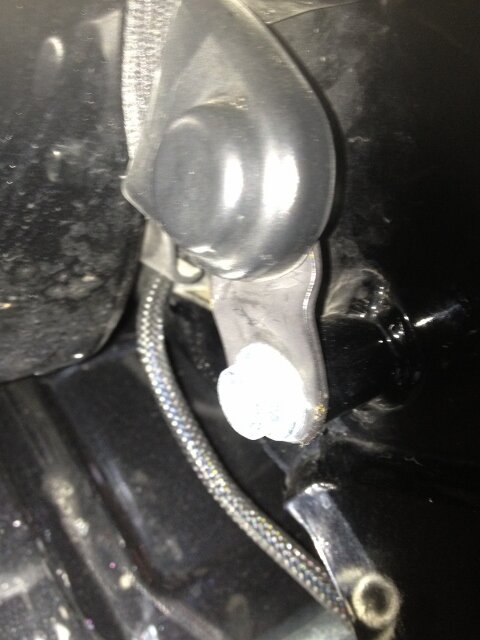

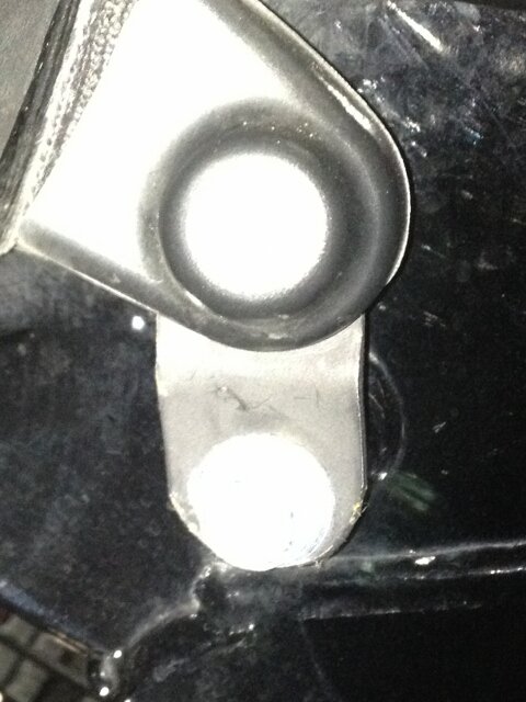

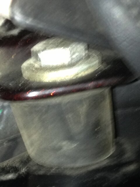

I installed one on on my TG last Spring. Very easy to install and looks good.:D I made my own by using a 3/4" hard rubber bushing from lowes on the rear of the tank and making a 1 1/2" link for the front from a pice of aluminum that I had in the shop.
It makes it a lot easier to clean the rear cylinder and by theory it should cool things down a lot.

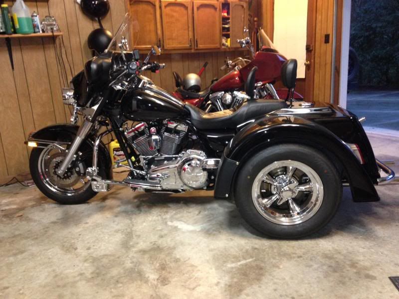

Just installed a 1 1/2 inch kit with rear deluxe option last night. High as I dared go with my bars. Subtle, but very nice change/look with the mild lift. Got out for a ride and I thought the bike "felt" better under me. Probably because I am 6'5 and the tank was in a better position between my long legs. BTW its a Gladiator kit on a FLH Police, but maybe the pic helps.
