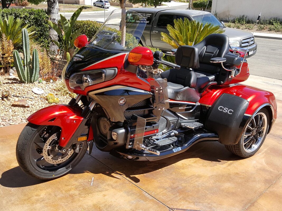

Theres a new style and a older style. When I had my trike built the guy told me that he installs the old style. Reason they snap on fender and do not go under the ground effects. Now I can easily remove for cleaning and waxing. The way you tell them apart is the lettering on them. The new ones look like this " cSc, the older ones " CSC letters all the same style. You can see their cut to go around the ground effects. Also they come with a soft felt under them. If you just keep the paint waxed, I have not noticed any scuff marks on the paint. I also bought a bra and same thing no scuff marks, just keep it waxed....
Here is a pic of mine....old style:
