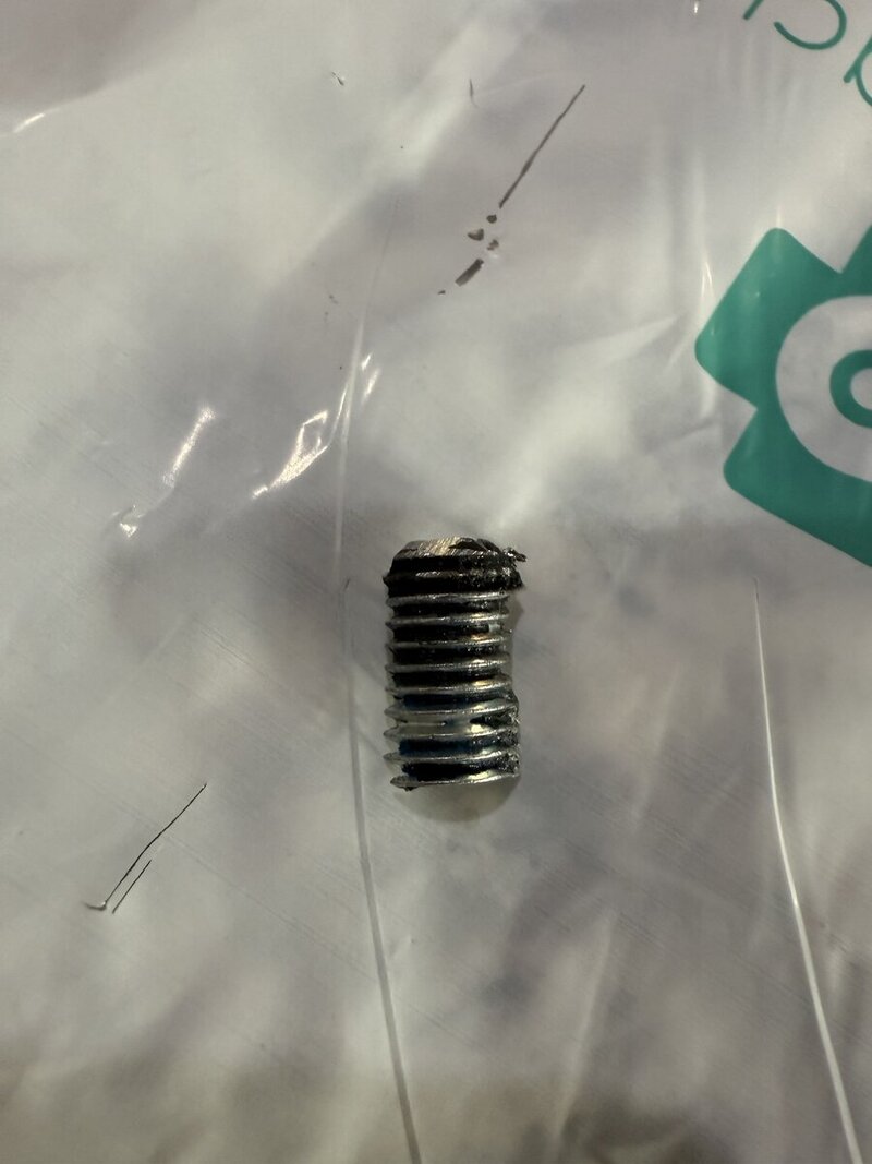

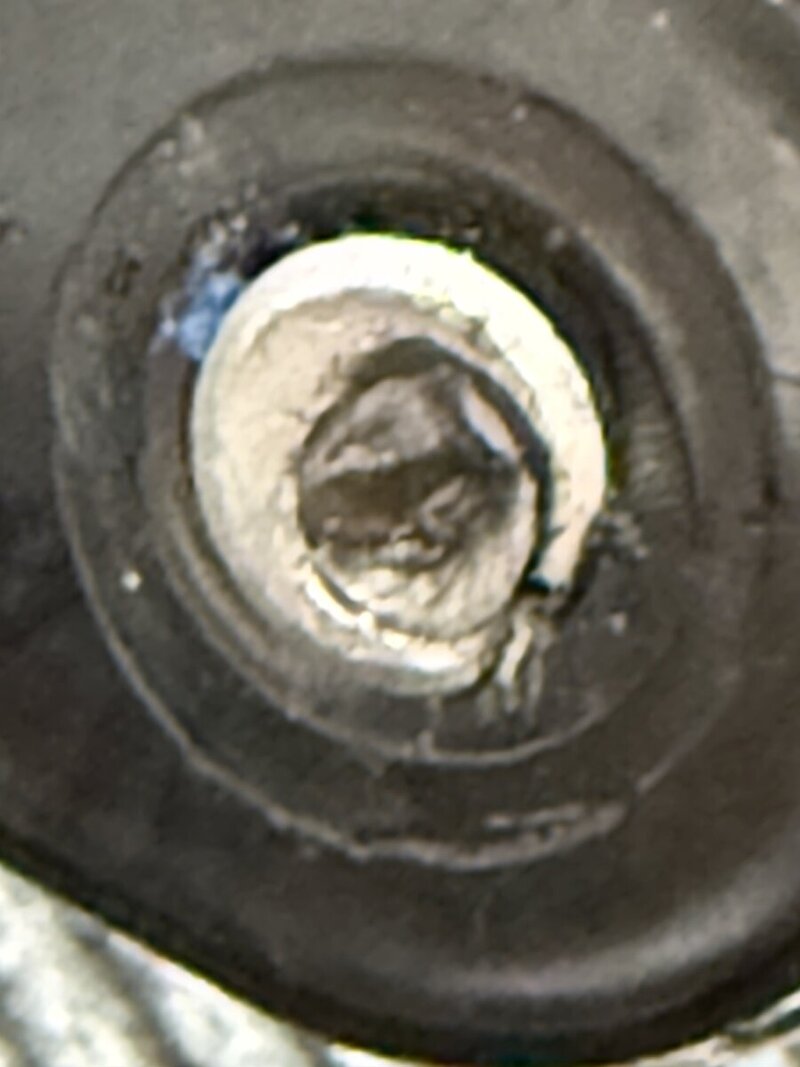

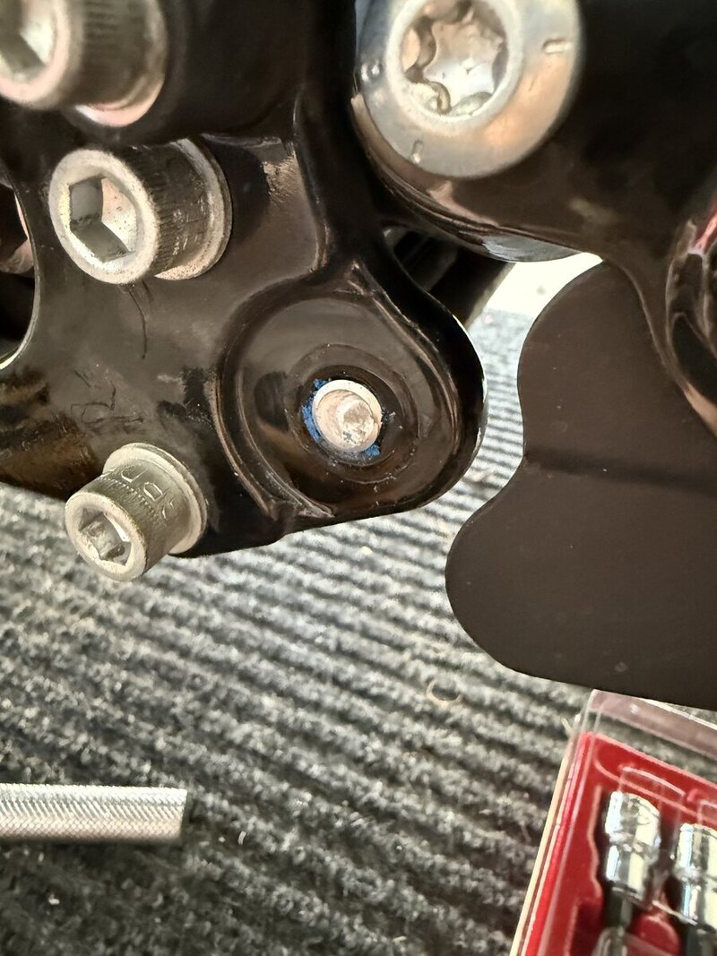

I was adding the DK floorboard extensions and the right front bolt head stripped. I thought no biggie, got out my handy dandy extractors…. And the bolt snapped off.
I thought ok I’ll drill the bolt and back it out with an extractor… the extractor snapped in the bolt.

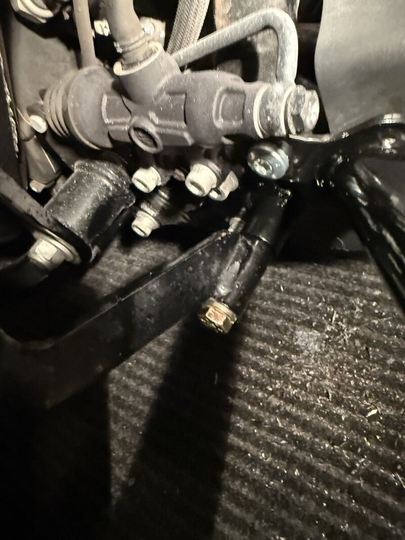

Well after several hours with a dremel and carbide bit I removed the extractor. I drilled out the hole with a 5/8 bit and had to through bolt the mount with a 4” grade 8 bolt and nut until I can see about putting a helicoil in. IMG_2799.jpeg
Looks like the old bolt was maybe cross threaded. Looked like only blue loctite.
What a day!

When its broken off flush like that the heater doesnt do much. Other than drilling you could set a nut up against it and weld it in the center . Sometimes that frees the bolt enuff with the heat to remove it.

Well after several hours with a dremel and carbide bit I removed the extractor. I drilled out the hole with a 5/8 bit and had to through bolt the mount with a 4” grade 8 bolt and nut until I can see about putting a helicoil in. View attachment 134278
